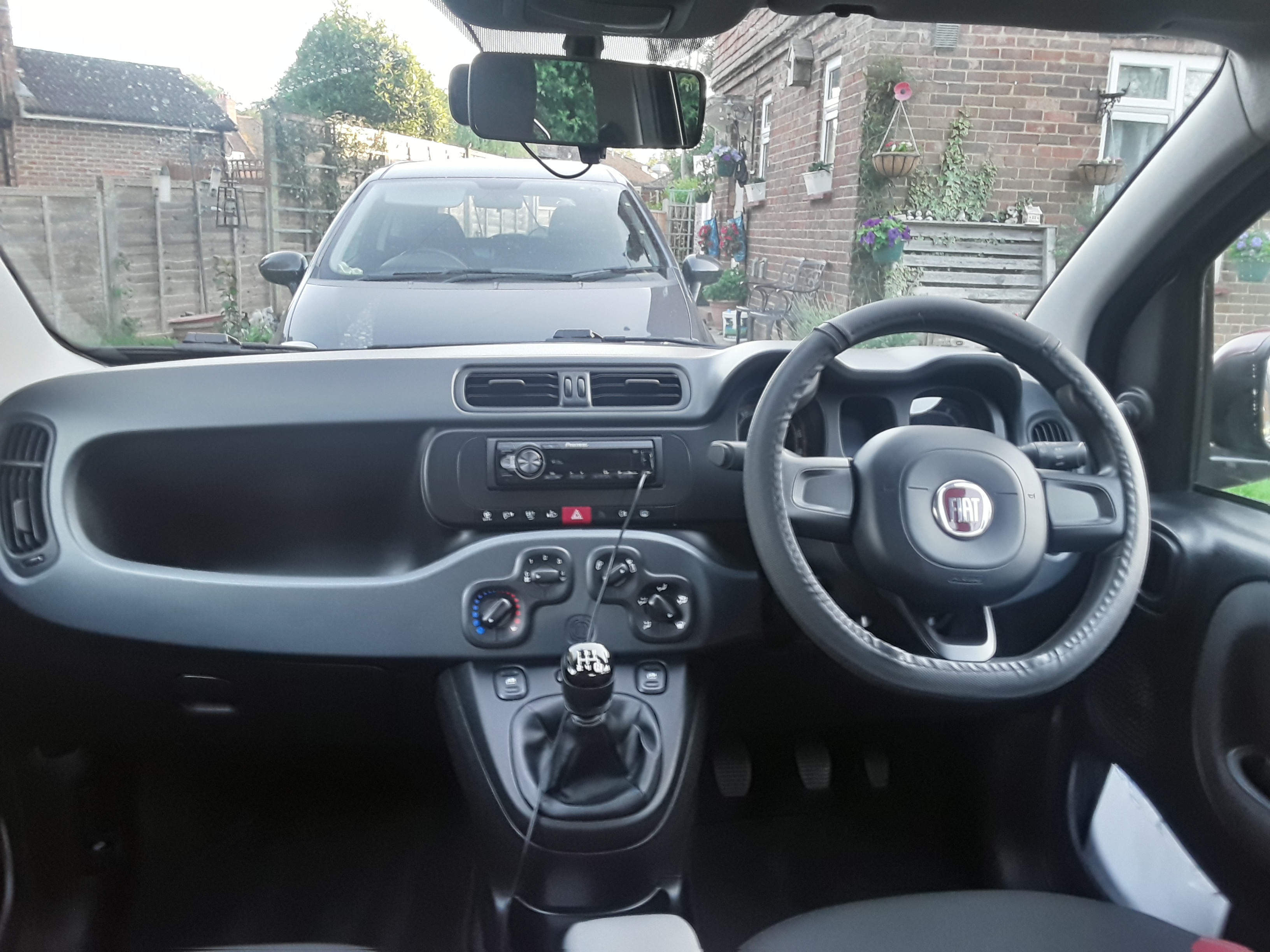

At the beginning of the year I replaced the factory headunit in my 2018 Panda Pop with a Pioneer DAB stereo with no CD player as I don't own any CD's, the unit itself was quite cheap at £70 delivered & by the time the other parts needed were added such as the fascia adapter which for this model Panda there are 3 types, dark grey for Pop & Easy, gloss black for the Lounge & silver for the Cross/4x4 models, the canbus wiring adapter, aerial adapter, DAB aerial, radio removal keys which I used Vauxhall double din keys as there are non for the Panda it cost me about £150 by the time I was finished. It is a huge improvement compared to the standard unit, although the standard speakers are ok with the Pioneer unit there is room for improvement so I do plan to upgrade them eventually with speakers of the same size but just better quality
This is the most recent picture of my interior with the DAB unit in place taken about 2 months ago, as my Panda is a Pop model it has the dark grey fascia
At the beginning of the year I replaced the factory headunit in my 2018 Panda Pop with a Pioneer DAB stereo with no CD player as I don't own any CD's, the unit itself was quite cheap at £70 delivered & by the time the other parts needed were added such as the fascia adapter which for this model Panda there are 3 types, dark grey for Pop & Easy, gloss black for the Lounge & silver for the Cross/4x4 models, the canbus wiring adapter, aerial adapter, DAB aerial, radio removal keys which I used Vauxhall double din keys as there are non for the Panda it cost me about £150 by the time I was finished. It is a huge improvement compared to the standard unit, although the standard speakers are ok with the Pioneer unit there is room for improvement so I do plan to upgrade them eventually with speakers of the same size but just better qualityView attachment 410628 This is the most recent picture of my interior with the DAB unit in place taken about 2 months ago, as my Panda is a Pop model it has the dark grey fascia

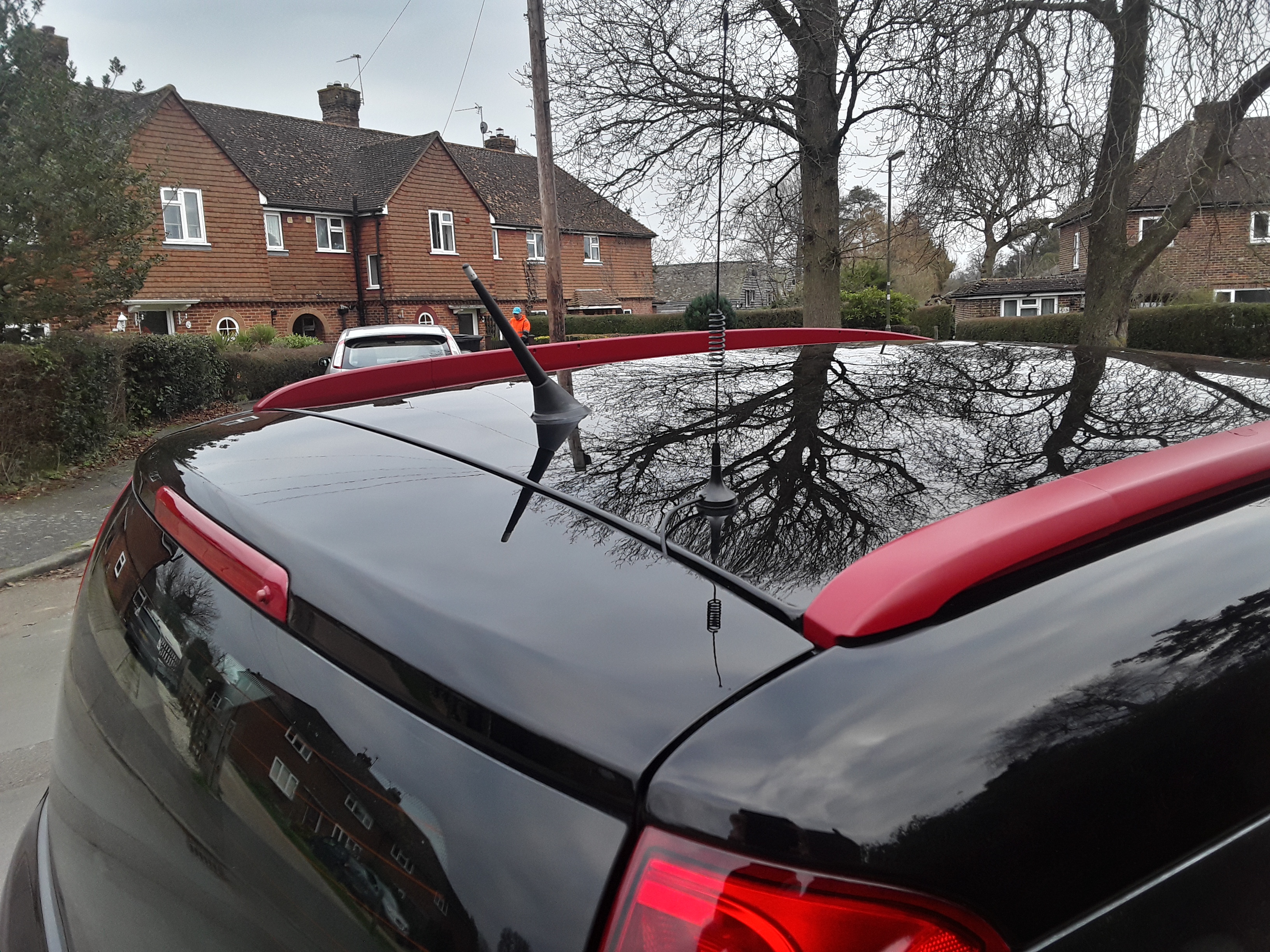

I brought a roof mounted magnetic DAB aerial from Halfords which is 5 metres long, it was routed through the boot tucked in between the C pillar trim & headliner then goes down & tucked in under the base of the rear seat then it's tucked under the centre console from the back to the front & up round the back of the dash into the stereo housing compartment via a small gap in the corner which was a bit tedious, all neat & out of the way. Although the other day the base of the aerial & the magnet that attaches it to the roof decided to part ways but the aerial still works even though it's currently dangling in the boot so I'm just going to put it somewhere inside the car probably by the small side window in the rear
