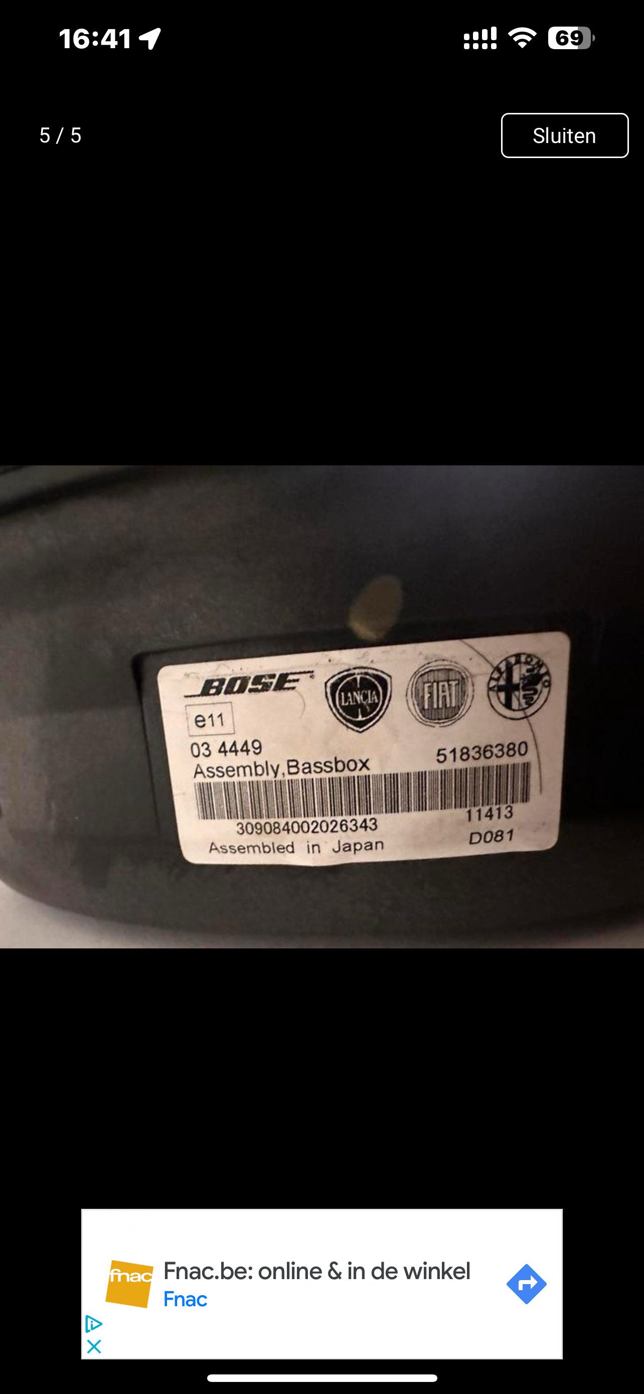

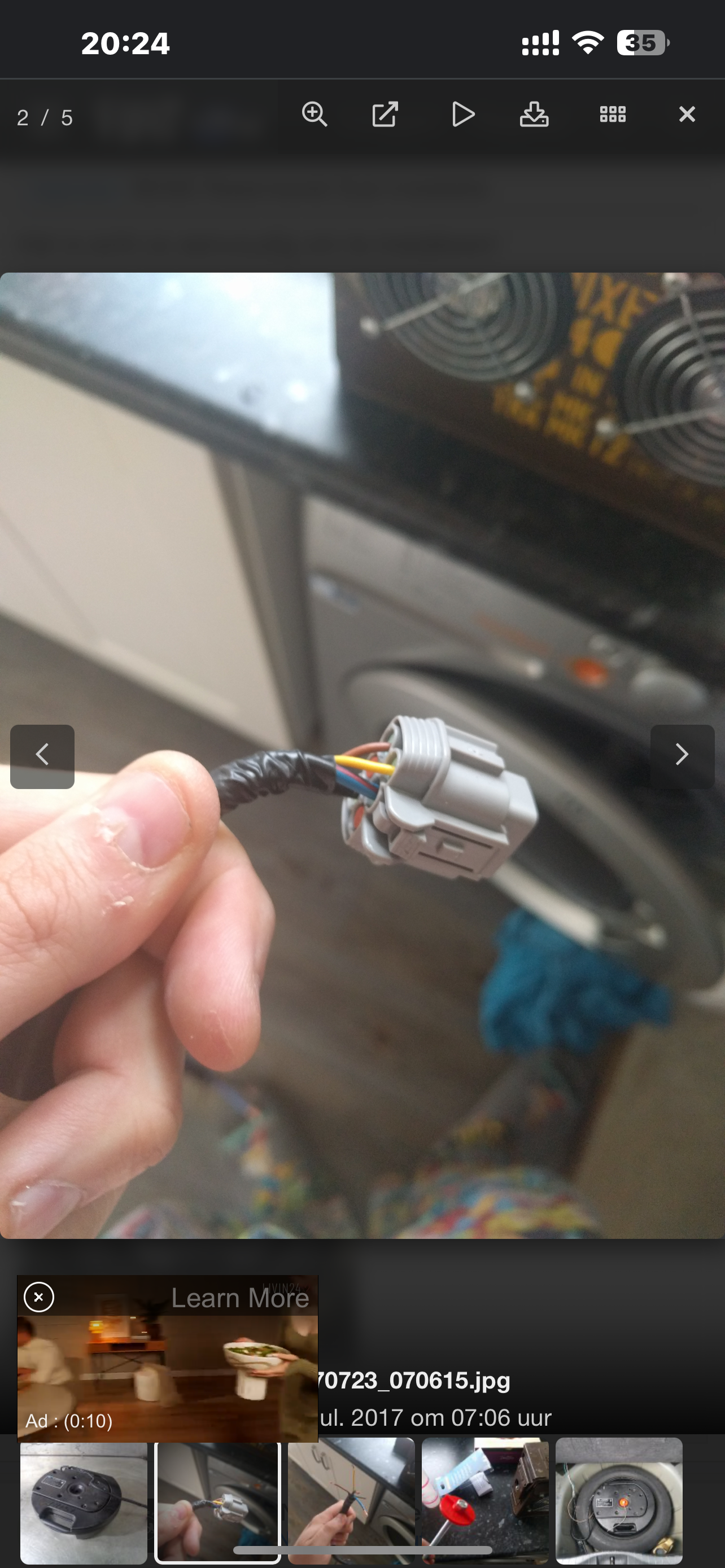

ik heb een bose bassbox gekocht maar er zat geen kabel bij. Kan iemand mij helpen waar ik een connectorkabel kan kopen hiervoor ? Welk type connector is het bijvoorbeeld.

Hello,
I'm afraid I can not get your post 100% correctly, as I don't believe in those browsers translations.
Looking at the diagrams of the models which have the 51836380 woofer it looks like the woofer was the part of the option 'hifi system', code 718, and was not sold as a separate option. It could be that it won't work without other elements of the system (amplifier, radio, etc).
There are several models with that option available (3x Mito, 2x Giulietta, 2x Delta), some of them are available in 3 or 5 doors, which makes the search much more complicated, as they have / can have other wiring.
What is the model and year of the car you own?
There are diagrams with connectors, but it's hard to look through all of them.

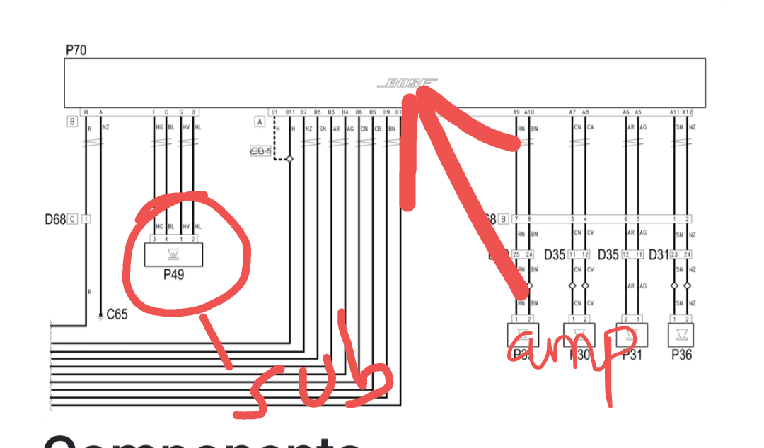

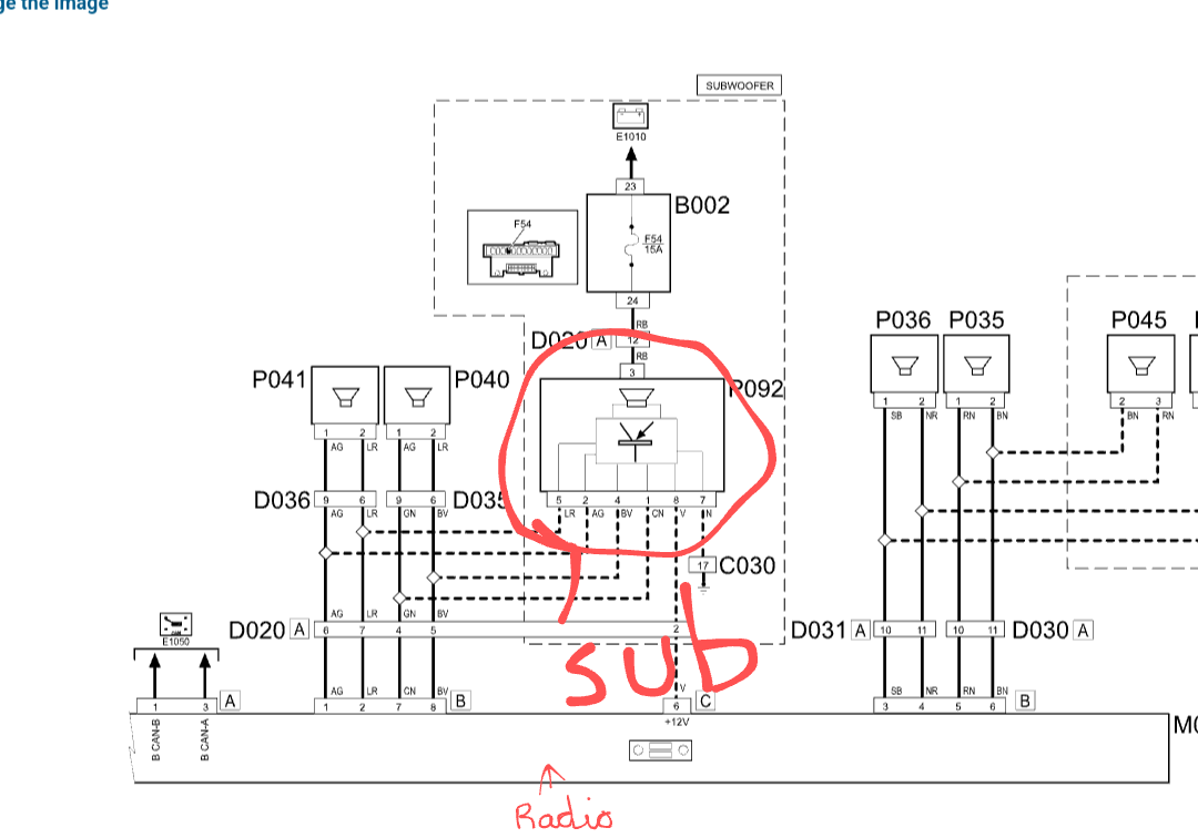

In the panda 169 the under seat sub is connected directly to the radio and has built in electronics
The rear sub in the Alfa is connected to a separate bose amplifier
I doubt swapping the connectors will help
I could be wrong

Have you got the FIAT part number of the Panda subwoofer? I don't think that it would be the same as the one bought by the OP, but who knows ;)
I can imagine that the Panda radio has a built in amplifier, so a direct connection is possible. The question is if every unit installed in the Pandas has it built in, or only a part (the high-end) ones of them.

No only fitted to higher end
Wirings different, seperate power fuses
Switches on and off by a switched power line rather than canbus and so on
Pretty different
Wiring is normally there, whether it's full complete I can't say
The wiring changed on the later euro 5, I suspect these would be more plug and play, but never tried
The 718 and E718 are a completely different as far as I can see
The original sub in the panda is power with electronics built internally, none of the options ever had a separate amp
The LANCIA sub is just a speaker with a matched separate bose amp
I doubt they will transferable, not something I would try, but who knows
