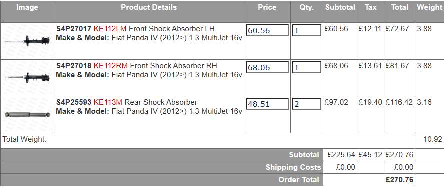

This are the shock absorbers from magnetimarelli :
Left Hand - 357145070200
Right Hand - 357145070100
Rears - 351997070000
Please find the picture with quote from shop4parts

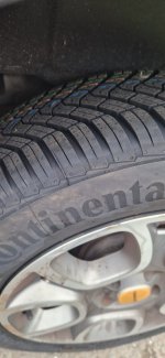

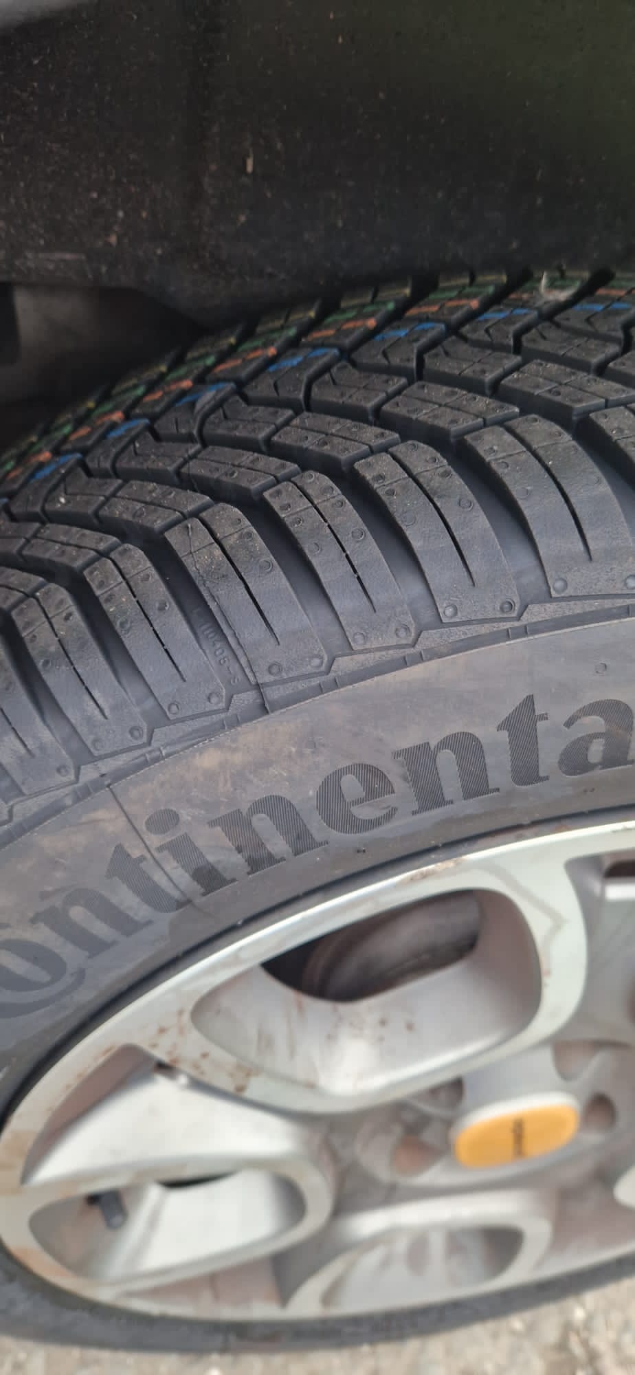

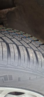

I did a wheels allignemtn and balance to all 4 wheels.
they found out that the camper angel si negative about 1.6 and 1.3 in the sides. that probably due to the coil springs and shocks being lower that normal.
the mechanic at the tire shop lifted a bit the side and show me that the camper was getting better due to the car being low at the front.
I think I will wait for the work.
anyway I think that a camper a bit "negative" does a good job handling wise in cornering better.???

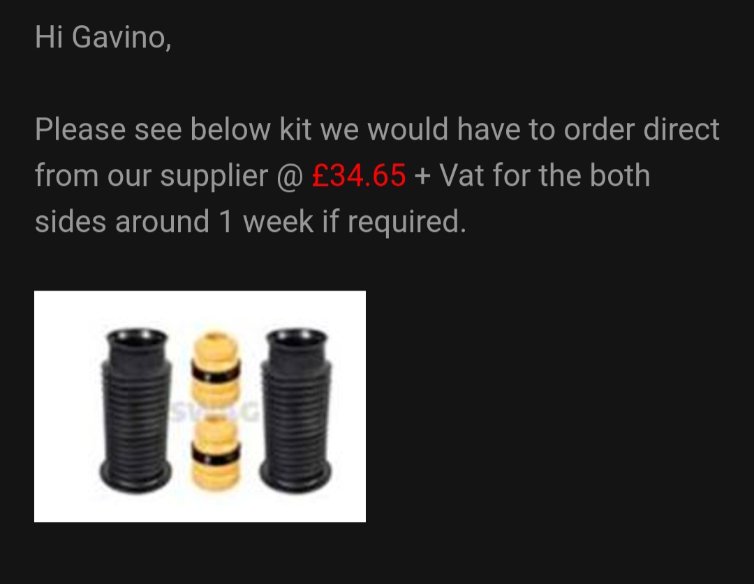

thank you for all you said and for the help.
I finally found a garage that will fit the part when I will buy it.
he told me that he does not know what it will be necessary to replace until he disassable the part.
can you please let me know what part I have to replace?
I know about coil springs and shock absorbers.
the shop4parts custumer service quote for this part :
please see the picture.
I would like to replace everything (front bushes , bearings , mounts, new bolts and nuts , ) do you suggest doing it?
Is there anything I will have to replace even in the outside (like mount in the outside : the things we can see when we remove the plastic under the wipers arms?
can you please make a list of the item I have to purchase.
I thought if the garage start doing the job and after need to order other stuff I will pay more for the labor and keep the car in the garage.
thank you in advance.

Also, he just reused the old dust cover and bump stop rubber from the old shock.
Top mount changed, spring, shock and drop link. Old shock was fine but garage had to hack it up to get it off otherwise I would have done it on my drive. My garage charged me £100 but that also included removing, fitting and balancing a new tyre. I supplied all the bits.
Thanks.

Thanks for your support I finally finished all the work . Thanks you for the review and feedback about shop4parts.
I replaced rear coil springs + shock absorbers + plastic rings + bump stop ( basically everything) in Feb 24.
In Oct 24 I replaced all the parts for front shock absorbers + coils + black cover and polyurethane bump stop) everything
See the result in the picture.
Plus tyre replacement, I decided to go for continental all season .
Thanks again.
