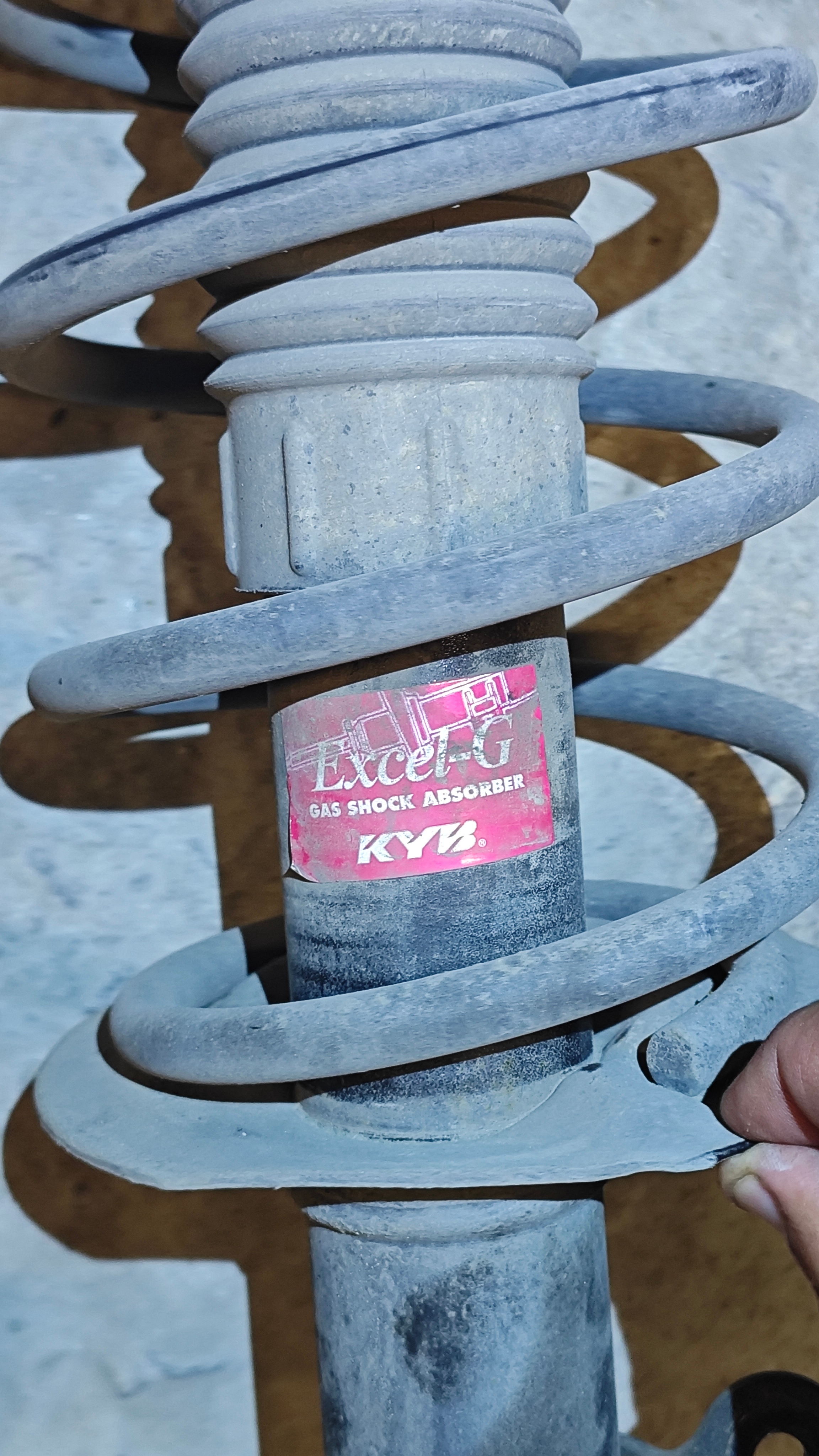

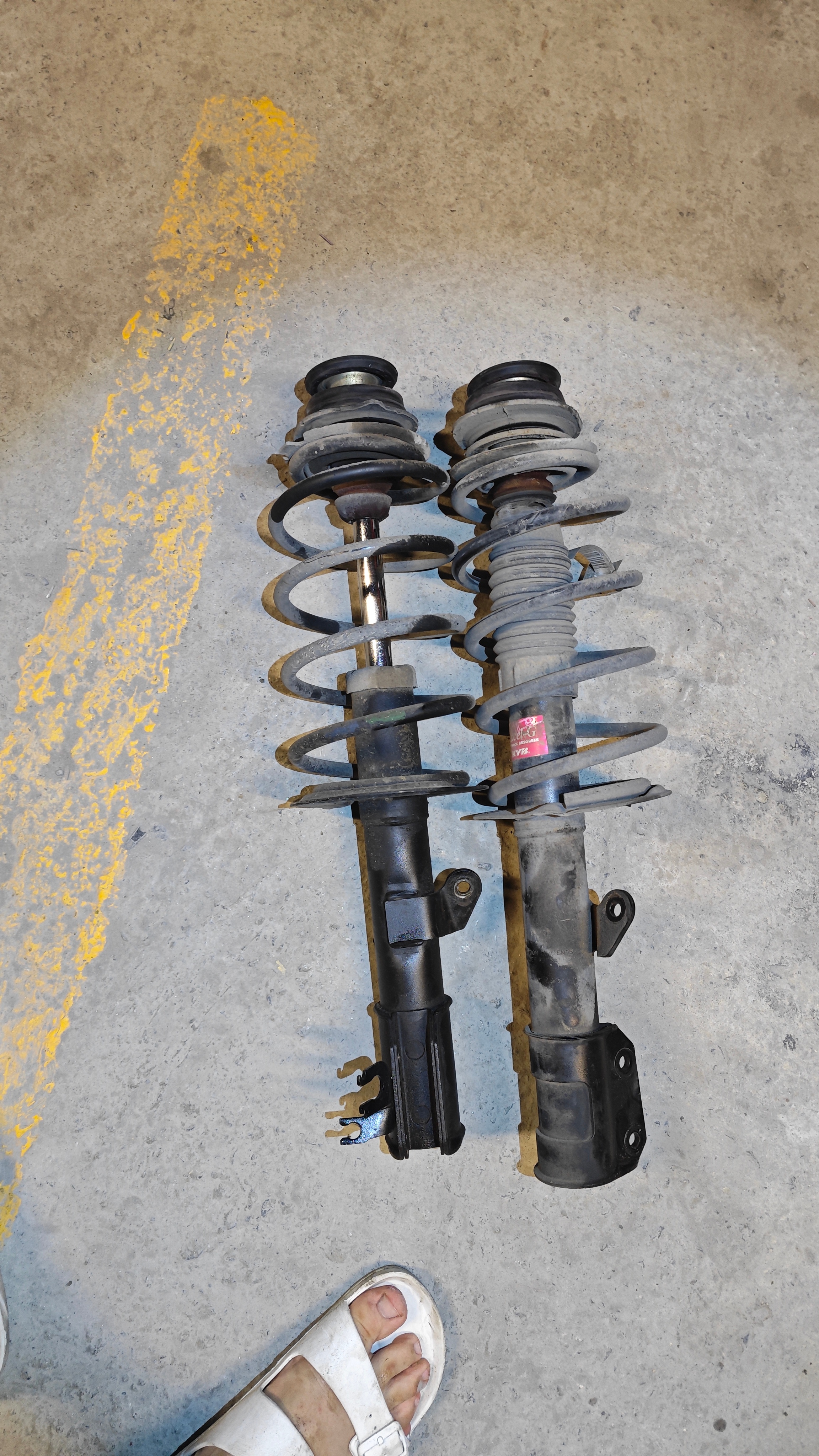

I removed the shock absorbers. One looks different than the other. Different products from different brands. I hope this doesn't cause any problems.

I paid 35 £for shock absorber mounts. original opar brand.
I asked about the shock absorber price.
2 pieces KRAFTWOL 15010104-15010105
He estimated the shock absorber at 57 £.
I found the shock absorbers cheap. Considering the money I spent on rubber.
I'll probably change them too.
My shock absorber mounts were not sitting this high because they had burst before.
I guess it should be like this when under load.
Since I didn't know this, I took it apart and put it back on twice :D

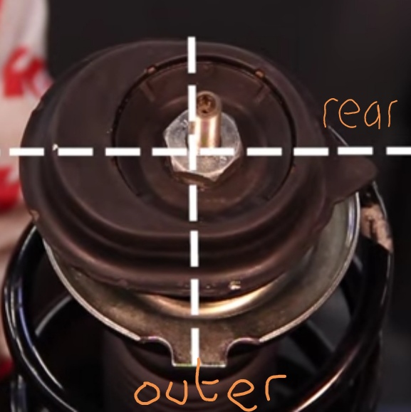

Yes there should be a gap
The only two bit that can be fitted the wrong way are these
@koalar what is the purpose of the 'outer' tab on the upper spring plate? When I replaced the front struts on my Panda, I just noted how the plates sat before and tried to keep them that way, and they could well be misaligned. It's not a great deal of work to take the struts off and realign those plates, if necessary, but do I need to do that?
Don't know
All I know is the notch should be pointing towards the outside
If it didn't matter they would have been symmetrical, I would think
