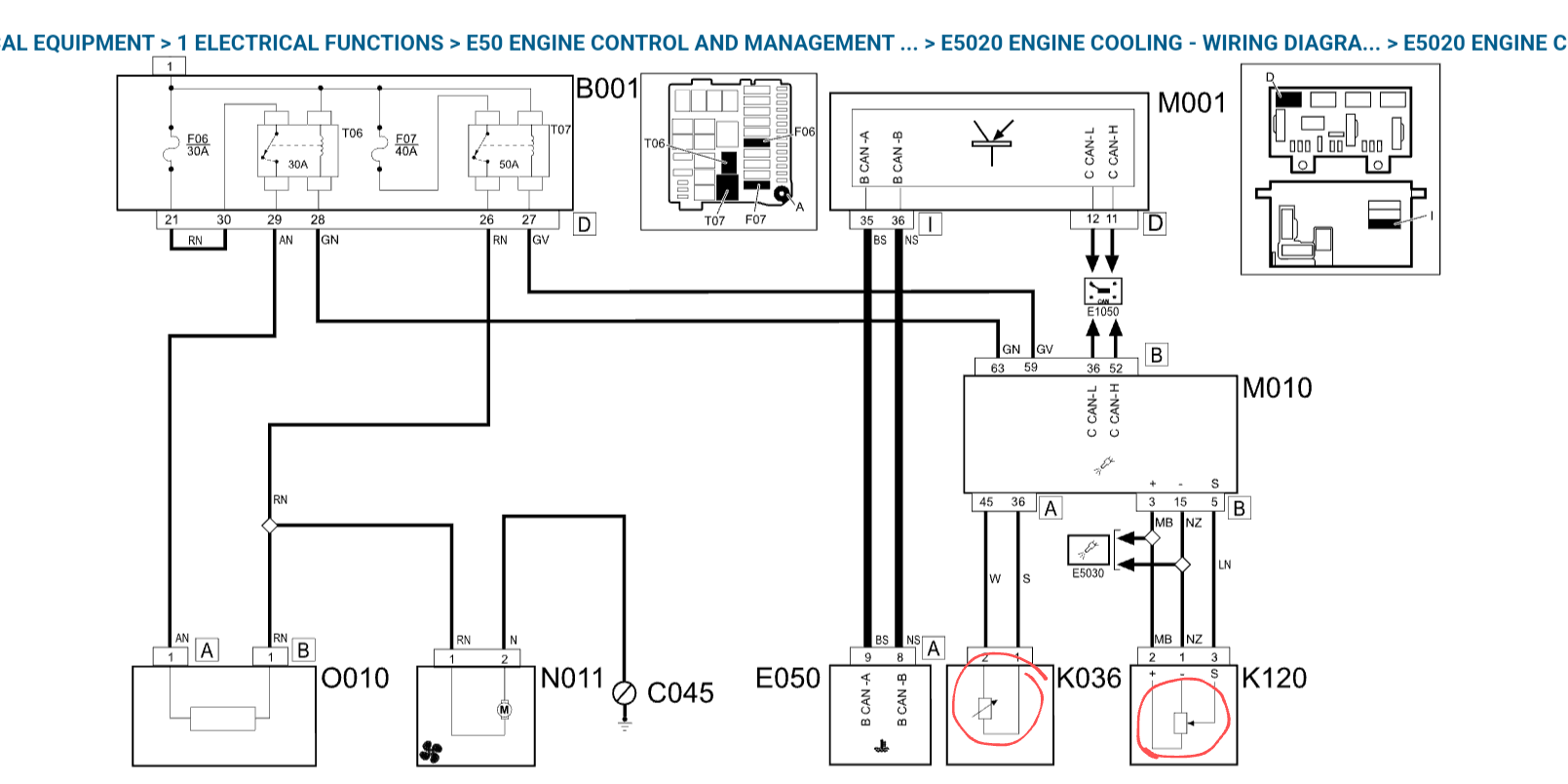

The euro 5 is different in use two signals to switch the fans on
One is the coolant sensor which we know is correct
The other is the air-conditioning linear pressure sensor
A fault here can cause the fan to come on permanently
Can MES measure it ?
Strange you also have the fan not working at low
