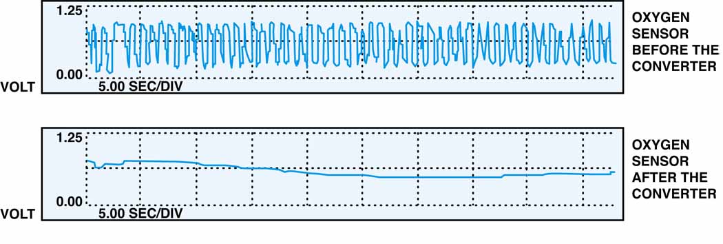

i check via software
a scope will show a nice sinewave
due to the software sampling rate live data from a scan tool will look more like this after the engine been on a couple of minutes
