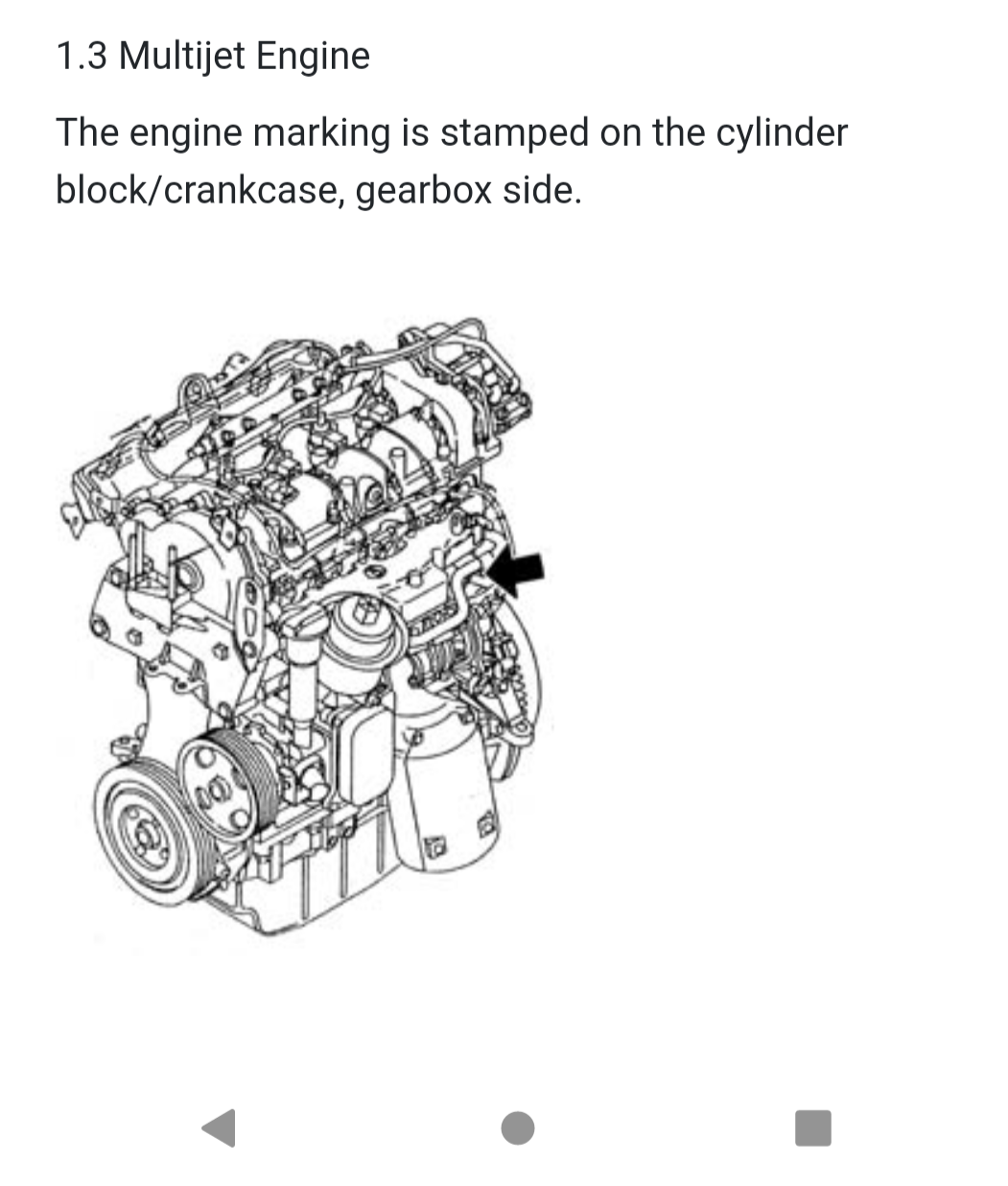

It's here this is the 1.3 mj from a 500
Just below the crank sensor bottom right

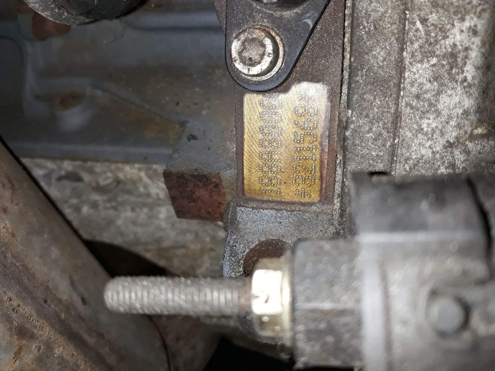

Here's the sensor looking down the driveshaft and slightly below, not the greatest photo, bottom right is the sensor top right is the wiring connector being disconnected

You can just about remove the screw holding it in on a lift
So you must be able to photograph directly underneath it

One last message : after blindly cleaning the area around the sensor and taking a lot of pictures from various angles (without seeing exactly what), I had 1 picture with the number clearly visible.
I went back to the inspection and showed the picture. And then -incredibly- the guy came back with a functioning endoscope and he to saw the numer.
I got the final paperwork and this step in the import-pocedure is Ok now.
