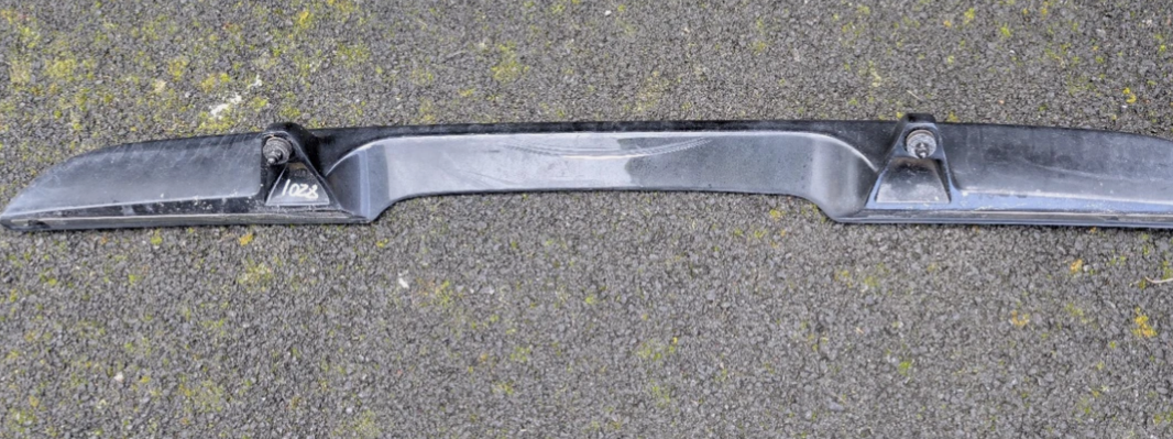

How did you fit the rear spoiler, is it bonded to the glass?
I have got hold of a spoiler from a 100HP and I was looking to cut off the bolts and bond it. As I understand it, the 100HP rear glass has mounting holes.

No, I have got hold of an 100HP one, I was hoping just to remove the ends of it's fixing bolts and then bond it to the glass.
I wanted an OEM spoiler.

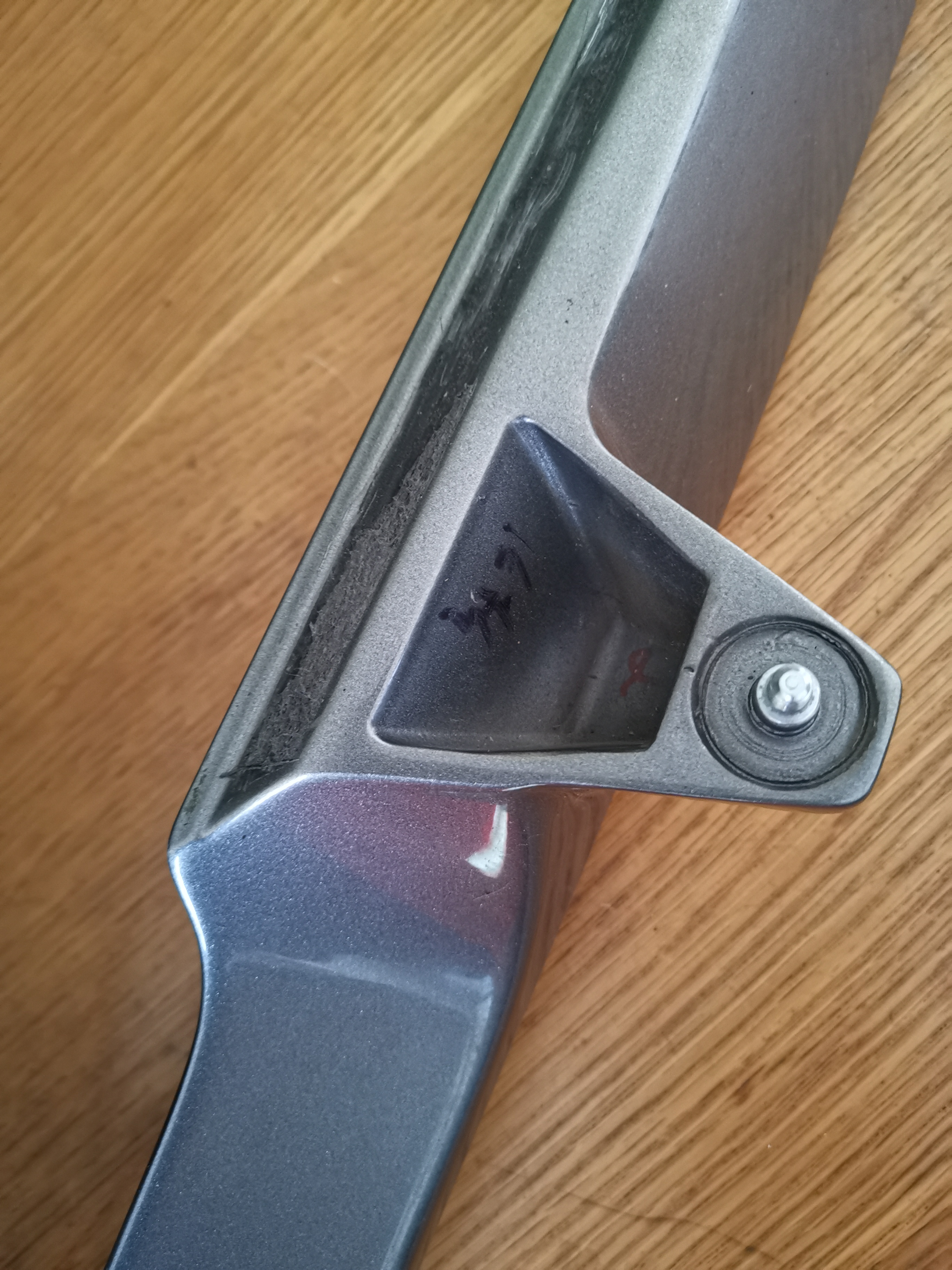

The current plan (and is just an idea at this stage), is to cut off the bolts , fill the circular bolt voids and the larger trapezoidal voids with epoxy (or similar), so that it is proud of the surface and grind/sand back to the same profile as the spoiler.
I also assumed that the area with the foam attached in the photo would also bond to the glass?
I will remove the foam when I repaint the spoiler, this should provide a decent contact patch for the bonding agent.
Again, not decided what to use, windscreen adhesive? Or any other suggestions? Sikaflex 221 or something like that?
you need to know what it's made from, nylon and polyester will cause problems finding something that will last long term
You could try small spot first, rough up an area inside the void and put one drop of what ever you are going to use, let it dry, try and knock it off with a hammer and chisel, if it comes off in one piece it's not going to work very well
The glass has to be clean and free of any residue, once cleaned I suggest washing again in biological washing powder, and rubbing the area with pure talc
Then the area that's going to be bonded to will need priming with something like Sika Primer-206 G+P
Then bonding with something like Sikaflex polyurethane adhesive
And then held in the correct position for at least 24 hours

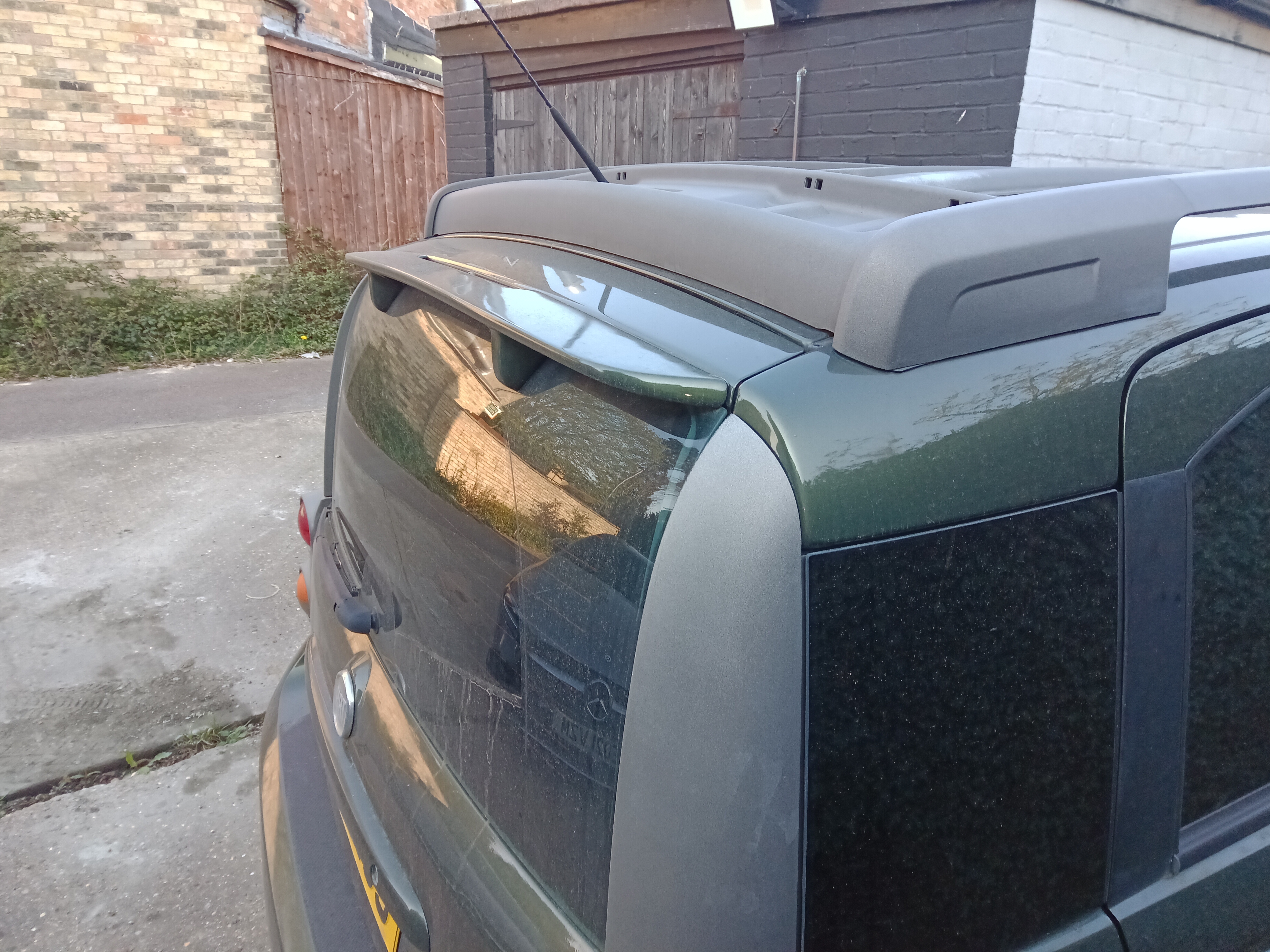

Fitted this about 6 years ago, with clear bathroom silicon sealant.
Filled the voids in the spoiler to increase the adhesion area and cleaned the glass with methylated spirit. Held in place with masking tape whilst it cured.
It's pretty solid.
