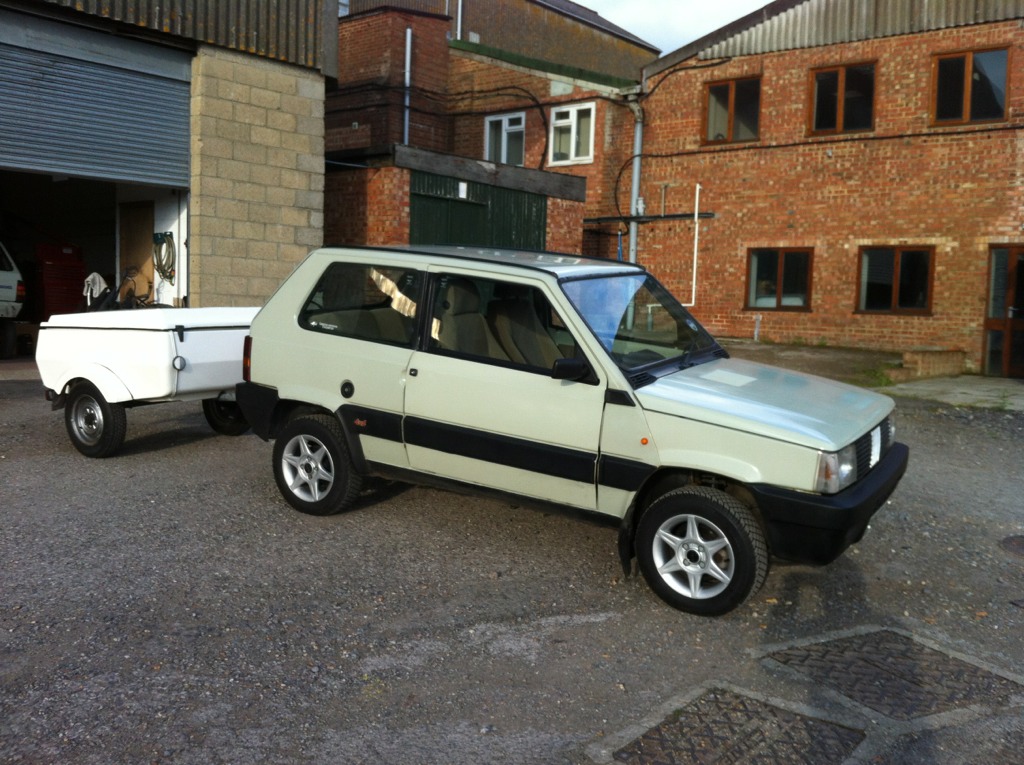

Panda (Classic) Pale green Classic Panda 4x4 (1986).
Just acquired this lovely 4x4. :)
Traded in by Gavin (Palio) against the project Panda I'm currently building for him. Gavin bought it back in February from Dave (Aquamarine) but has not used it since. Fortunately for me Gavin stored it at a friends house many miles from his own so didn't form an attachment to it.
Dave had done quite a bit of work to it before selling it on to Gavin, and as a result it's in lovely condition ( ignoring paintwork issues here :p ), even has new doors. Dave, perhaps you could fill in more details for us?
This is my only pic so far but will add more asap........
I really like the pale green colour so will be keeping this original but improve the finish in places. This will be an easy task as Dave has done a great job removing what little rust was there. As far as I can tell the doors and back of the inner sills were the only rusty areas on an otherwise solid and straight Panda. This is impressive given it's an early Mk2 (1986).
Mileage is a very low 58,000, this is reflected in the condition of the interior and mechanics. I haven't driven it yet but Gavin and Barbara have and they assure me it is a real pleasure, with a strong engine and a tight and quiet gearbox. :)
With the plans for Barbara's own Panda recently changing I find myself with some nice upgrades looking for a home. The beige Alfa interior would look stunning with the green paintwork so I'm very tempted to fit it. Then there's wheels. I have half a dozen options here, including leaving the current ones on, so think I will just have to try them all and see what looks best. Other than that the rest will stay as it is.

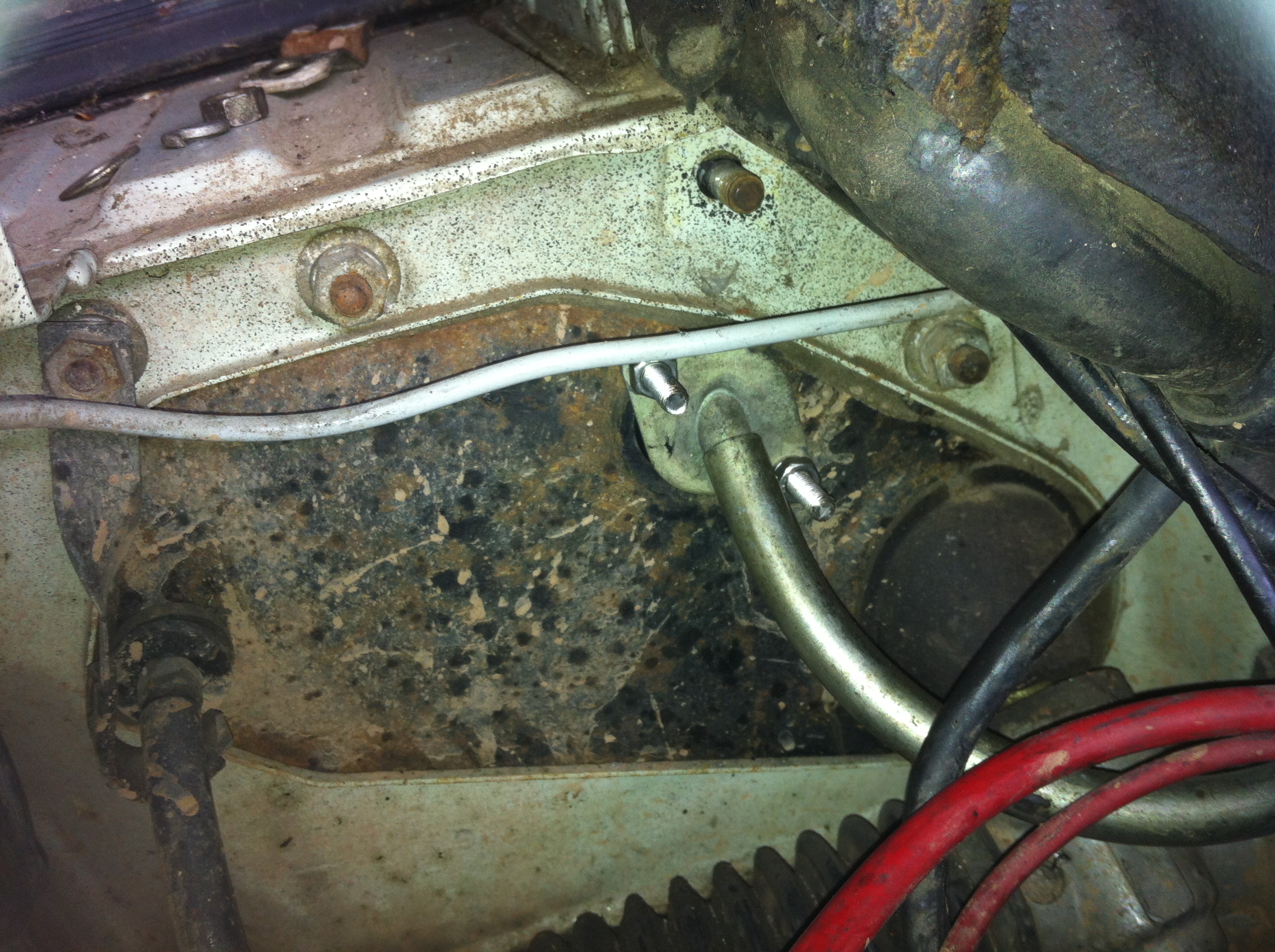

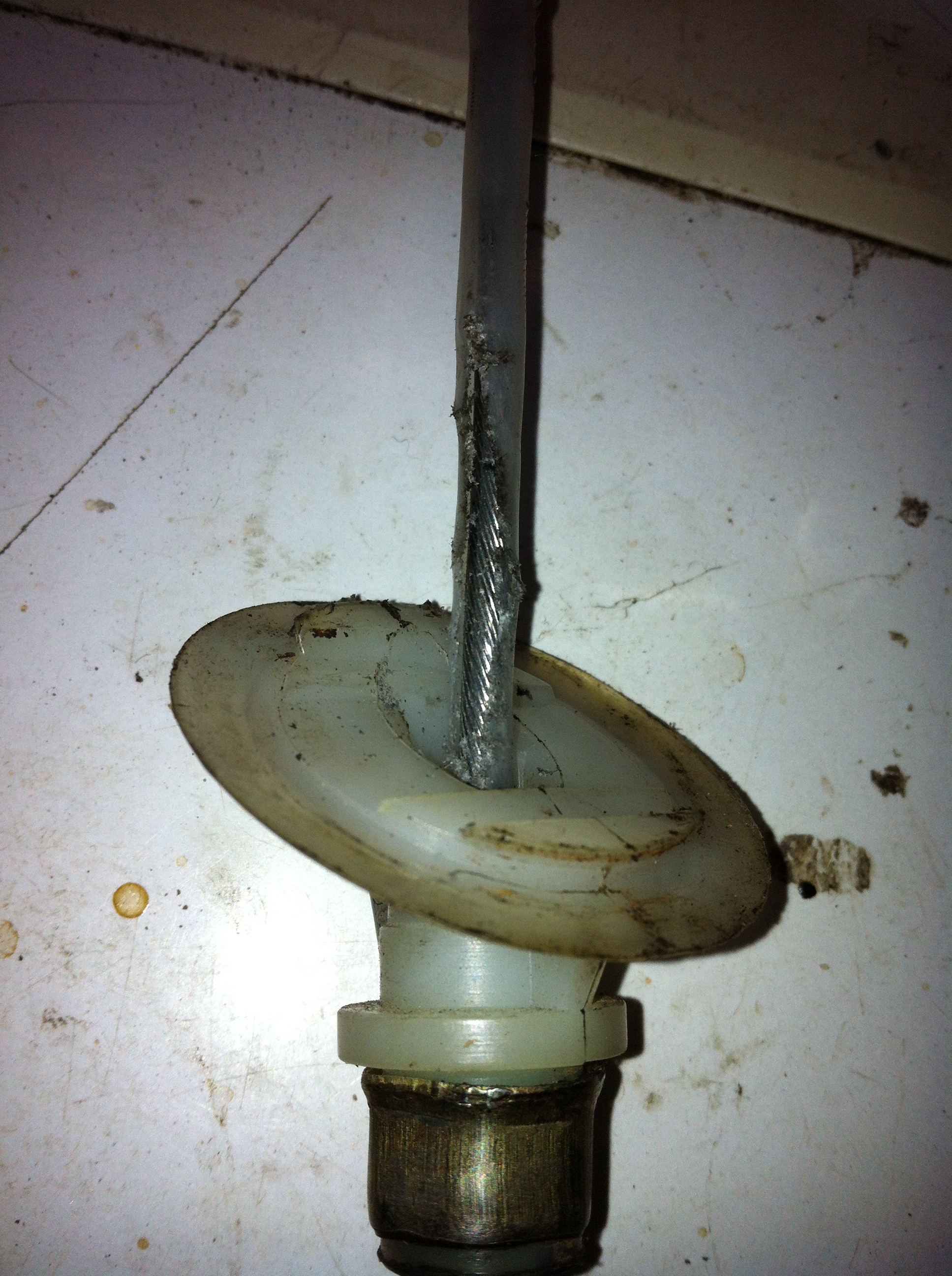

First up was the clutch cable, he's had two in the last three months and the pedal was now stiffening up yet again :bang: On inspection I found the inner plastic was worn away.........
There must be a problem with the angle that the cable takes after passing through the bulkhead as the later cables have a 90' bend built in at this point. I decided to fit one of these later cables to see if they survive better. I did need to drill two 6mm holes in order to fix the new cable with nuts and bolts but that was easy enough as the head was off (more of that later ;)).

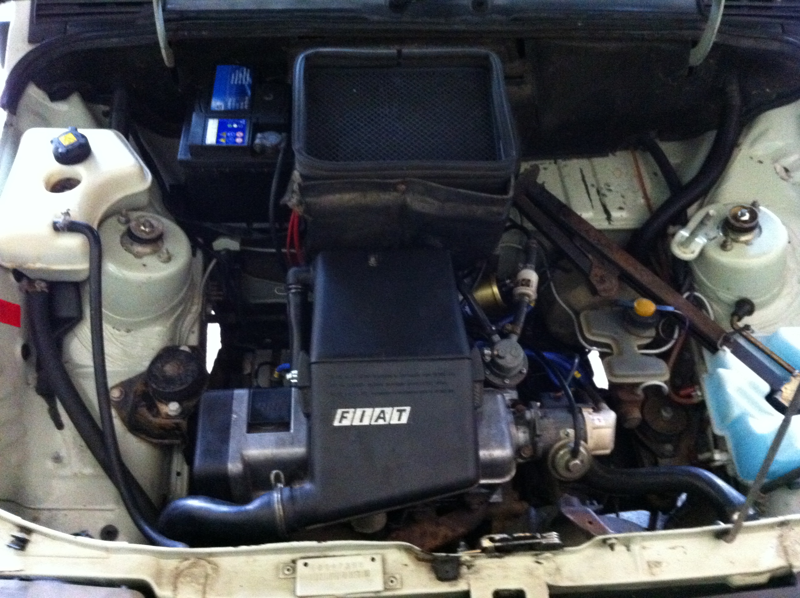

Now, about that head being off.

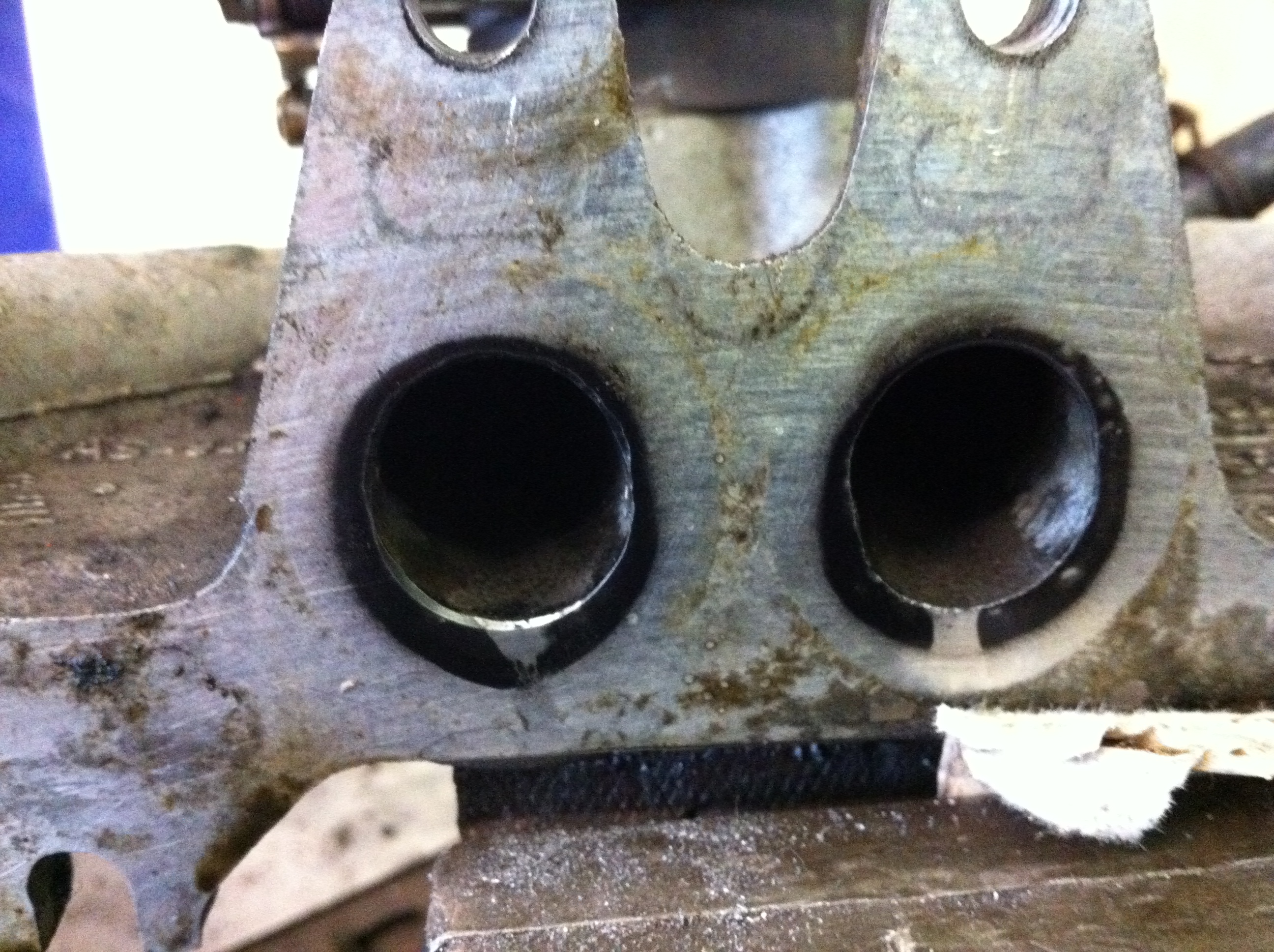

Well I've had this gas flowed head lying around for about three years while I waited for a reason to fit it to something. It's a 4x4 head, professionally ported, with new valves, and a 4x4 cam shimmed up and fitted. Cost someone £400 apparently but I got it with a bunch of spares.

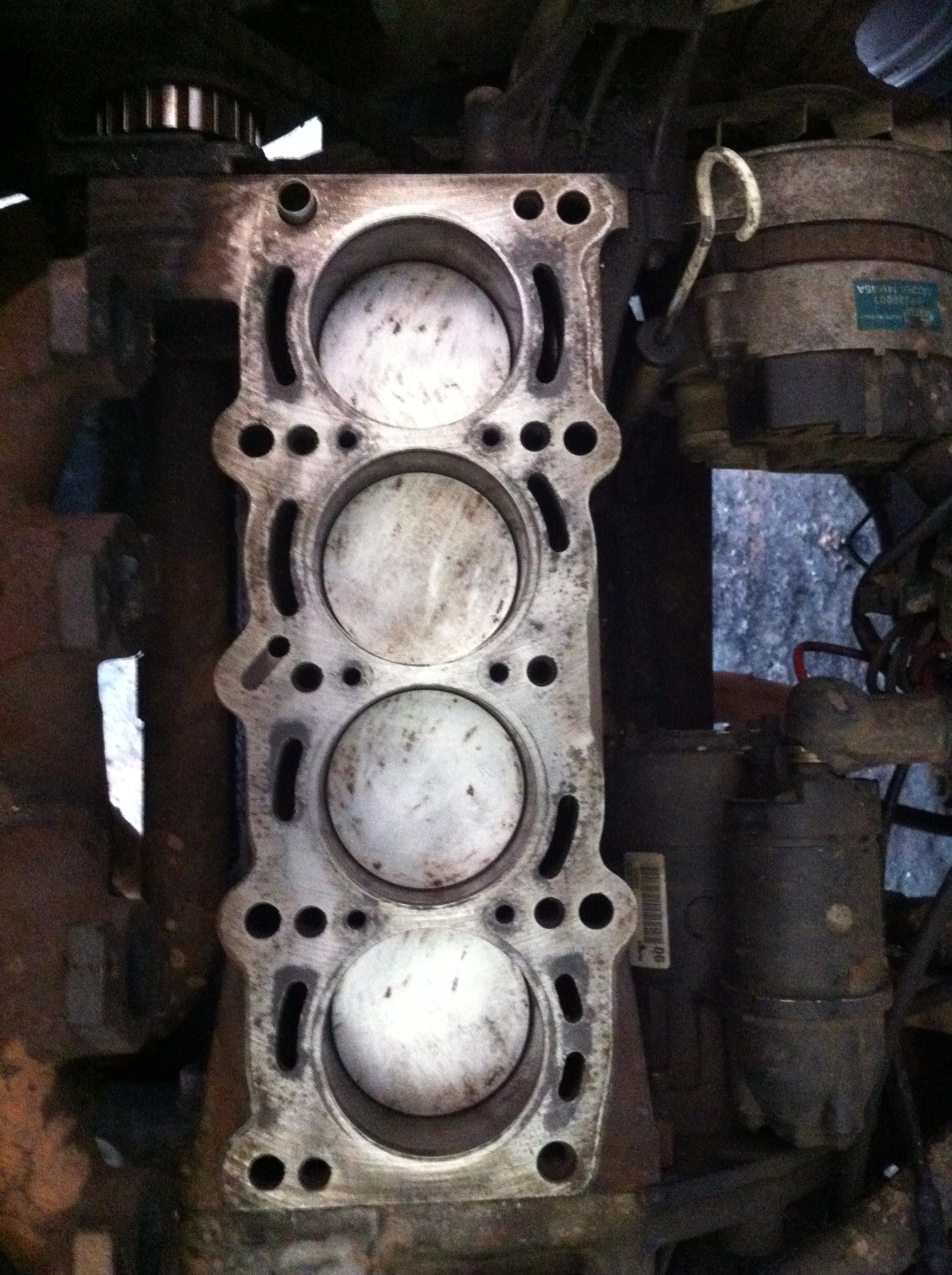

So, off came the old head....

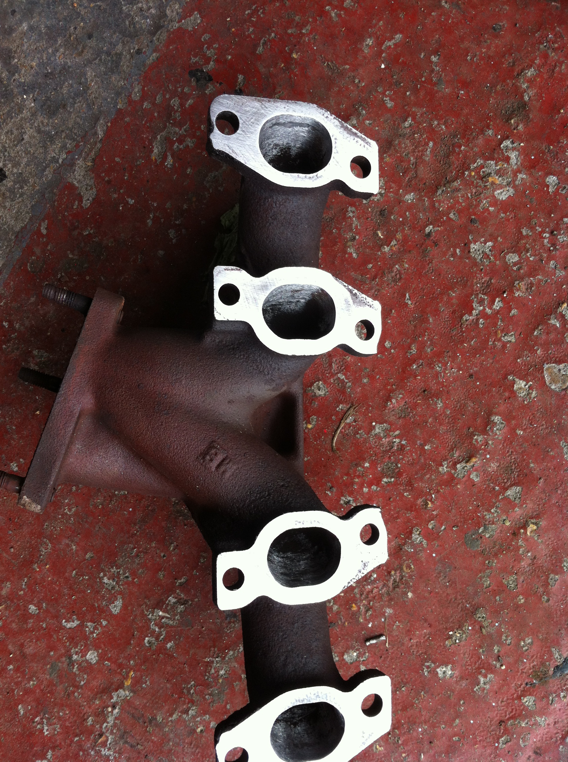

While we were at it we could see that the ports had been opened up to match the size of the holes in the inlet and exhaust gaskets so it seemed like a good idea to open up the manifolds to match. so by laying a gasket on the face of the manifold and spraying paint through it I could clearly see where I would have to remove metal........
Job done......

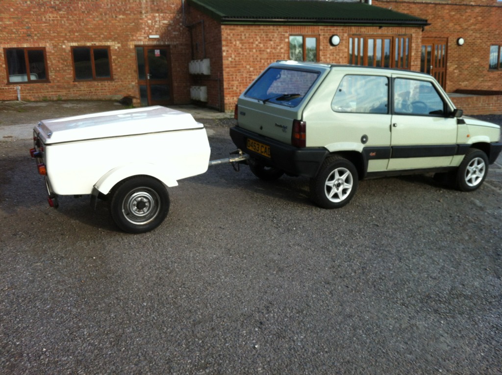

Towing Bucket to Birmingham yesterday (1 week late as we'd spotted a couple more bits to weld) was the only trip I'd managed since so was unable to gauge if the head had made any difference, but tonight on the way home, free of trailer, I was able to test it out. I don't feel that 0-60 is any different, but I really did notice better acceleration in the higher gears. Put your foot down at 50mph in fifth and it really does accelerate well. I think top speed will have been increased too, can't really measure this because it's above the legal limit :p but it certainly gets to 70 alot more easily.
I've also decided to leave the 14" Alfa alloys on him too. I like the look of them and the increased ground clearance. Bet we don't get snow this year now :(.

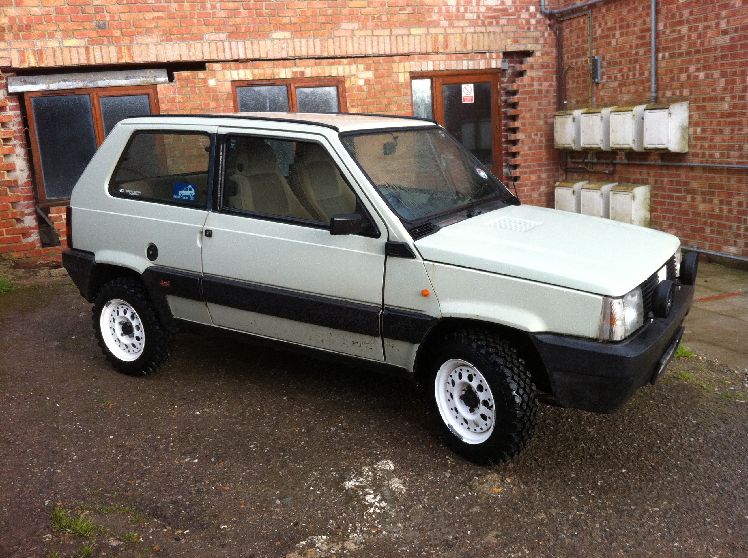

Just want to post this pic here as a point of reference............
Nothing to report really. Oslo just keeps soldiering on as my regular transport, collecting parts, towing other Pandas etc. I did change the oil and filter the other day but apart from that it just get used. :slayer:
Edit: Just referred back to the first post and it would appear that we have now had Oslo for twenty months and have covered 19,500m, that's an average of nearly 1000m a month. Quite a good answer to those questioning the ability of a Panda as an everyday car.

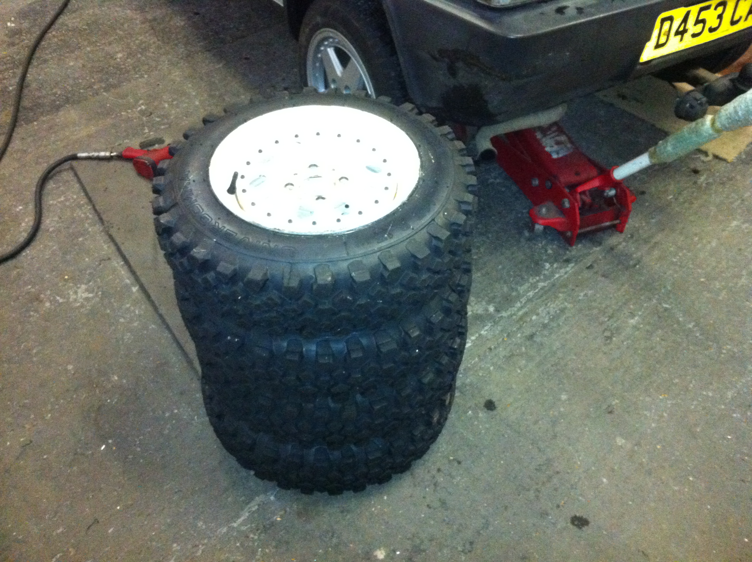

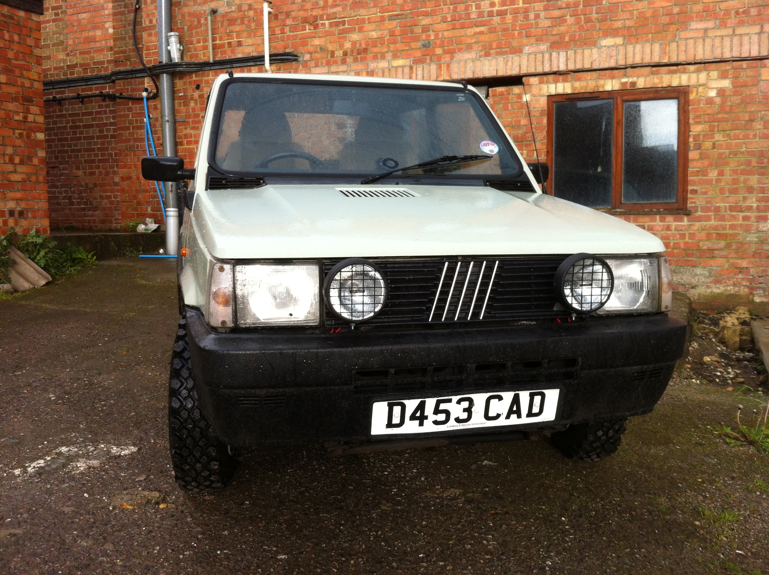

Thanks to the Panda 2012+ section of the Forum Barbara and I are taking Oslo on an offroading trek tomorrow so I thought I'd better fit the chunky tyres as it has been raining here most of the day. It's a professionally organised trip, usually they cater for the bigger 4x4's (Landrovers etc) but some of the Mk4 gang wanted to try their Pandas out offroad so a Panda friendly day was born. Only a couple of new Pandas signed up so that left room for us! :D
While I was fitting the tyres I thought I might as well fit a couple of other upgrades that have been waiting for a while........

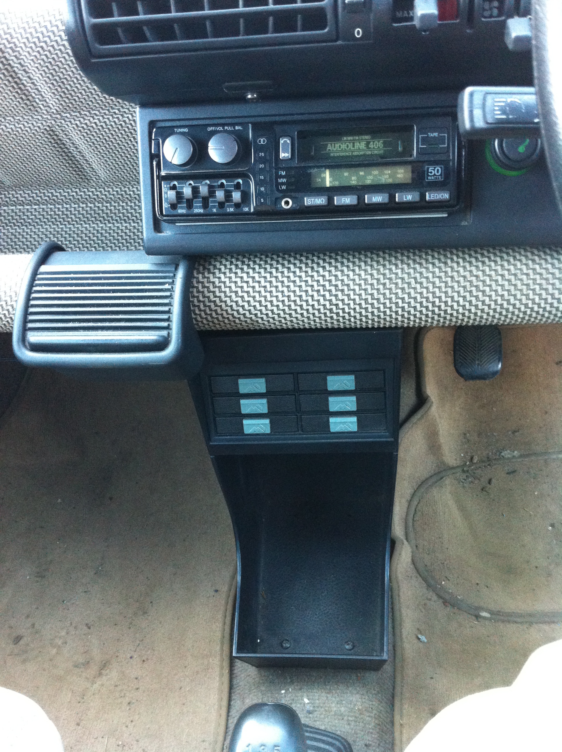

A cassette holding centre console joins the radio cassette player.
A pair of spot lights with funky grilles.
Twin air horns as fitted to Bo the selecta and Panto.
And the chunky tyres.
They are 145 80 13's fitted to some after market steel wheels. The offset is less than the standard Panda wheels so they come nicely to the edge of the front arches. I left the 16mm spacers I use with the alloys on the back so they fill the rear arches nicely too.
So now we are all ready to spend the day trying not to get shot on the Salisbury plain. :eek:
