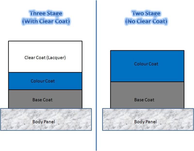

I work as an Auto Detailer specializing in paint correction.
After 1996 most paints will have converted to an environmentally friendly water base and clear coat.
This is a three stage process that will have a base primer, the colored paint and then a clear varnish or clear coat. This protects the paint but over time can oxidize and diminish and peel if left alone to the environment, hence the use of wax and other protectants.
The clear coat makes up around 50% of the three layers but some manufactures use harder clear coats than others.
The Fiat paints are generally soft and pigments in the yellow and especially red paints are prone to faster oxidization in the clear coat.
The older paints would be two pack, a base primer and then the colored paint hence when you polished the paint you would see the color come onto the polishing pad.
When your using an abrasive compound polish on later paints your removing very tiny amounts or clear coat that brings back luster to a dull, scratched or oxidized surface although you will see no color on your polishing pad or cloth.

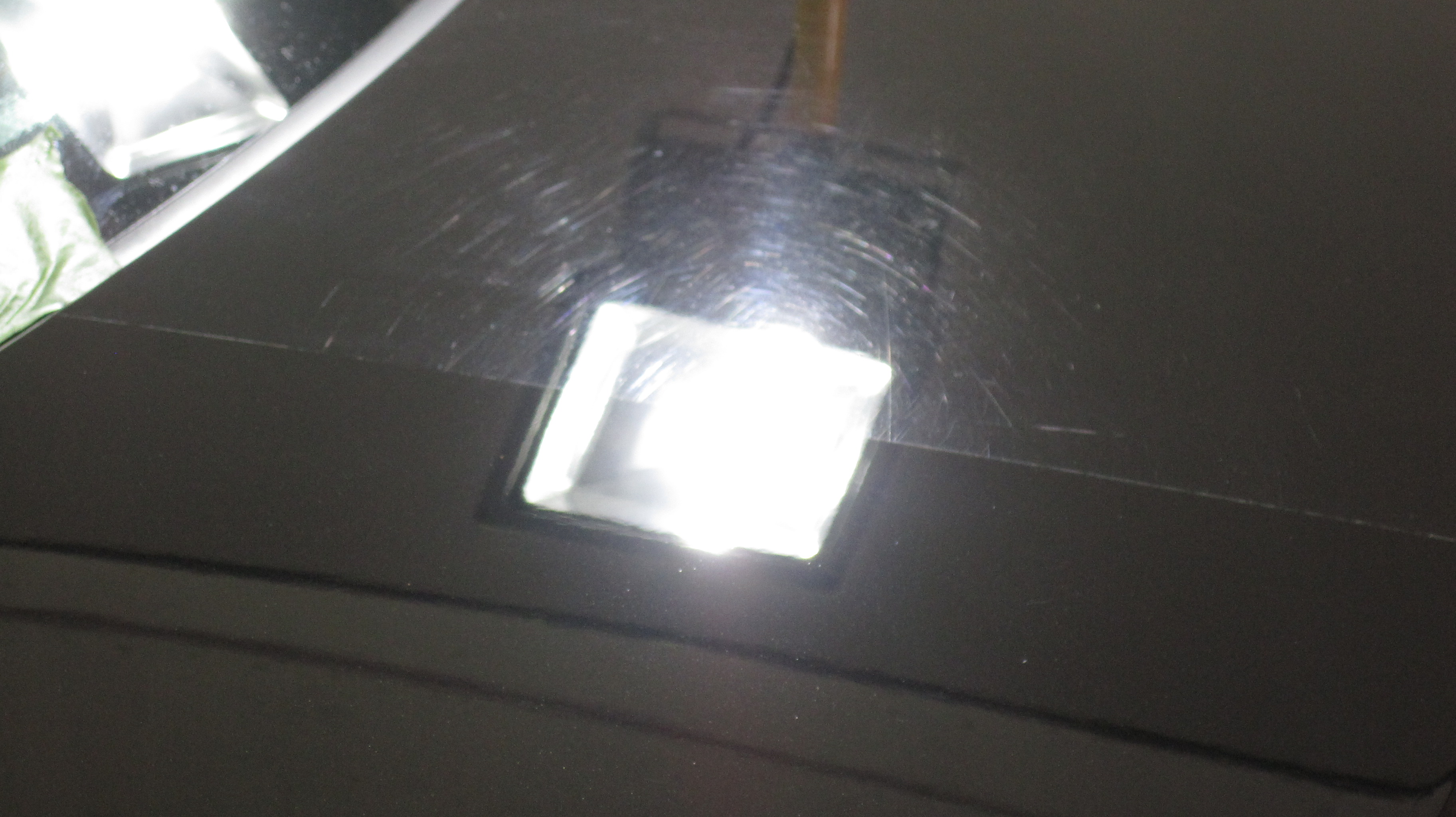

Colored paint could mean strike through the protective clear coat! or possibly someone over the years has used a two stage paint for some repairs.

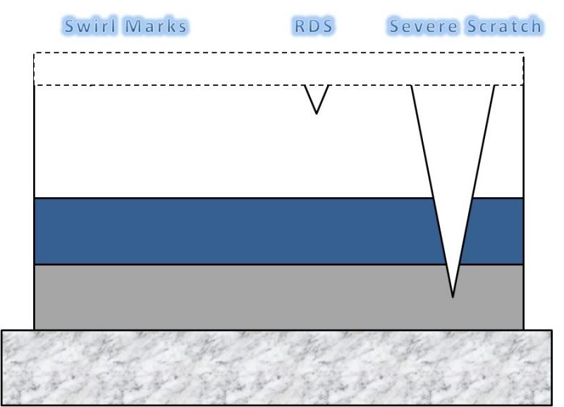

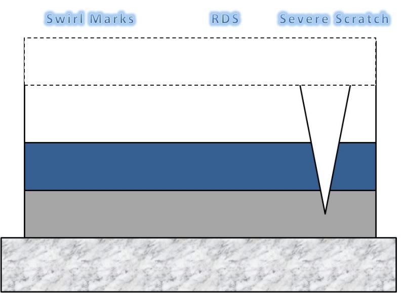

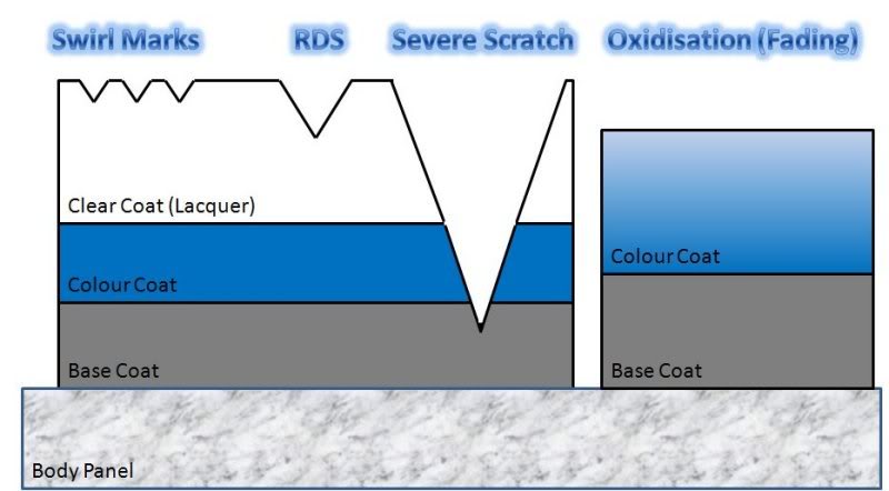

And Yes, forgot to mention, Any type of paint defects whether oxidization,scratches or environmental attack will be highlighted with sunshine or any source of bright artificial light. Swirls or cobwebs( light surface scratches) or RDS (Residual deep scratches) or even severe scratches which break into the base coat can be seen clearly.
Generally the light swirls(which are not round but its the refraction of light from the sun or artificial light which will disappear or cannot be seen in low light conditions.
Auto Detailers specializing in paint correction like myself will work under professional lighting to remove any defects in the paint and reveal a mirror like finish. :D
Here are some charts and pictures of my brother in laws car I did recently that explain things clearly.:D (y)

And Yes, forgot to mention, Any type of paint defects whether oxidization,scratches or environmental attack will be highlighted with sunshine or any source of bright artificial light. Swirls or cobwebs( light surface scratches) or RDS (Random deep scratches) or even severe scratches which break into the base coat can be seen clearly.
Generally the light swirls(which are not round but its the refraction of light from the sun or artificial light which makes them look round will disappear or cannot be seen in low light conditions.
These are the easiest to remove or fill by certain polishes but Auto Detailers specializing in paint correction like myself will work under professional lighting to permanently remove any defects in the paint and reveal a mirror like finish. :D
