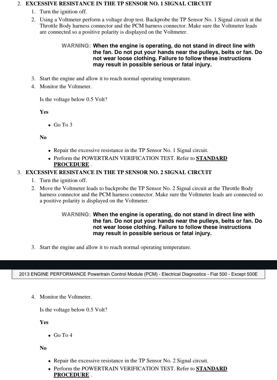

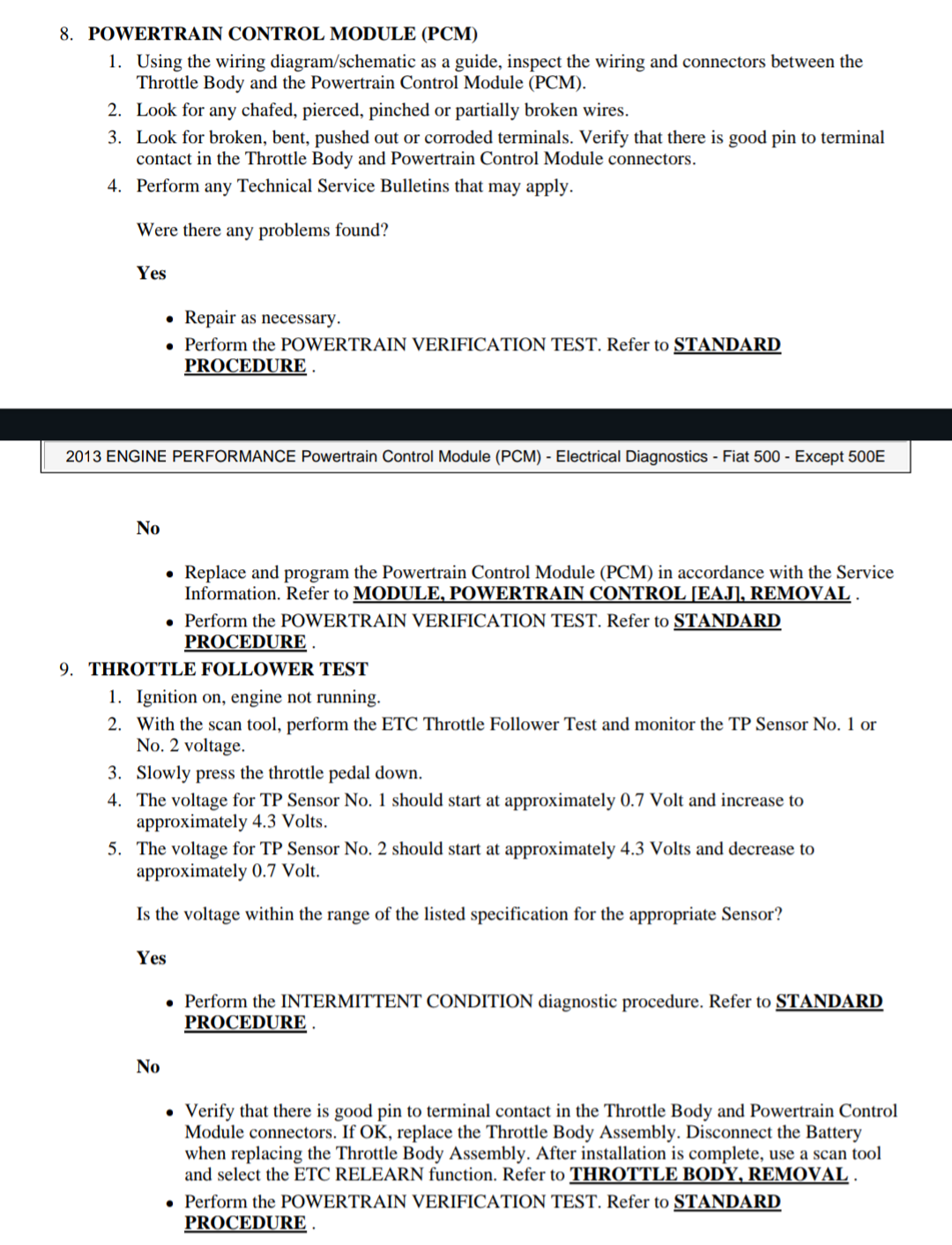

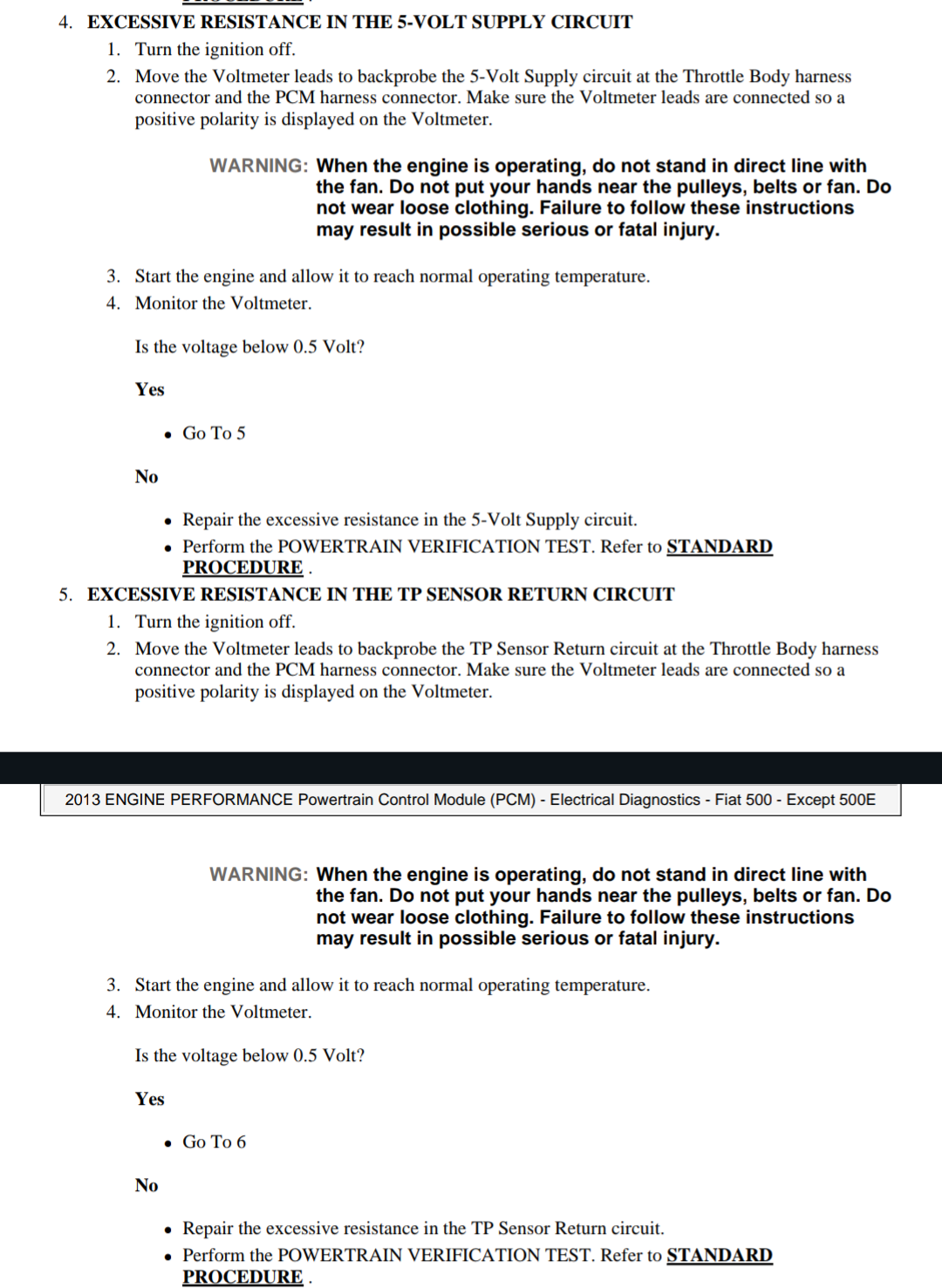

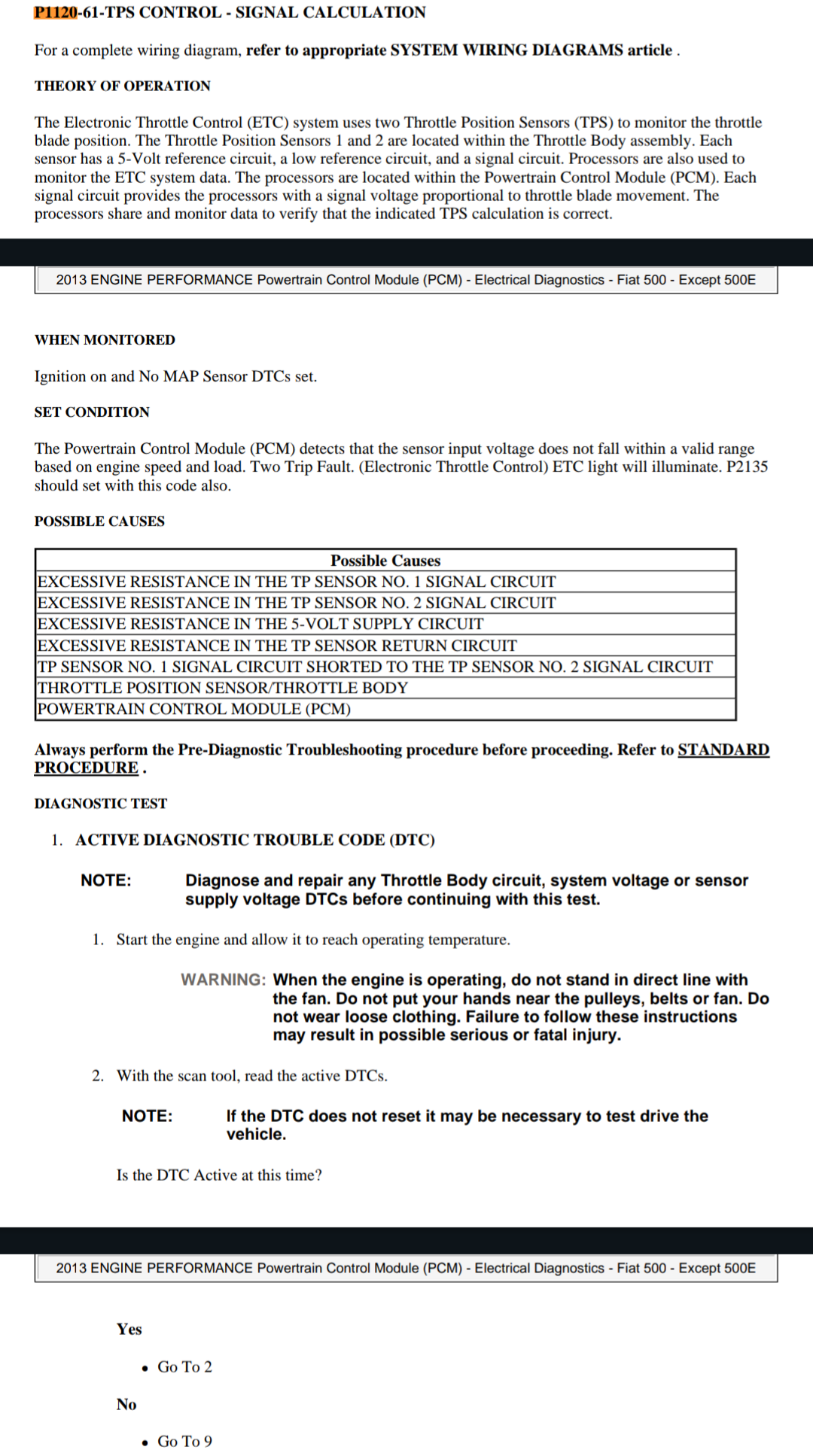

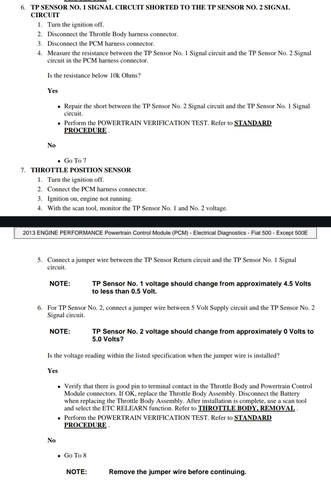

5V reference and chassis ground are an obvious start
The the diagnostic procedure below

View attachment 446707View attachment 446706
Thanks, yes they recalibrate the throttle bodies, i think they are doing this every time after they delete the message. I don't know if they have done the diagnostic procedure you said, i will inform the repair shop.
