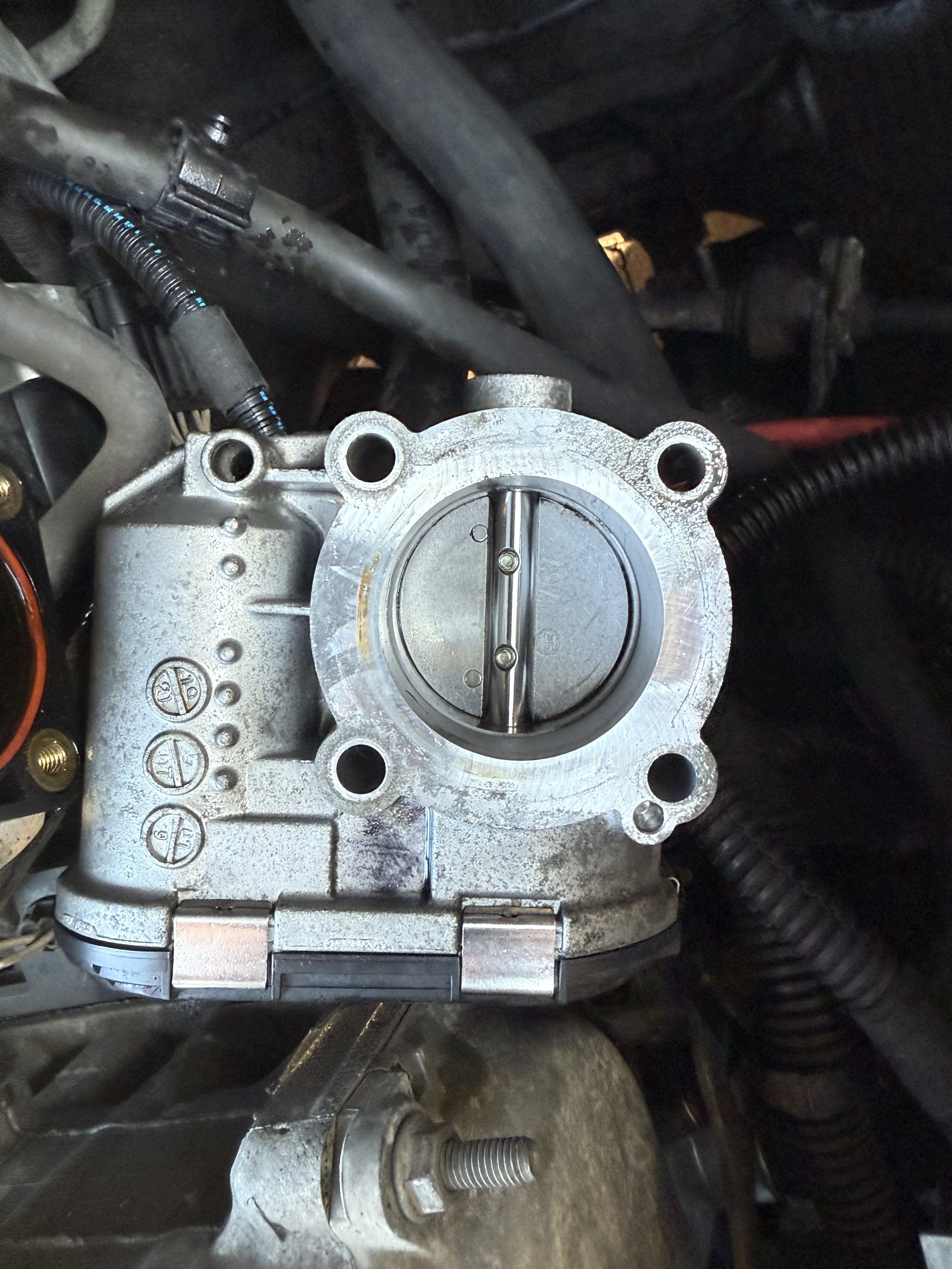

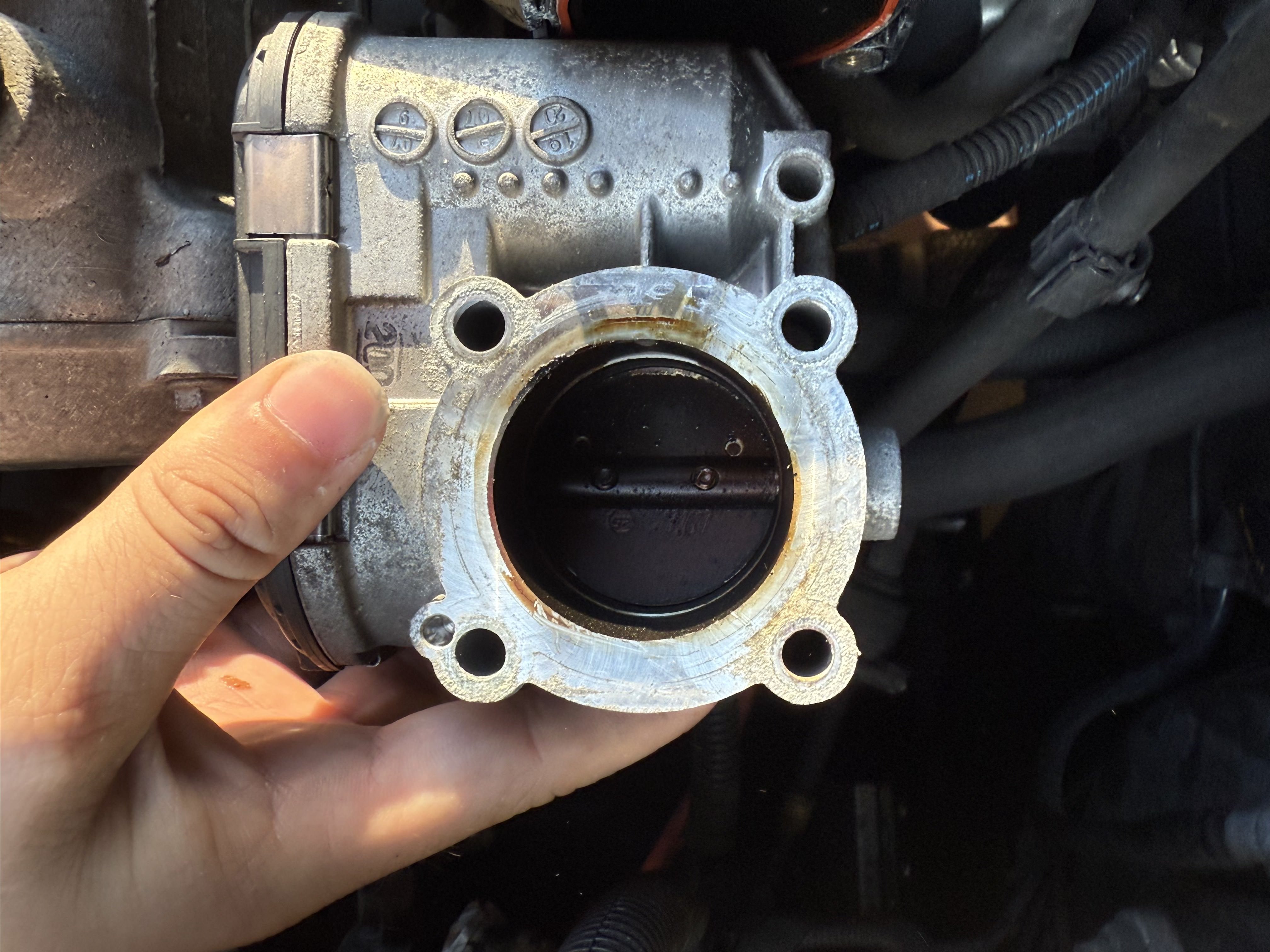

Just cleaned the throttle body, everything went fairly easily. The Seal is definitely reusable. The throttlebody and seal seem to be the same as on the MultiAir engines, part number on the seal for the MultiAir is 77364551
(kit for the entire intake manifold, also includes 4 seals for the connection from the intake to the engine)
The idle is back to normal, throttle response, power, and fuel consumption have improved drastically. The last 2km to my house is a slow, windy road through a residential area, speeds between 20 and 30km/h (12-20 mp/h), so throttle inputs would not exceed 20%.
Before cleaning, I averaged 12km/l (28 mpg) - After cleaning, I just averaged 16km/l (38 mpg!!)
Save to say it was worth the €10,- cleaner and spending 30 minutes. Thanks to everyone for the help!
Before:
After:
