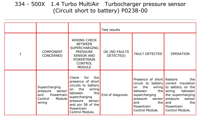

So I have a p0236 fault code on my fiat 500x 2017 1.4 multiair turbo.
I found that there was air leak from the turbo hose so I changed to new one.
Now even there is no leakage the fault code came back.
I was thinking maybe is the MAP sensor as the vehicle doesn't have MAF so the only option is MAP, but it doesnt seems like it as the kPa of the sensor is alright while driving, around 50 to 100 as it should be.. any possible causes you guys familiar with?
Also do you guys know the number of the MAP sensor so I can check on ebay?

No info on P010F but I have this for P0238
Also for P010F see: https://www.obd-codes.com/p010f
So far all sensor pressure related.
Just another thought. The turbo will have one or more flexible small bore hoses linking to various places. Check these for splits, holes, etc.
And of course all the myriad of wiring in that area :)
