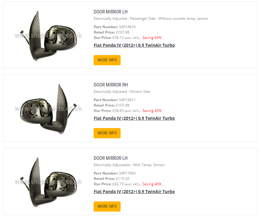

The attached screenshot shows the two different types. It sounds like your mechanic has fitted your car with a mirror for a car without the temperature sensor.

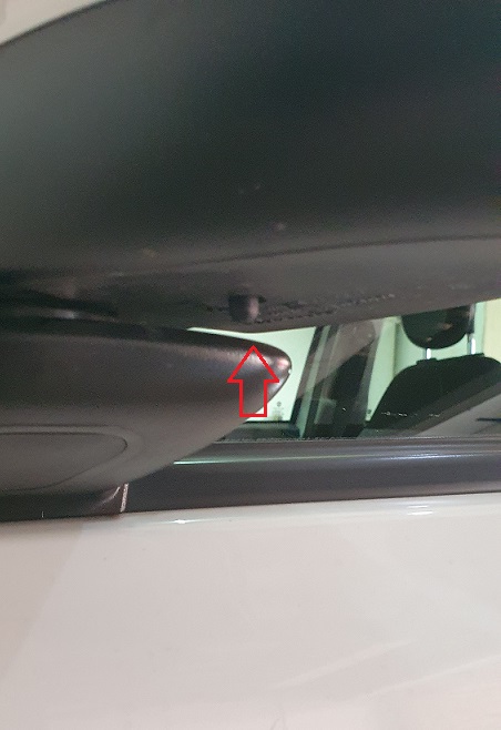

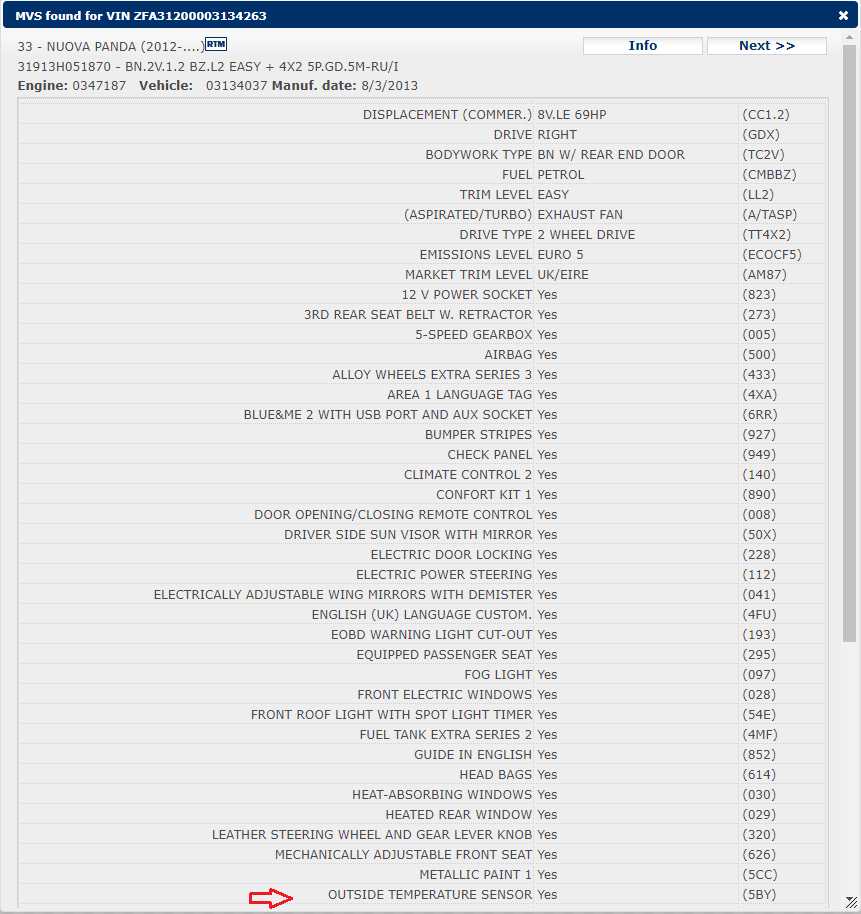

As per Panda IIs the correct mirror will have the little protrusion hanging off of the bottom as shown by the arrow in the attached picture. If you provide your car's VIN someone here could pull it's exact specification showing it's meant to have an external temperature. I've included an example screenshot of the type of info you could expect.

Here's your Panda's report. The last line shows your car has the outside temperature sensor.
