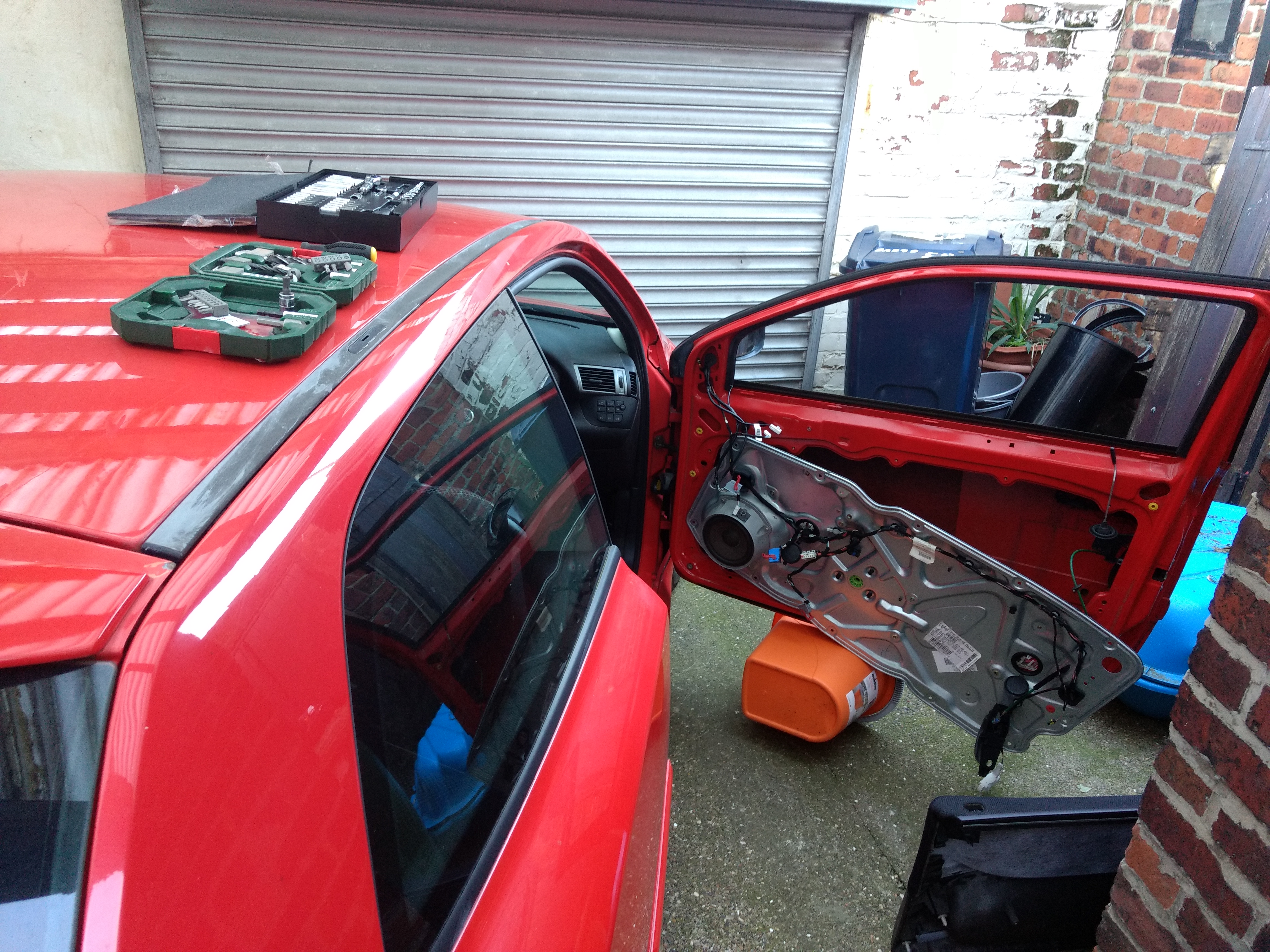

Update on this, had the door card off, disconnected everything underneath, but got a bit stuck with getting the metal inner plate off. Ran out of time in the end so just had to put the door card back on until I next get a chance to look at it.
Drove it round the corner and realised I couldn't open the door from the inside. Had to climb over the passenger seat to get out, haha.

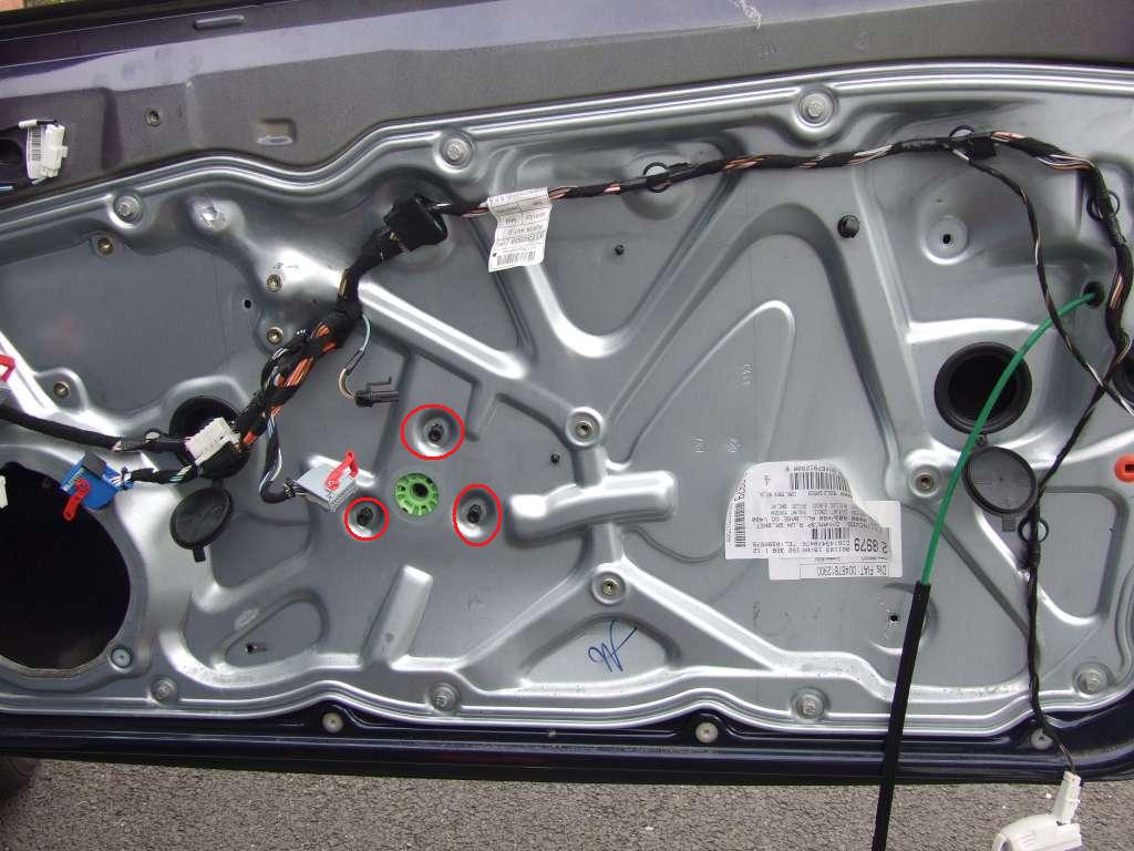

So wondering if I can get a bit of advice. I'm at the stage shown in the attached pic, taken from the window guide, but it goes on to talk about drilling out rivets when it's been said in this thread that's not needed.
From here should I be expecting to get this metal panel off?

No mate you don't want to be drilling those as far as I understand. Those 4 x rivets hold the runners for the window glass. You don't need to remove them as you're not changing the window mech.
You need to undo the hex bolts holding that panel to the door - the guide does however say that you'll not be able to remove the panel fully as it's connected to the external door handle.
OK cool. In order to get to that latch then am I just looking to bend the metal plate somehow? There's not a lot of give in it and if it's attached to the door handle I'm not sure how I'd get enough room.
OK, went back and read the guide properly. Took the glass out (I'd already removed the motor so had to wind it manually, loosened the wing mirror for a bit more space too) and there's a lot more play in the panel.

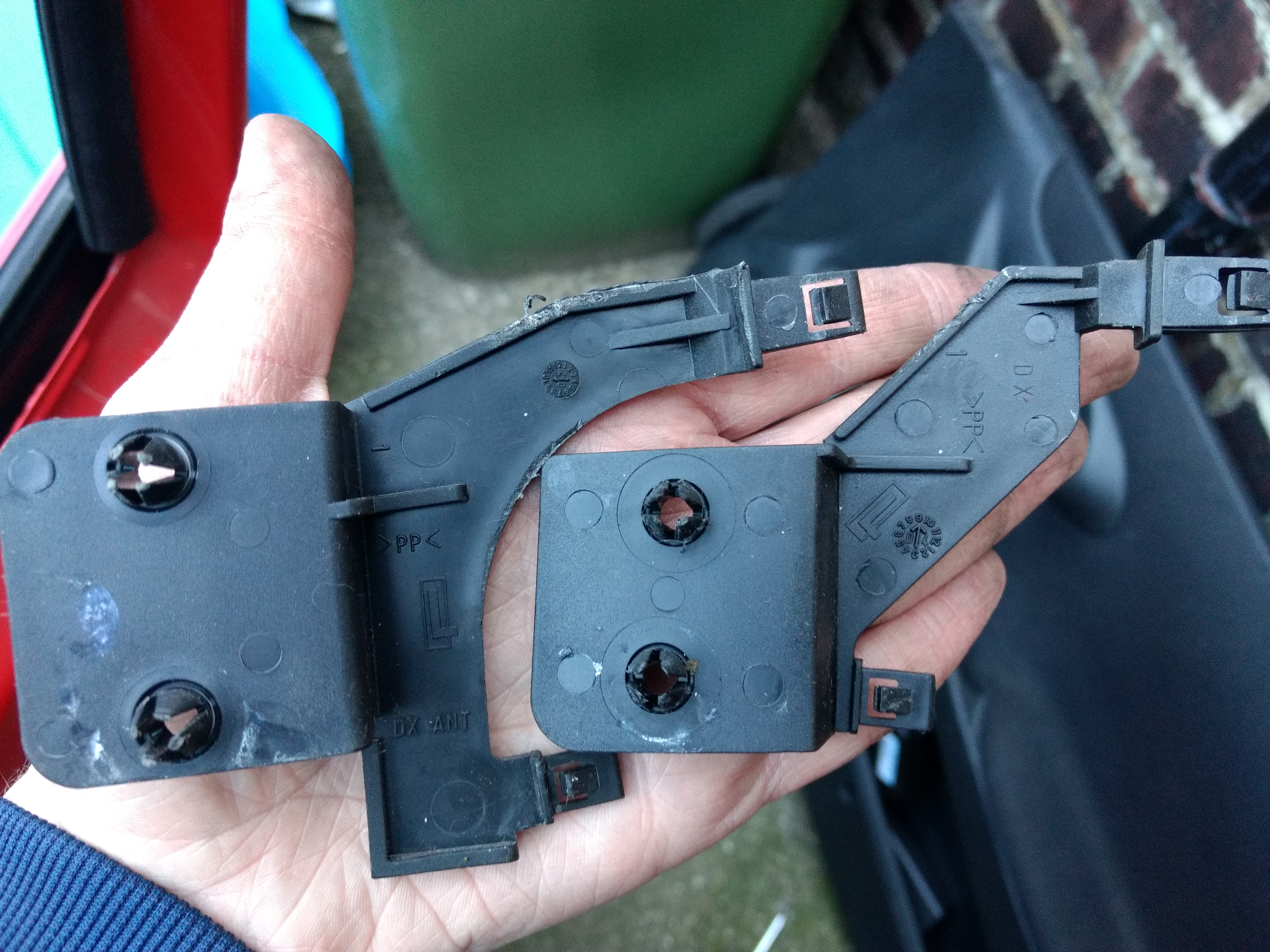

Slight issue with the replacement latch once it was in, it had a slightly different shape plastic clip into the door panel on it (see pic), think it came from a five door and I've fitted it on a three. Luckily it clips off the latch so I was able to take it all out, swap the clip, and put it back in.
Still need to get it all back together properly but the inside latch works and it locks with the key. Looks like all is well.

On the chance someone does Google 'replace Stilo door latch mechanism' or something in future, here's a summary of what I did.
Followed the window guide here https://www.fiatforum.com/stilo-guides/162743-electric-window-mechanism-relacement-images.html up to the point the glass is removed.
At this point you don't need to remove the speaker, door computer, or the window motor. I did and it was just more stuff to put back together. They're all attached to the metal panel, which does come off, so I don't think there's any harm in leaving them on.
Just under the point the internal door latch goes into the panel there are two small round plastic clips. These clips are held in place with a plastic plug, for want of a better word, pushed into the middle of each clip. Pull these plugs out with some long nose pliers and push the clips back through the panel.
Then you can take all the hex bolts off etc, the panel will come off but it's worth watching the wiring as it only has so much play. In particular the wire going into the door latch mechanism isn't very long, undo this when you have enough room to get your hand in.
The window mechanism on the other side of the panel drops lower than the panel, so you have to lift it up and out.
On the side of the door, behind a covering plug is a small torx screw, undo this and it loosens the barrel of the lock. The lock comes out away from the outside of the door, easy enough to slide in and out.
Now undo the three torx screws holding the latch mechanism in place and it comes out no problem.
