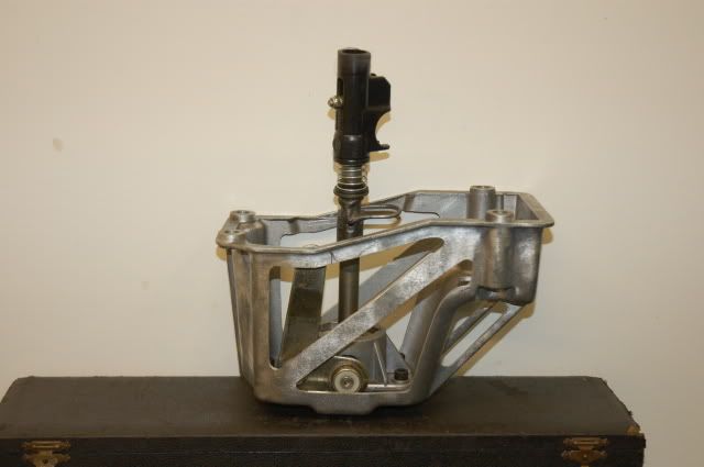

Hey guys,
Not an idea how this goes in, here is the picture:
does the rubber bit of the orginial gear stick just come off? and is the plastic shaft threaded? As the OMP adaptor are threaded inside.

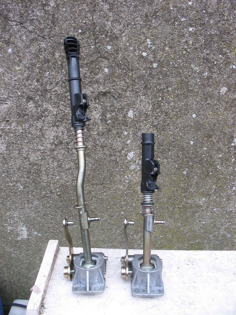

Right, what i did was cut the knob off, file the ribbed bit down and screw the adaptor on. I did it to try and get the the stick as short as possible
You can see how much plastic i left on the above picture

So, for a non sporting 1108 Sei, I simply cut off the old one at the preferred height and put the new one on.

For the majority it's by grubscrew. On the non-Sporting's you don't need the adaptor, although it's nice to have something for the top of the gaiter to fix to.
I'll found a old broken shaft, but it is broken to far down, so the golden bits of the gear shaft hits the omp nob at the top.
Does anyone see any problem, if i were to grind a bit of the gold shaft off ?
