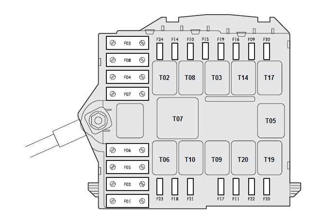

Hello, I had the same problems, cutting out with the same errors: alternator failure and loose connection.
My solution was cleaning the T9 relay (its connections) and put it back after that.
Also I cleaned all the fuses and realays from the fusebox near the battery.
Hope it works!
Hm.. good, does anybody know how to test this T9 relay to make shure it is wotking properly?
Or maybe I can swope around with any other to check? If yes with relay will be better to swap?
Relay T9 on the 1.6 engine is for the fuel pump. You could substitute it with the heater fan relay T8 for test purposes. Both are 30 Amp relays.
Hope it works!
Why do you think it was particularly T9?
Well from what I have read from the forum is that through T9 runs the electric circuit for the fuel pump and another thing that I can't remember right now, which, when the electric connection is poor or faulty throw these errors.
Also,during a long road in which my car stopped 3 times because of this I was desperate because my car wasn't starting. At that time I remembered something about the T9 relay so
first I took it out and cleand its connections with sandpaper and alcohol and put it back. No problems after.
After that, to make sure that it will not happen again, when I arrived home I took apart the fusebox and cleaned all the fuses and relays and tighten up the metal clips in the fusebox that are holding all the relays and fuses.
This was done 1,2 months ago and since then no problem.
