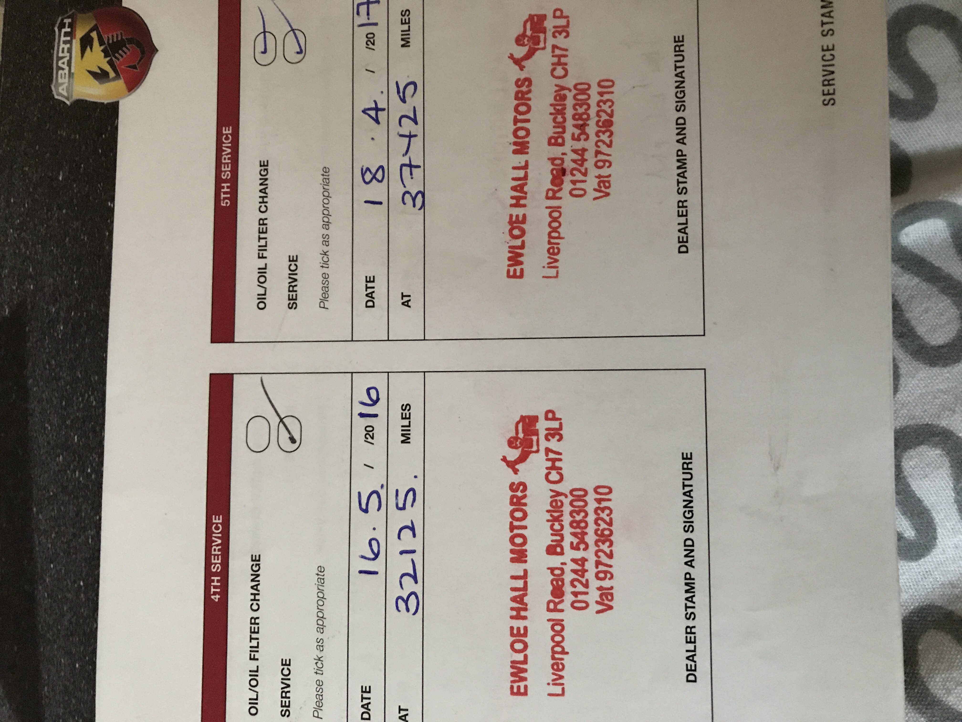

Cambelt is now priority,. Because this service book is a load of lies.

Abarth has had the past 4 services at a place called ewloe hall motors.
Look at the mileage, then look at the number 4’s..
The next page is the same place, different writing

It's quite possible the garage forgot to stamp the book so it was corrected at the next service. It's also possible (likely?) the wrong oil grade was used. Too thin will burn very quickly as I found when I first tried Mobil 1 fully synthetic in a car designed for 20w50 mineral oil.
Services could have been done, but they probably had a mobile mechanic come in. I've caught out a main dealer before. Oil changes only is what previous owner got as a service plan. Thankfully bits missed were easily sorted. If doing low mileage get car serviced every 6 months and keep paperwork in a binder. Fiat/Abarth dealers can do fixed price low mileage service. Which hopefully would have correct Selenia oil. Main dealers can have fixed price cam belt changes too. With a guarantee, which is all you can do.
