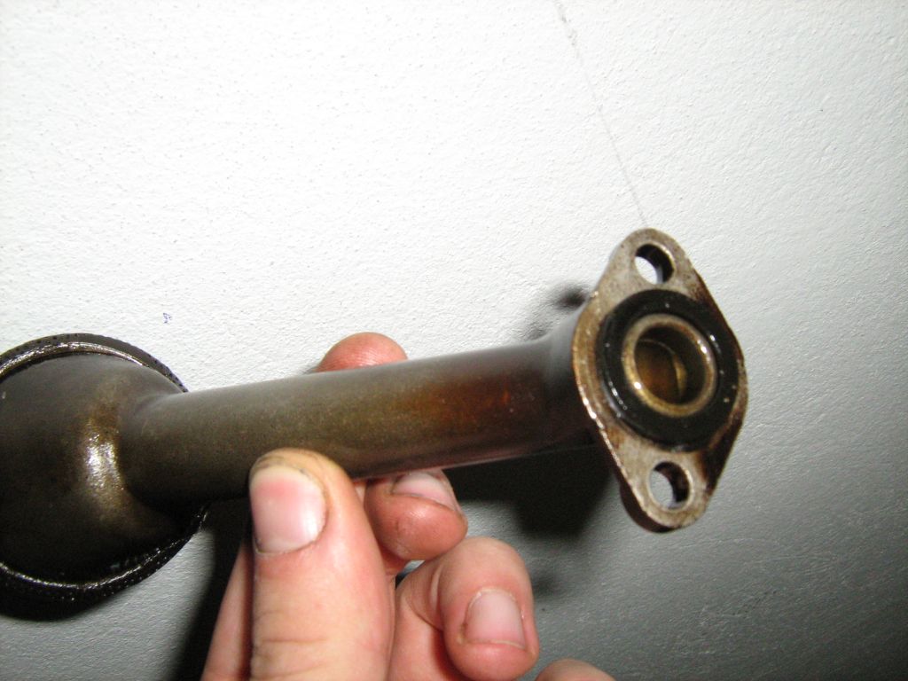

I have a little different problem with a FIRE engine. When you start it from cold there is no oil pressure, you can wait on idle for 10 seconds or more but light doesn't come off until you rev it up a little. After reving it up oil pressure light goes off and it doesn't turn on anymore. When engine is warm, it works like new, but when you start it, there is a lot of rattling until oil pressure builds up.
Engine is having pressure problems for a long time - 50.000km or more, but only at start-up. I worry because it's getting worse and worse with every start-up, especially in last few months (maybe because it's winter).
Oil level is on top, oil has 14.000km and it was last changed in summer (Selenia gold). I don't want to put fresh oil in engine until I solve the problem wih oil pressure or replace the engine.
I replaced oil and filter, but it didn't help at all. It seems to me that all oil from pump, filter etc. gets back into sump over night. When engine is hot there is no problem with oil pressure and engine works like new without any knocking.
I have spare oil pump, should I replace it? Is there any non-return valve in pump that may be broken?
I think I found a problem :slayer:. Seal at picture is hard and not sealing at all, so when you turn engine off air gets inside and oil leaks out from tubing between pump and sump.

No, it is completly clean, but I was thinking the same thing before I took the sump off.
Thanks, I have spare oil pump, but I hope it was only the seal. I've just put sump back on, now I'm waiting silicone to dry, then I will start it and see.
When engine is hot there isn't any noticable knocing or rattling and oil pressure is OK at idle (no warning light). I think if there was a problem with pump or bearings it would get worse when engine heats up and oil gets thinner.
At first startup light came off after 2 or 3 seconds (no oil in pump). At second startup after sitting several hours light went off immediatly :)
Problem was because oil pump was rather sucking air through the seal instead of thick oil from the sump.
It was the seal between pickup strainer and oil pump, you can see it here https://www.fiatforum.com/uno/159792-...ml#post1881076

I don't know yet if it leaks or not. I cleaned off old sealant and then used alcohol to remove any oil. Then I put silicone on sump, waited for 20 minutes, put it on, wery lightly tightened the screws, waited for another 30 minutes and tightened them as they should be. Then I waited over night for silicone to dry. One hour is not nearly enough (or because it was cold here).
I did some more testing. Problem is not completly solved, but it's much better than before. When I turn hot engine off (fan kicking in) and then start it again after several hours it takes 3 seconds until warning light disappears at idle. If I turn off cold egine and start it again after some hours, light goes away immediatly.

I didn't remove oil pump, as I thought the only problem was the seal on attached pictue :eek:. I will take it off one day in spring, now it's a little too cold for work like this. And as I said, it's much better than before and I'm not worried any more :). Before it was critical - light didn't go off at all until I revved engine up at ~1500rpm. Then it went off after ~5-7 seconds.
