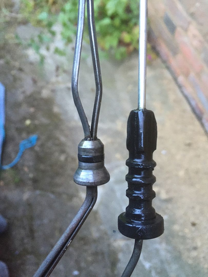

Ok as I was venturing out to check something for Peter. I checked the 126 dipstick and it doesn't fit.
What seems to be the key to holding the dipstick nice and tight is the width of the bow in the two halves of the dipstick. As it pushes home you can feel it gripping against the inside of the crankcase. The "O" in reality doesn't have much to do with holding the dipstick it is more to provide a seal.
The 500 one in the picture below, is my 500 one and it fits really tightly and requires a little bit of effort to pull it out. If the bowed part on your dipstick isn't as wide, try opening it out a bit.

What seems to be the key to holding the dipstick nice and tight is the width of the bow in the two halves of the dipstick. As it pushes home you can feel it gripping against the inside of the crankcase. The "O" in reality doesn't have much to do with holding the dipstick it is more to provide a seal. If the bowed part on your dipstick isn't as wide, try opening it out a bit.
