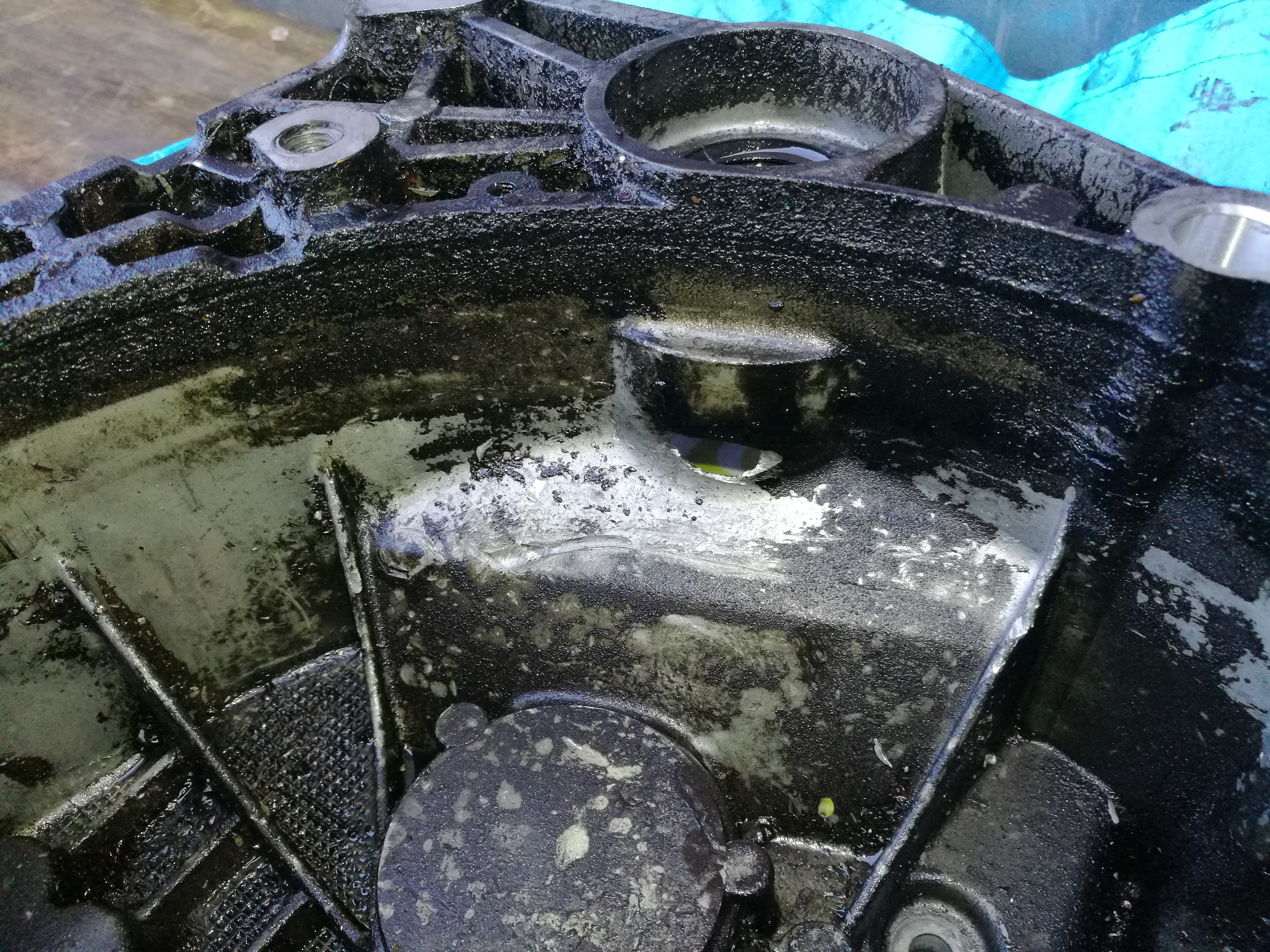

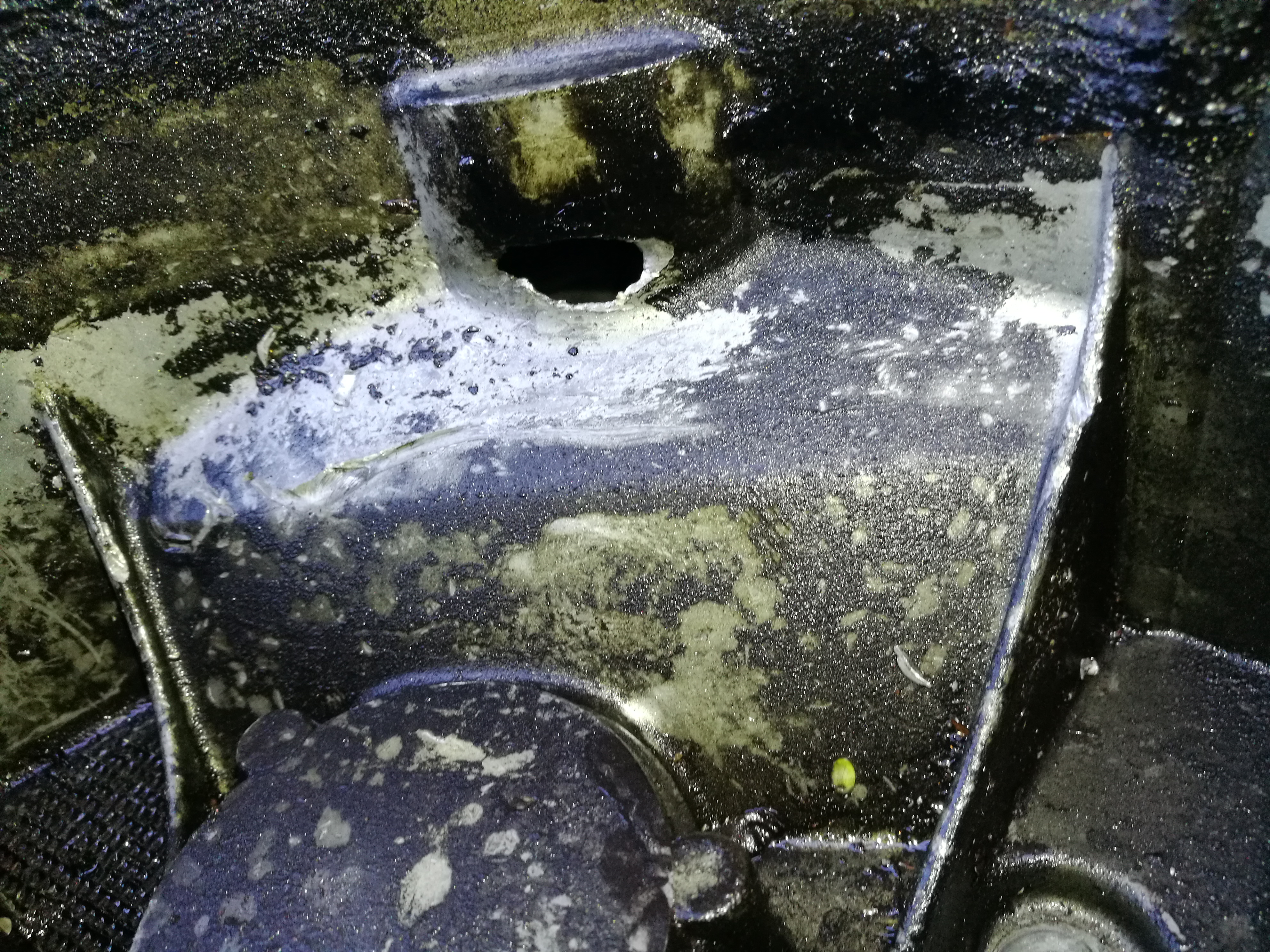

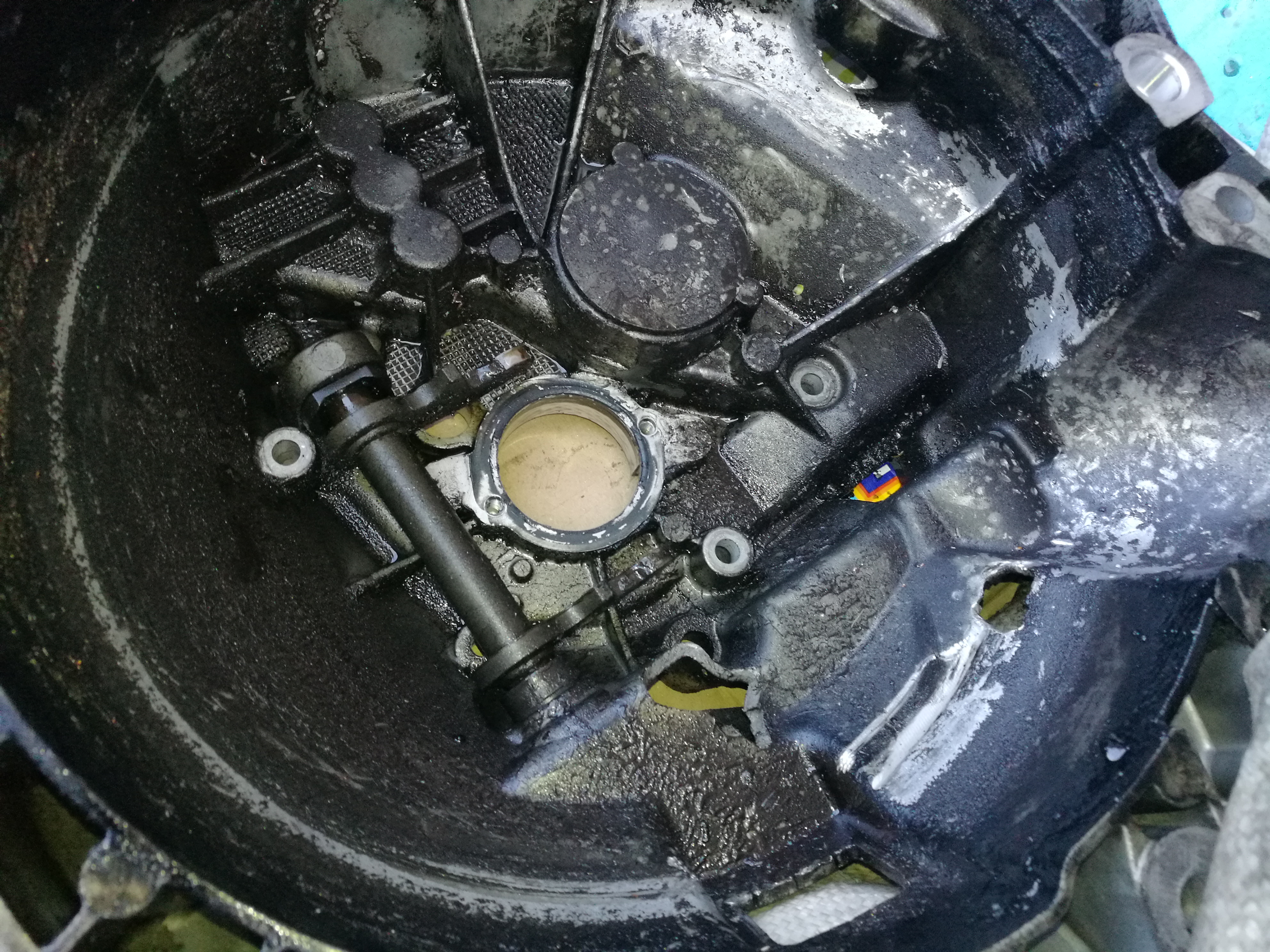

Finally sorted the gearbox out. Here are pics of the holes in the old one
WOW! Can't think of anything else much to say - except thanks for posting the pictures.
Didn't you hear anything? Something has obviously gone a few rounds with the flywheel/clutch cover assembly. Could well have been a bolt or large nut as you say dropped when the starter was changed?
Well I see in the picture that the timing window in the top of the bell housing does not have it's rectangular rubber plug in place.
If that has been missing during normal motoring use then it is the only and most likely entry point for FOD (foreign object debris) into the mixing machine. The mass of the flywheel and strong clutch cover plate steel (3mm+ thick and shaped/formed for strength) would certainly bash the hell out of the fragile gearbox alloy material.
