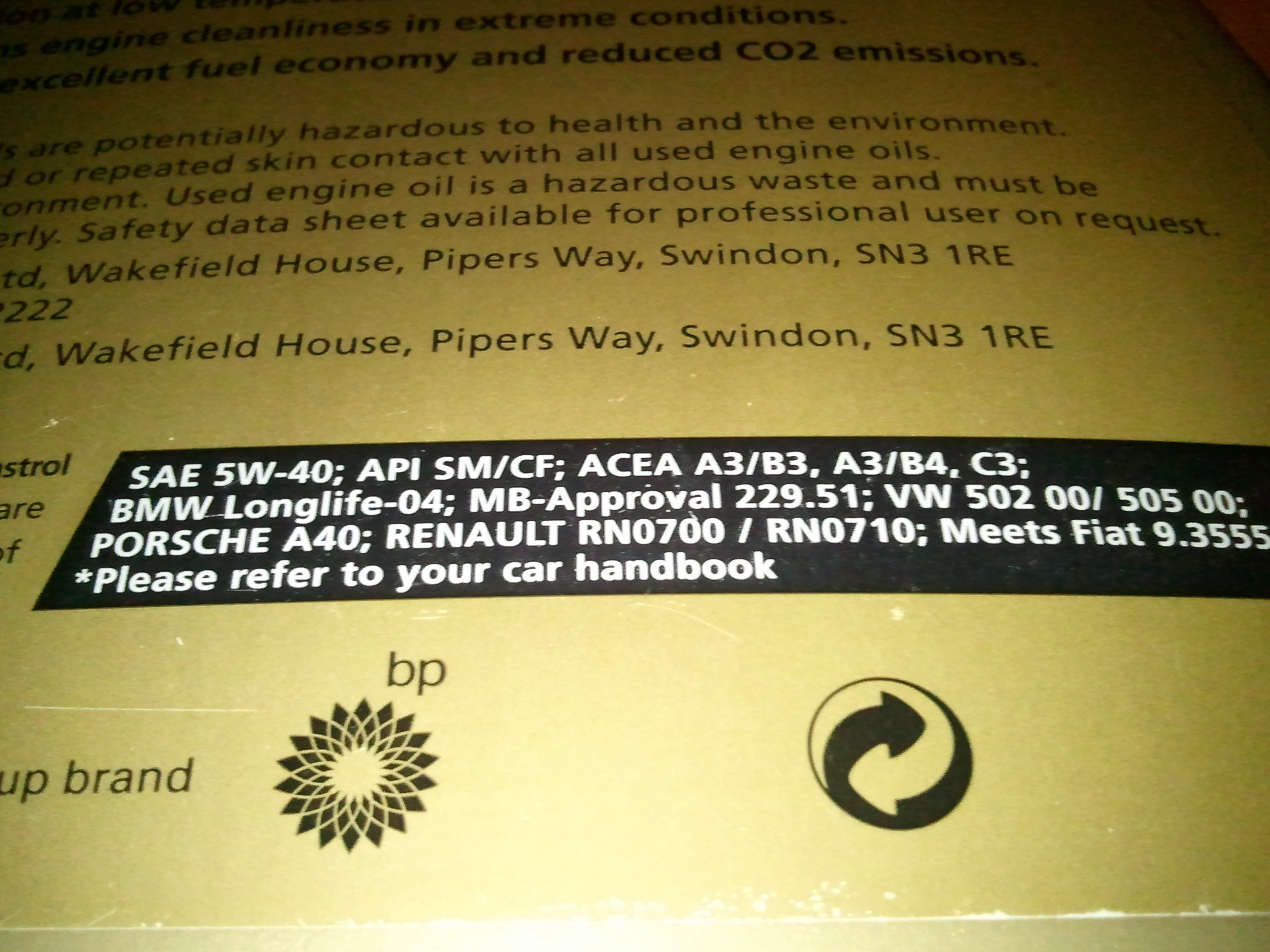

As mentioned previously Castrol Edge is C3 spec :)

That Castrol Edge is NOT C3 spec, it is A3/B4 just the same (and equally "unsuitable" as the Total oil used by the Fiat garage mentioned previously.
It is marketed as an "equivalent" where C3 is recommended or specified.

If you actually look at the specifications you'll see that it's a C3 oil....
I draw your attention to -> https://www.fiatforum.com/attachment.php?attachmentid=96413&d=1321911832 also......
