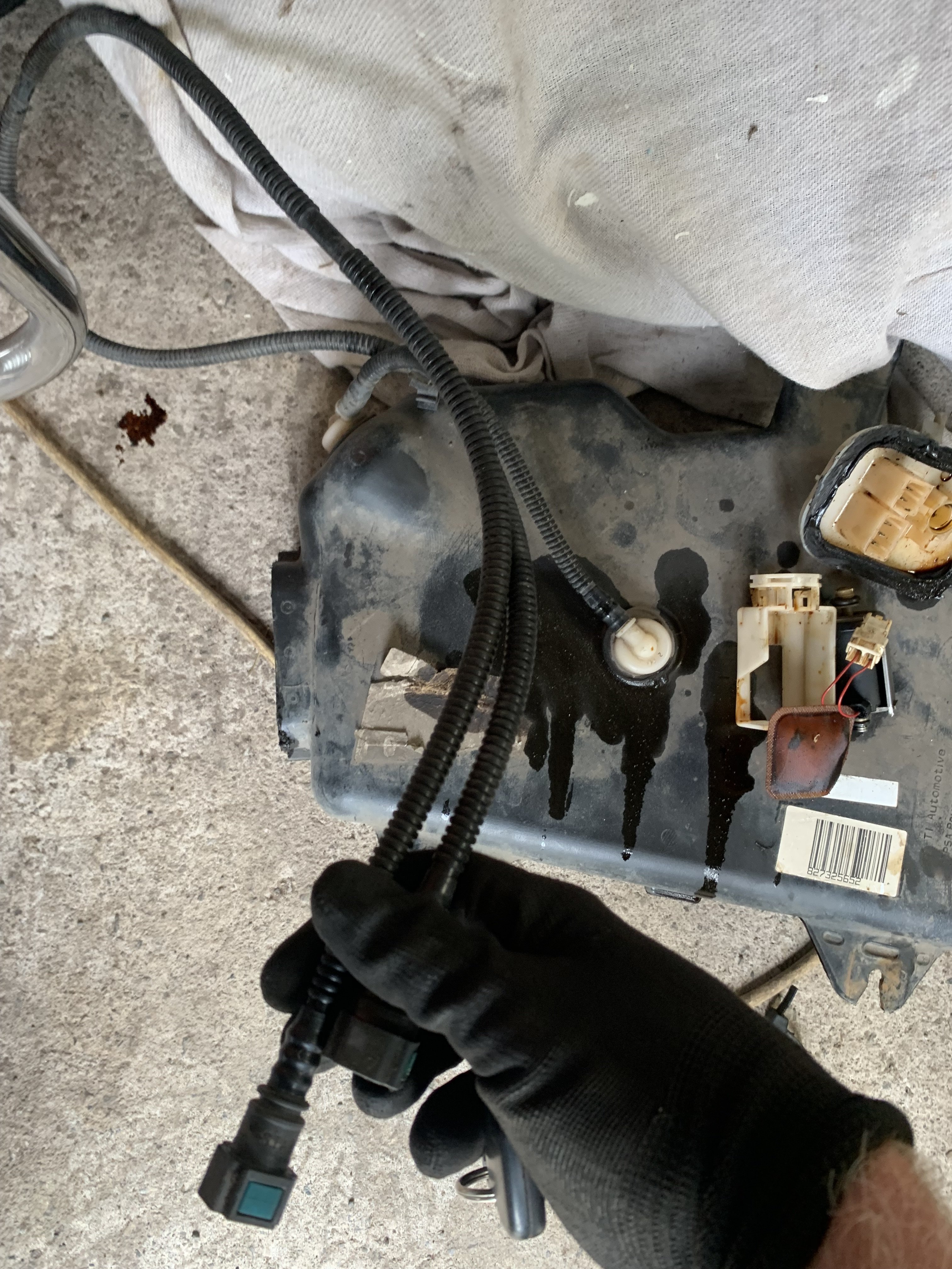

G gsc1ugs Member Joined May 6, 2005 Messages 225 Points 102 Jun 16, 2025 #1 Does anyone know what this is called and what it does? Need another its been scraping on floor Attachments IMG_7889.jpeg 1.2 MB · Views: 65

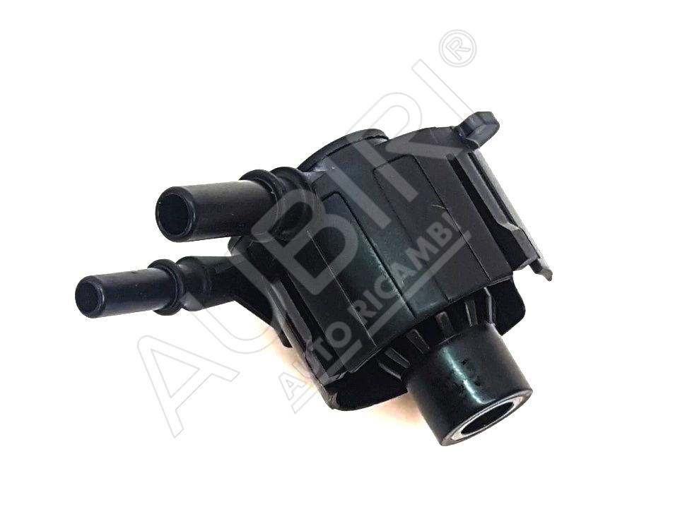

OP OP G gsc1ugs Member Joined May 6, 2005 Messages 225 Points 102 Jun 17, 2025 #2 Well its called the pipe end and its £75 what it does ive no idea Pipe end of FAP additive tank Fiat Scudo Attachments pipe-end-of-fap-additive-tank-fiat-scudo-jumpy-expert-since-2007-1-6-2-0d.jpg 58.5 KB · Views: 38

OP OP G gsc1ugs Member Joined May 6, 2005 Messages 225 Points 102 Jun 17, 2025 #4 So if i connect both these pipes it should cancel it out?
Z ZaphodB Established member Joined Jan 30, 2025 Messages 1,247 Points 492 Location Lancashire Jun 17, 2025 #5 gsc1ugs said: So if i connect both these pipes it should cancel it out? View attachment 469019 Click to expand... In what way "cancel it out" ? The EOYLS system ?, that's coded into the ECU
OP OP G gsc1ugs Member Joined May 6, 2005 Messages 225 Points 102 Jun 17, 2025 #6 Just that plastic piece, i believe its for filling but that can be done down the pipes
Z ZaphodB Established member Joined Jan 30, 2025 Messages 1,247 Points 492 Location Lancashire Jun 17, 2025 #7 gsc1ugs said: Just that plastic piece, i believe its for filling but that can be done down the pipes Click to expand... Ahh right gotcha ReferenceDesignation"a"Fuel additive filling inlet"b"breather"c"breather"d"Outlet to fuel additive injection valve(12)Filling union (by the Customer Services)(13)Filling union (at the factory)(14)Fuel additive pump (1283) As far as I see it, one of the pipes is a breather (c) and the other is the "customer services" filling (12)
OP OP G gsc1ugs Member Joined May 6, 2005 Messages 225 Points 102 Jun 17, 2025 #8 I see to let air in, i get it
Z ZaphodB Established member Joined Jan 30, 2025 Messages 1,247 Points 492 Location Lancashire Jun 17, 2025 #9 gsc1ugs said: I see to let air in, i get it Click to expand... and/or out That's all assuming that diagram is the same layout as yours, but it does look just like it
OP OP G gsc1ugs Member Joined May 6, 2005 Messages 225 Points 102 Jun 17, 2025 #10 No my tank isn't like that mines pictured above
Z ZaphodB Established member Joined Jan 30, 2025 Messages 1,247 Points 492 Location Lancashire Jun 17, 2025 #11 gsc1ugs said: No my tank isn't like that mines pictured above Click to expand... Well I know that, it was the dangling part I was meaning that looks the same , what shall we call it the filling device, the .... the ..... pipe end Last edited: Jun 17, 2025
