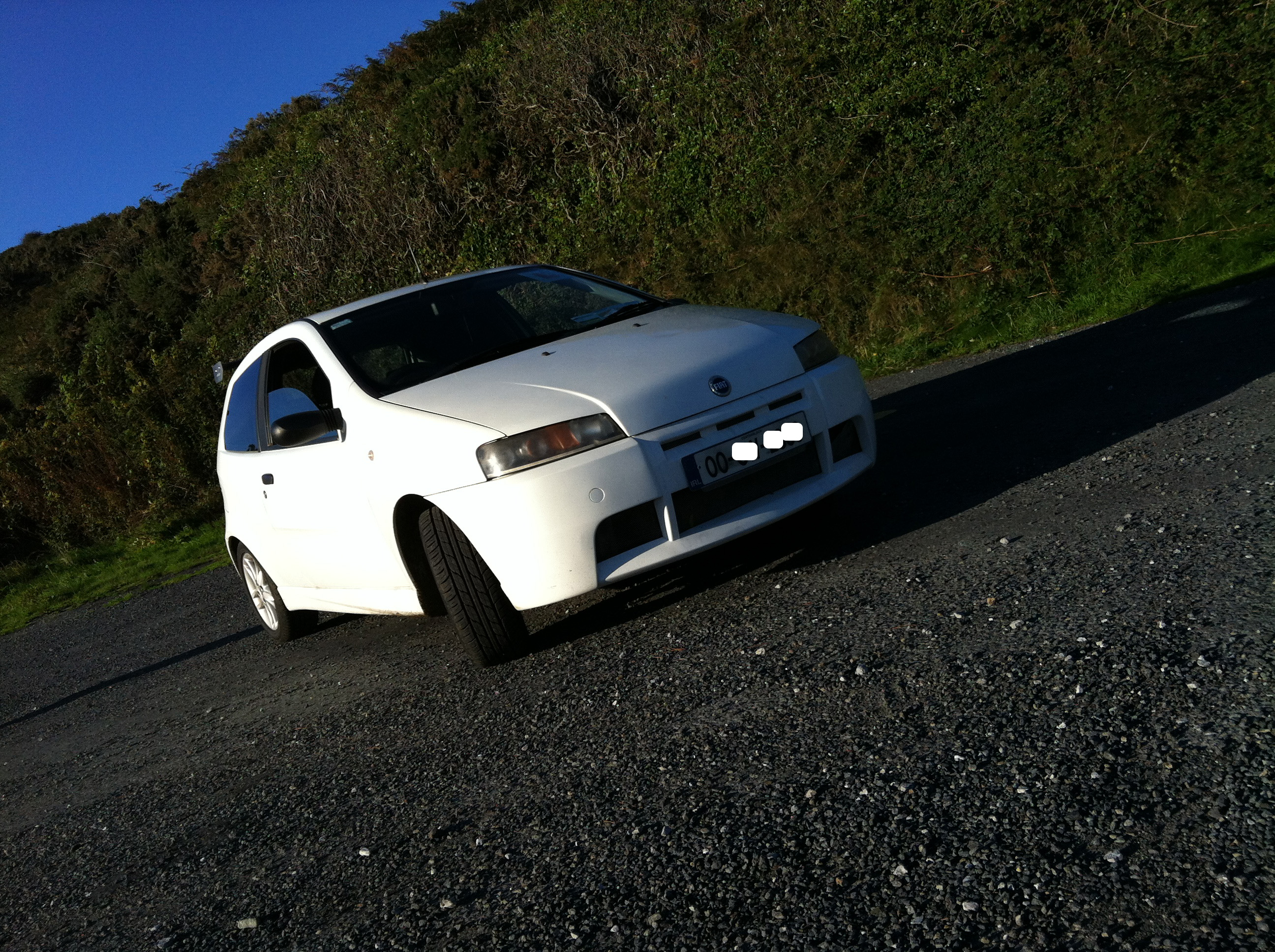

Ooh its white is it? I like white puntos, just like mine.
Yeps, they really finish it off, it's just the front and back bumper but it really makes a difference. I have got a dodgy rear spoiler though and can't take it off. You get used to it though and it's not bad for a first car.
