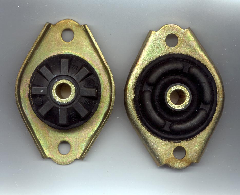

I had totally new suspension (see https://www.fiatforum.com/showthread.php?t=24793)
This sorted one squeak – but has caused others – Maybe go for new Upper shock Mounts as the temp one I fitted squeaked before it ripped.

As for the rear suspension squeaking, it could be the rubber bushes in the trailing arms, shock absorbers or shock absorber top mounts. Sometimes squirting WD40 onto the bushes can help, but also check the rubber top mounts for the rear shocks. These mount onto the inner wheel arch and can be seen when you remove the plastic covers from within the boot. These mounts have a habit of breaking up!
