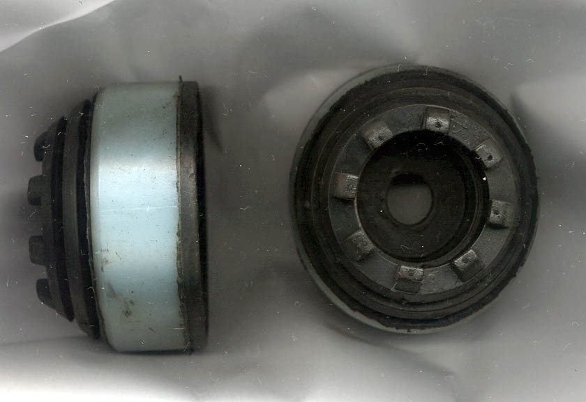

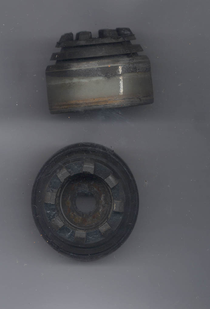

£271.13 + Upper Mountains all fitted.
Hi All,
I now have the JAMEX SPORTSLINE 35 MM lowering kit fitted. It is close to £320 total – with front Strut Brace and Upper Strut Mountains it will be a little over…. But the original quote didn’t include these parts or extra fitting.
OK it’s a day or two late, that was only a combination of Language barrier (We don’t speak Dutch - yet;) ), and me not being avail yesterday afternoon.
I didn’t manage to make it over to the camera shop yesterday, hopefully by the end of today…
Ill post another thread about the strut brace soon!
:cool: Any way big thanks to Martin at http://www.racepartsmanchester.co.uk and all at Supper West. I’m impressed with their finish!
Old and new upper mounts are attached,Edit: Old Ones to left.

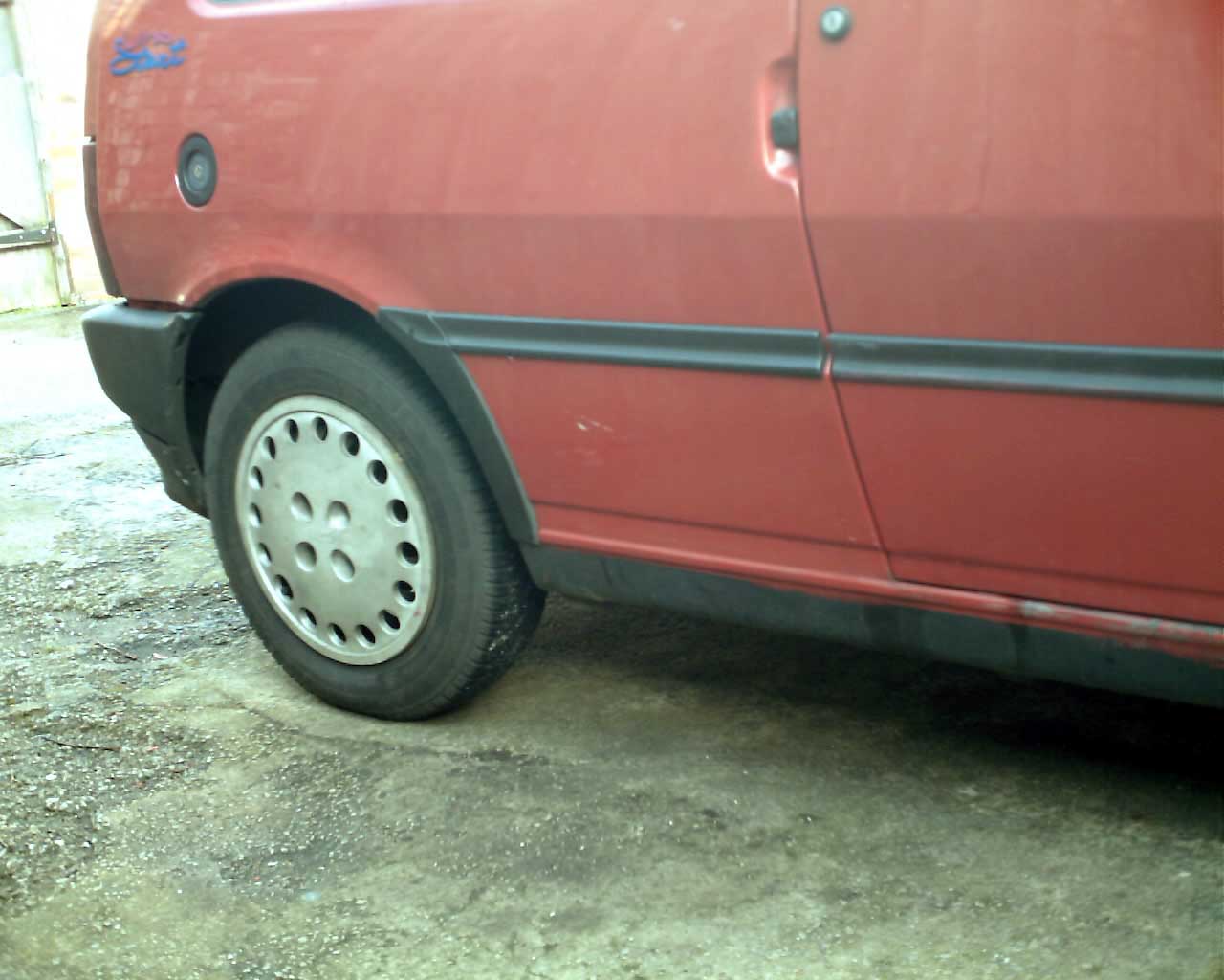

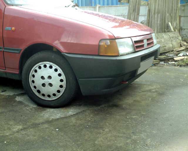

New Camera!
Hi All,
I Finally have a digital cam - at last :eek:
I had a nice drive to the shop yesterday! I love the new ride!
She still clears all the usual speed bumps now wi added grace :). The massive bonus is the CD player skips a lot less now :cool:.
So this is what my lowered Uno looks like today
