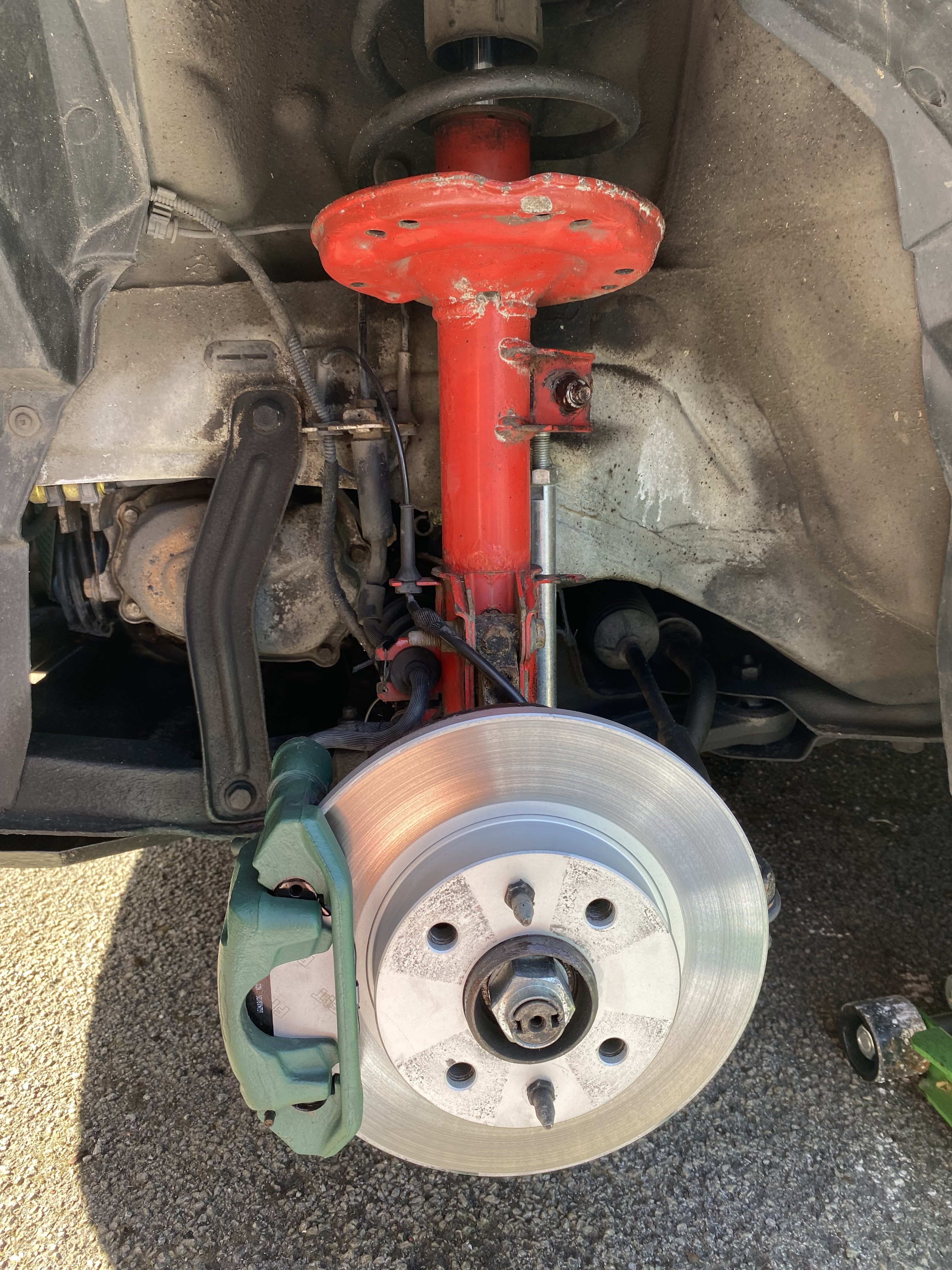

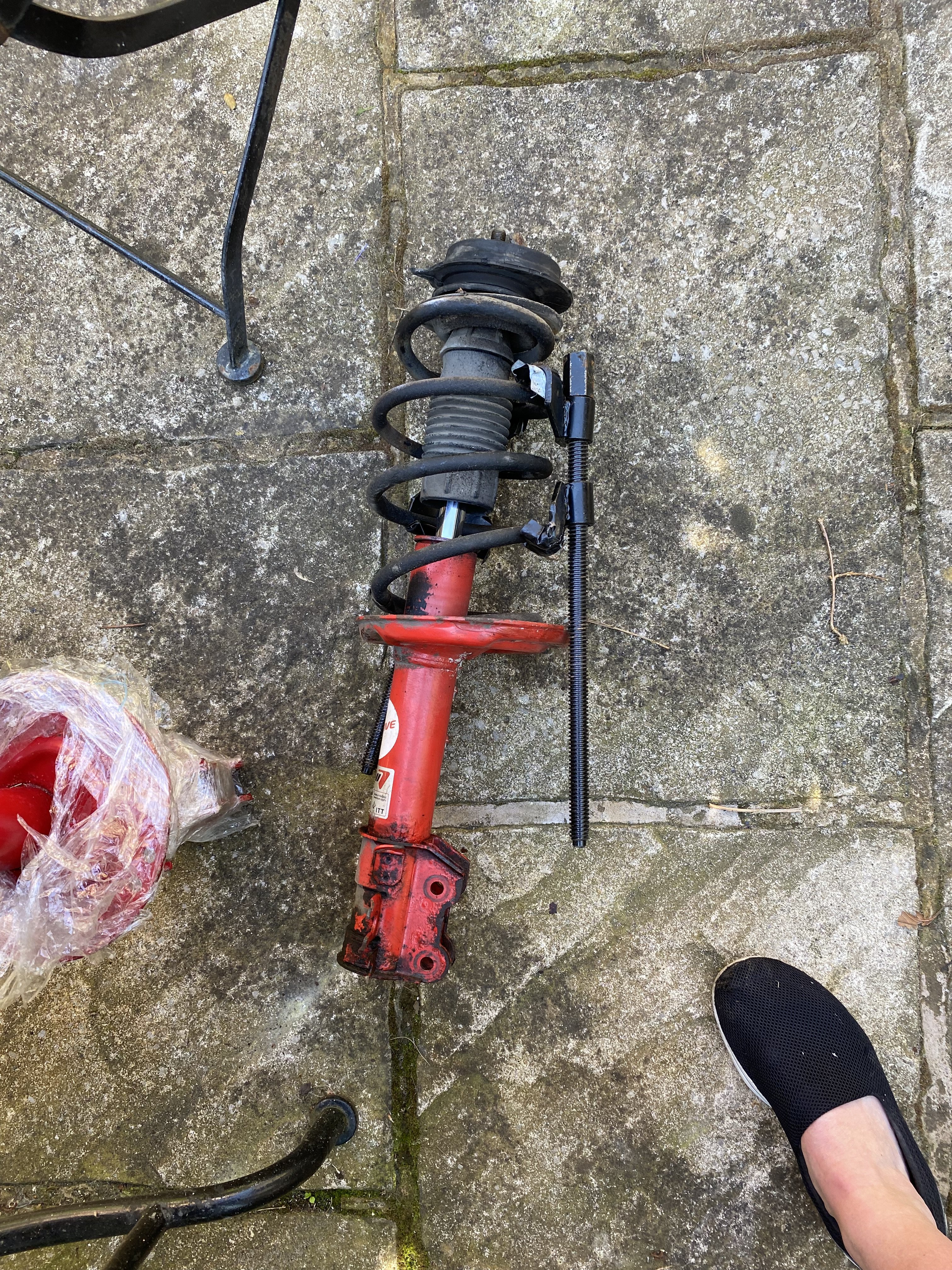

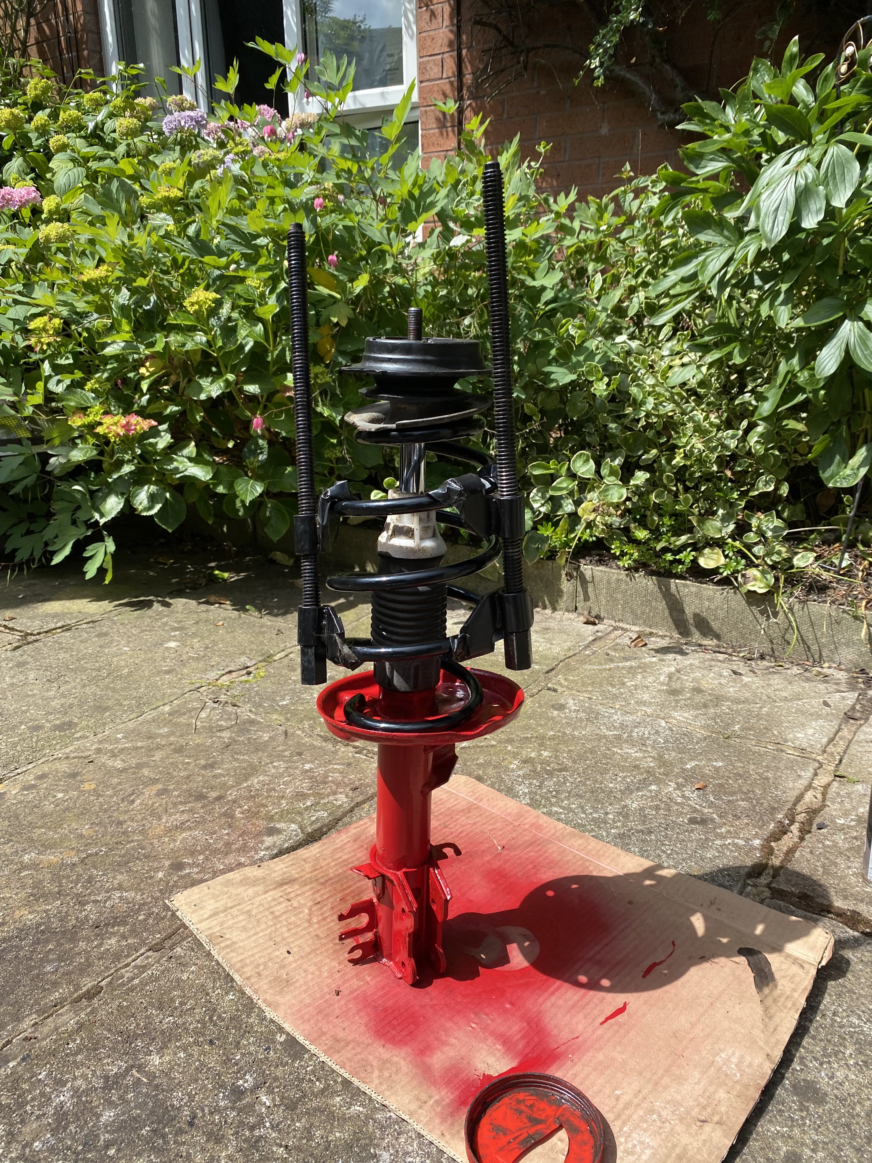

Did both my front struts yesterday…. New springs & top mounts a de rust and spray of my struts and my car once again feels sweet!
My konis have suffered from the great weather we have … but I’ve done my best to give them extra life!
I’ve new tie rod ends to fit then off for an alignment

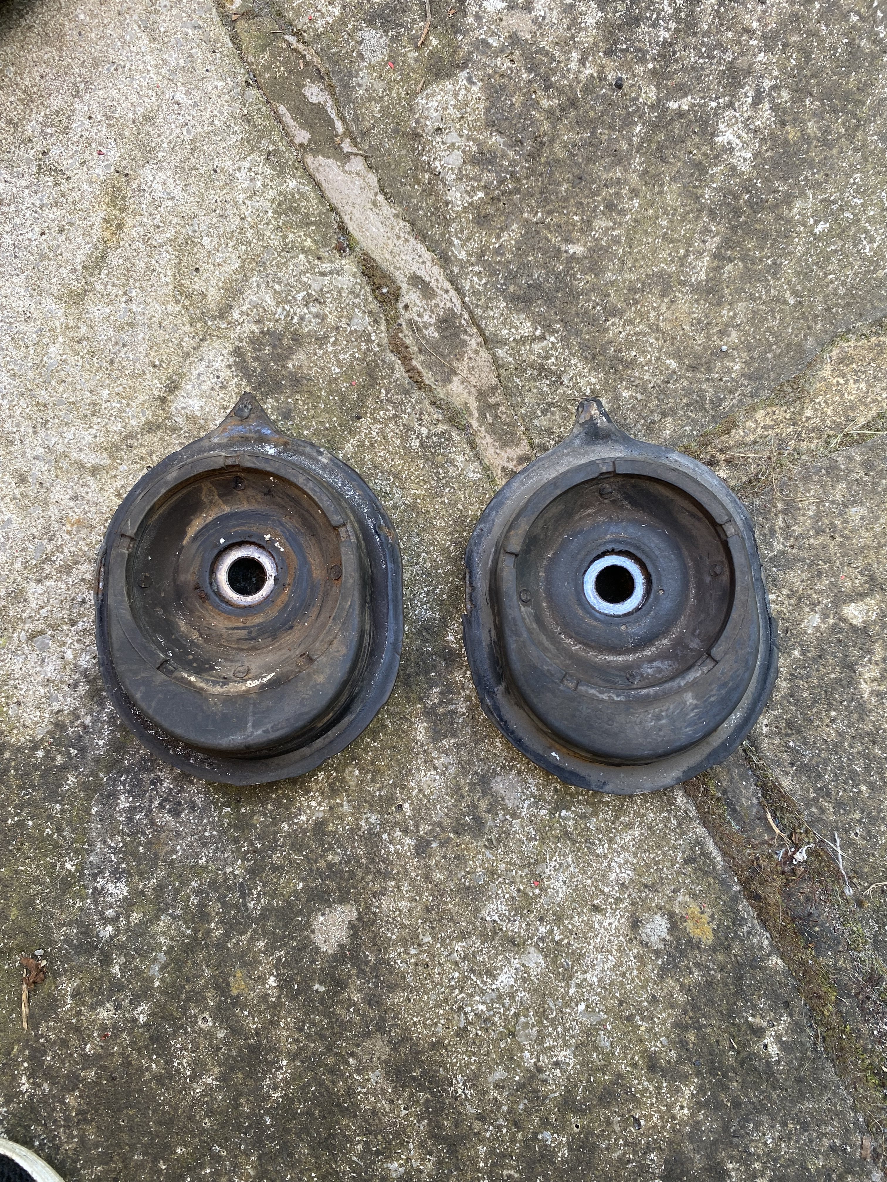

The top mounts I took out were like a babies rattle and the rubber was starting to go the springs were both rusty!
This time I went for better for both!
