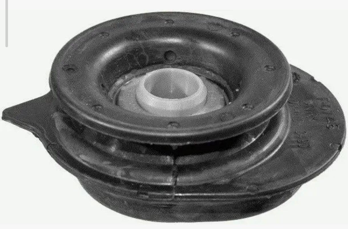

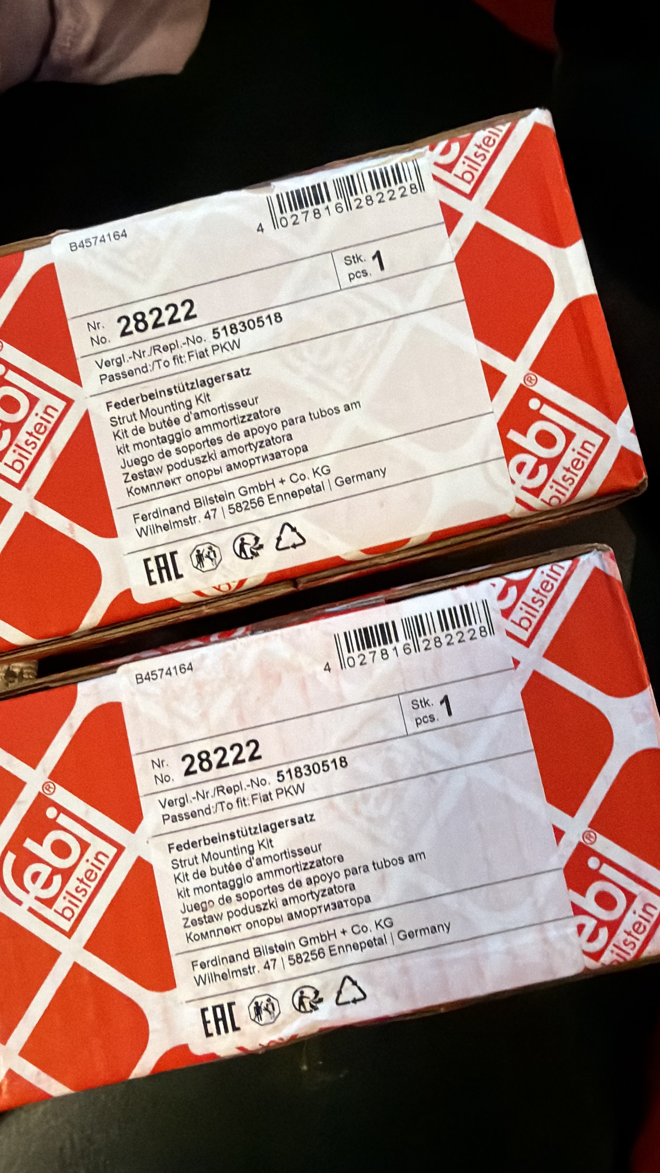

I recently bought the ‘cheapest of them all’ adjustable suspension kit for my 500. However, I wish I had read the additional information in the description.
The strut rod has a width of 14mm, but the new strut mount bearing I bought (Febi Bilstein 28222, strut mounting with ball bearing) has a diameter of 12mm. Since the top nuts (and washers?) will also be 12mm in diameter, I’m concerned about compatibility.
Has anyone encountered this issue before? If so, how did you resolve it? I’m quite pressed for time, as the suspension kit should be ready for installation later this afternoon. 🥲
I know I should have opted for the more expensive suspension kits. However, due to circumstances, I’m now driving this emergency backup car daily over the winter. And yes, this was even a cheaper option than regular aftermarket shock struts front-rear and the springs. I definitely needed to replace the strut bearing/mount, as these are likely the main cause of this issue.
Also, the link rod on the passenger side still needs to be replaced. The driver’s side was done this summer, but at what cost? My mental health for sure.
So, any advice on how to prepare this kit combo for fitting my 500 would be greatly appreciated.

Wow, you really amazed me! 😁
I think you just got the wrong part and you need to exchange it for the correct part.
Ther is ePER link here on forum, you can enter your VIN number there and select yor car, then search for parts number. That way, you'll get the compatible part, even if cheaper, other make.
Fiat does this. Put different sized parts to the same model. If you jump to first part you find, you need to be really lucky for it to be the correct one.

It does mention that the OE strut mounts require modification. The bearing I purchased is a complete one, including the rubber top mount, all in one piece with a 12mm inner dimension.
It is pretty shocking a company can make this product and claim compatibility, but say modification will be needed and provide no instructions. Luckily someone else has always been there before. See the attached picture.

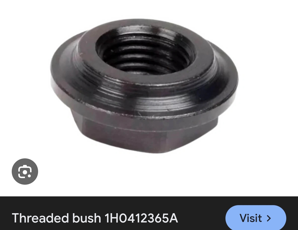

Pull the metal bearing piece out of the mount, it comes out easy, and install bearing part from MK4 VW Golf PT no. 1J0412249
If you have access to Febi parts it's 01111.
You will need the M14 spacer bush from VW as well to hold the top mount onto the strut, and you will possibly have to widen the hole in the top cup to fit as well.
Job done!👍
