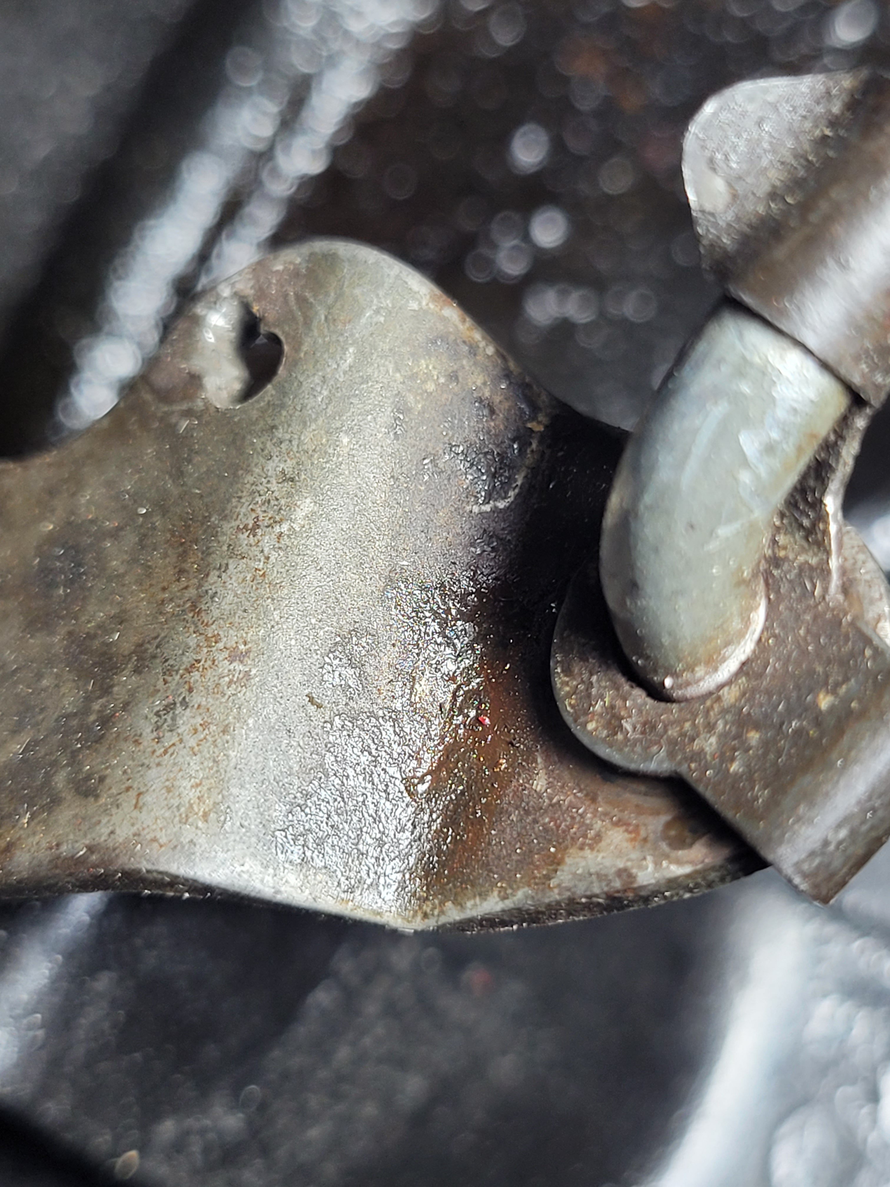

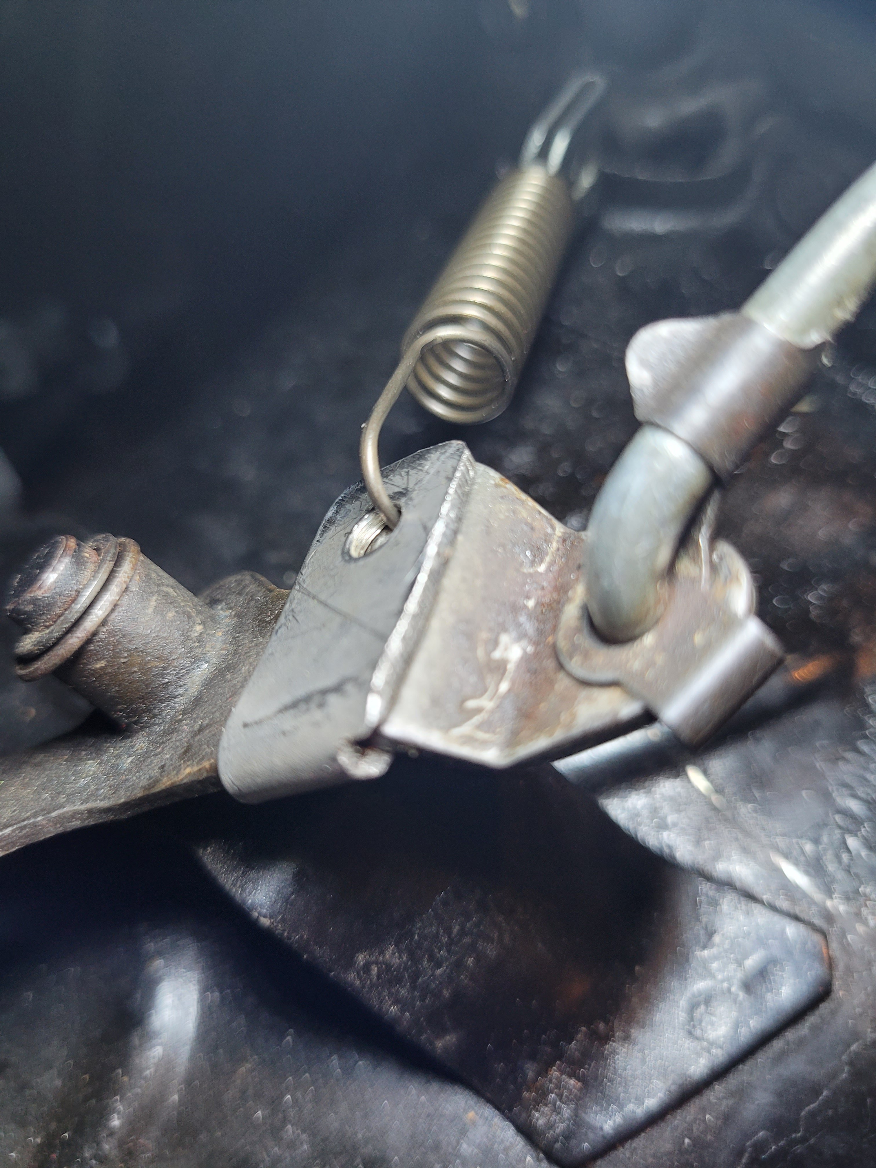

The other day I was driving back from a small meeting and suddenly I found the accelerator pedal wasn't returning when taking my foot off. It turned out the return spring had broken. Looking at the carburettor end of the cable, I also found that the hole in the lever had worn away - not right through like the mount at that other end did a couple of years ago (see here) but like then, I made a little tab up to provide a more secure mounting for the new spring.View attachment 447838
Iirc, that type of excessive wear at the spring attachment point can be caused by the spring vibrating - on some cars, the spring can even be seen (or felt with your fingertips if lightly touched) to vibrate or shake at certain engine revs.
Fiat fitted rubber dampers inside the spring on some models to overcome this problem (iirc, I first saw these dampers inside carb. throttle return springs on the Fiat 131 circa 1978?). It was just a short length of round rubber moulding, whose size was tight enough not to fall out but loose enough not to interfere with spring extension and retraction.
On other makes of car, I've seen a short length of rubber sleeving fitted over some of the spring coils - this looked like a short length of electrical 'heatshrink' tubing without being heat-shrunk.
Some (Japanese?) carburettors have little plastic/nylon bushes fitted in the holes where springs are attached.
