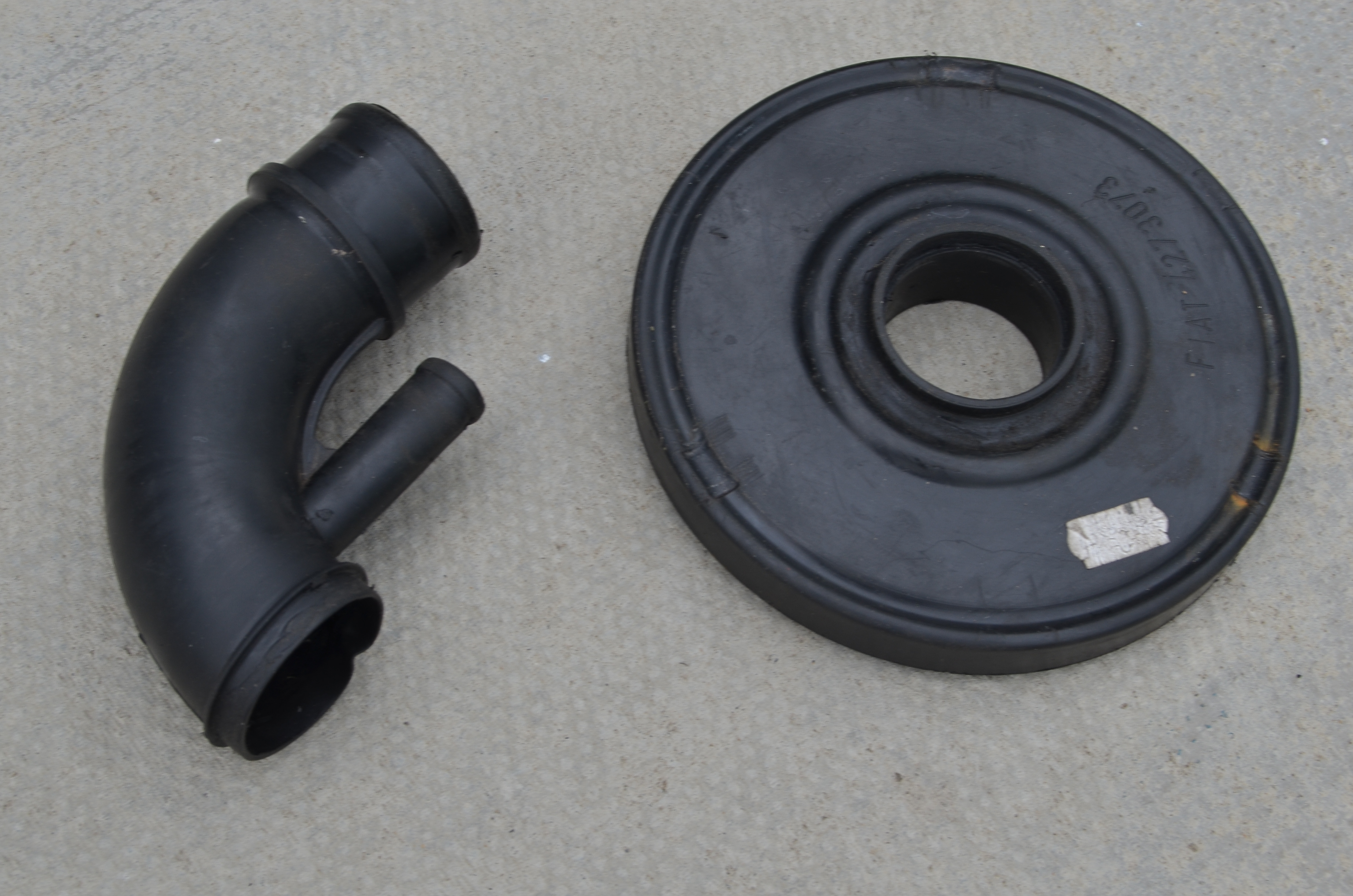

OK, plastic air filter lid and replacement breather hose now in place.
The metal lid was really giving way in places - see the pic of holes rusted through on the edge plus one small hole starting in the centre.
The breather hose was also in a right state - not sure if it was originally intended for the 500; it looks the right shape but the end seems to have been torn off and the inside diameter is so big that it was just held in place by the shape of the hose. The new hose doesn't have any clips but pictures I've seen of other engine bays also don;t seem to have them and they are probably not essential since the hose was a bit of a force fit (boiling water over the ends before fitting helped make it easier) and there's about 5cm of hose on each fitting.
Also fitted a clip to replace the missing one on the main pipe from the lid to the engine, so now hopefully everything will stay in place nicely.
I'll keep an eye on how the plastic lid does.
