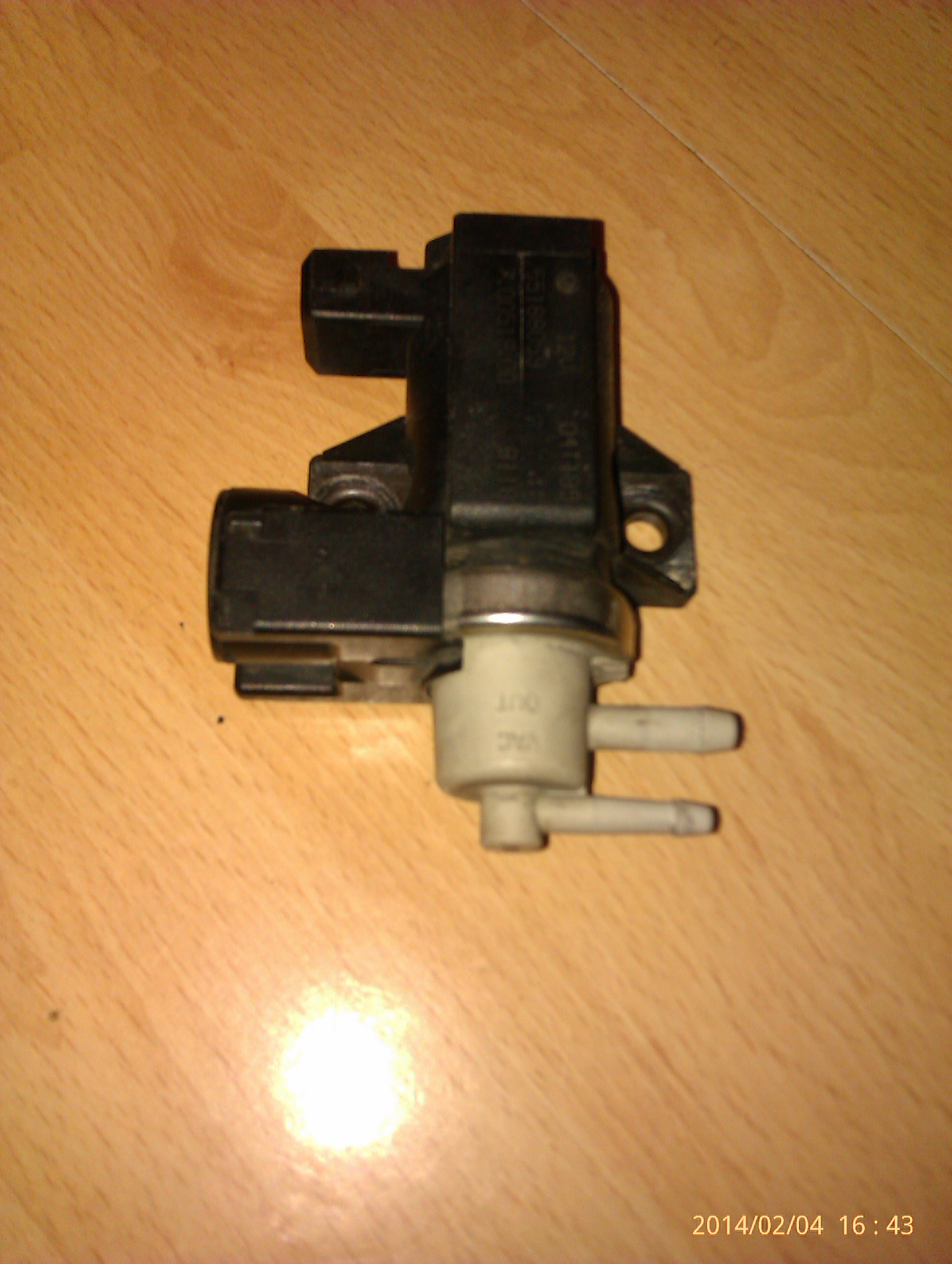

I've just had this issue with my 2004 1.9jtd. Turned out to be the boost control valve. I had blanked the EGR off last year (best thing I ever did) so I knew it wasn't that. Normally if EGR is stuck the car will run rough at low revs. I spent a lot of time searching on here for advice, and finally got the car sorted. I was quoted £160+vat+delivery for the new part. I got a second hand one of off fleabay for £10 delivered. It is from an alfa romao 147 but fits just fine. It's worth checking all of the tubes for splits etc. What I did was to disconnect the vaccuum pipe from the boost valve and connect it directly to the red pipe that runs to the turbo actuator. When I did this with the engine running I could see the actuator moving therefore I deduced that the valve must be faulty. As there was a voltage at the terminal it must have been a mechanical failure. I did run the car for a very short time like this and it was fine however it was running at max boost all the time. I am in no way mechanical I haven't touched any tools since I owned a VW camper. But I didn't fancy leaving it with a garage again who couldn't guarentee afix but who would still charge like a wounded rhino. In the end fixed for £10 and a few hours getting mucky.
If you need some photos to help locate parts I am more than happy to do that. The attached is a picture of the boost control valve that was replaced.
