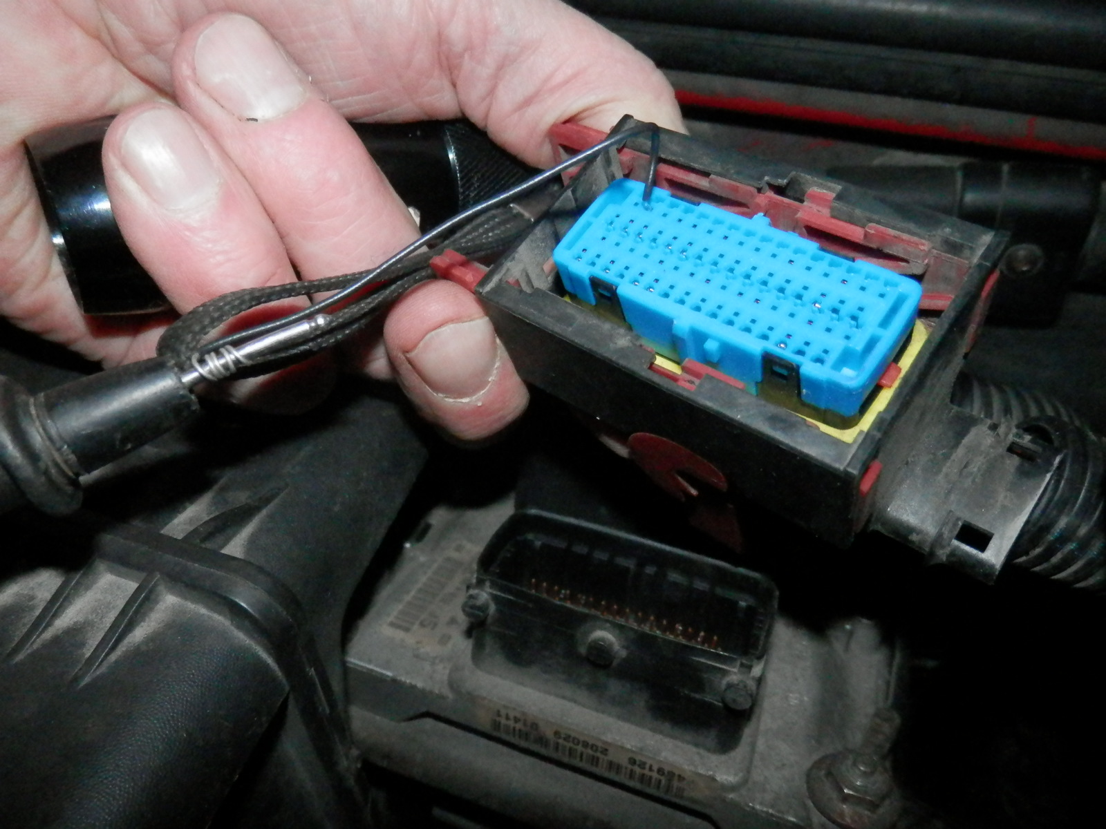

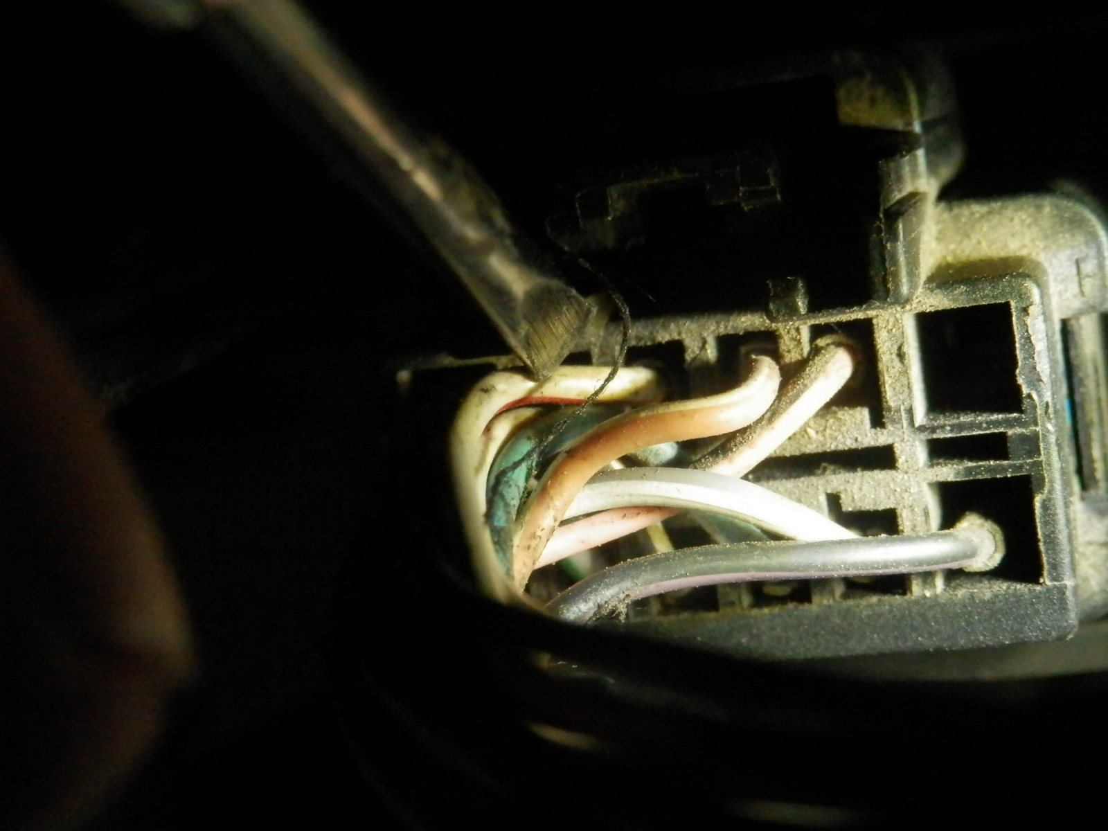

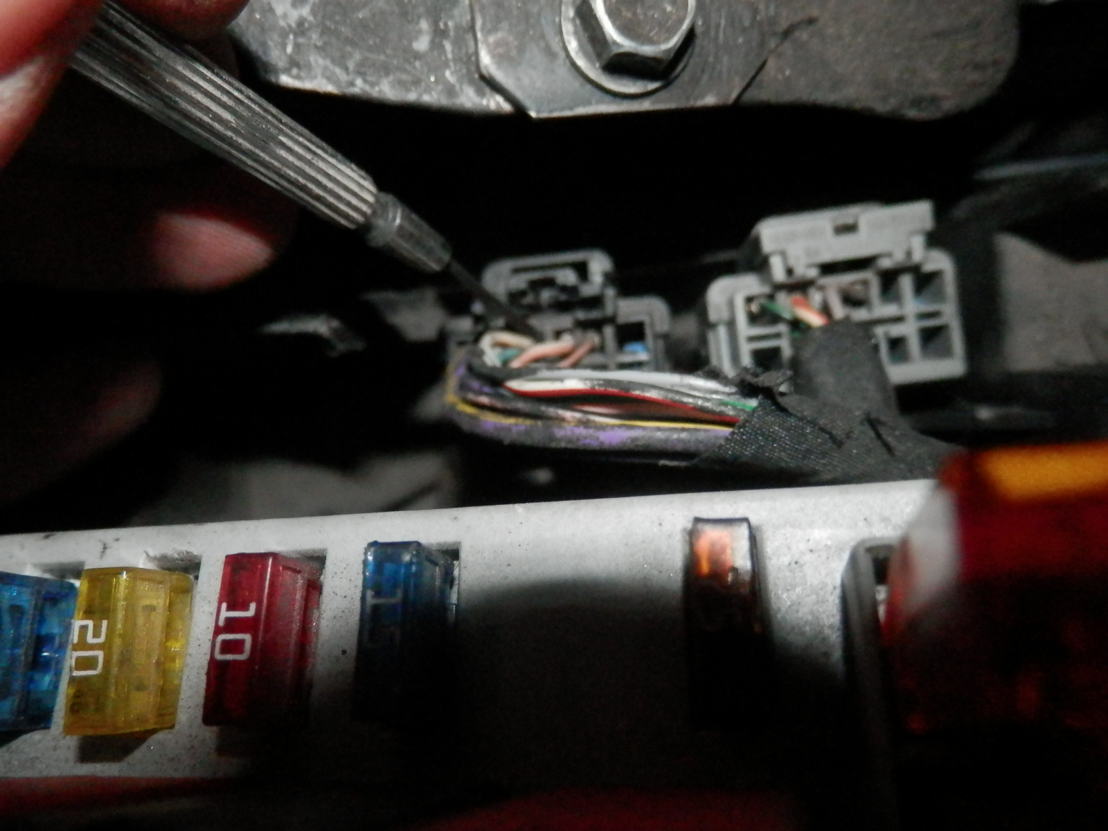

I did some digging around................first via google and then confirming my car fits the ME73H4 information available.
Here are some photos of the K-line diagnostic wire which multiecuscan is using to get the engine information. The wire is white with a red stripe. The K-line wire is at battery voltage or pulses at that voltage so you need to be careful with your test wires.
It is on pin 2 on the engine ECU plug nearest the radiator and then goes thru to pin 7 on the obd2 plug.
This wire must be on a relay in the body computer because when the engine fuse box plugs are unconnected there is no connection between the OBD2 plug at pin 7 on the body computer and the connector next to the battery. The k-line wire is going from the engine via the connector without otherwise going thru the engine fuse box components.

More fiddling..................
https://canlogger1000.csselectronic...ink-16-Pin-Out-J1962-Explained-What-Is_v2.png
If I connect pins 16 4 and 7 from the OBD2 port to my OBD2 cable I can use multiecuscan to detect my engine ECU
If I then take the laptop to the engine with the obd2cable I can connect 16 to battery positive, 4 to battery negative and 7 to the white and red wire on the connector I highlighted before and detect my engine ECU.
But maybe this is getting too complicated? The fiat OBD2 socket uses 7 for the engine and other pins for the other ECU. If I disconnect the engine ECU plugs I can detect the airbag and ABS. ABS is on pin 1 airbag on pin 3?
