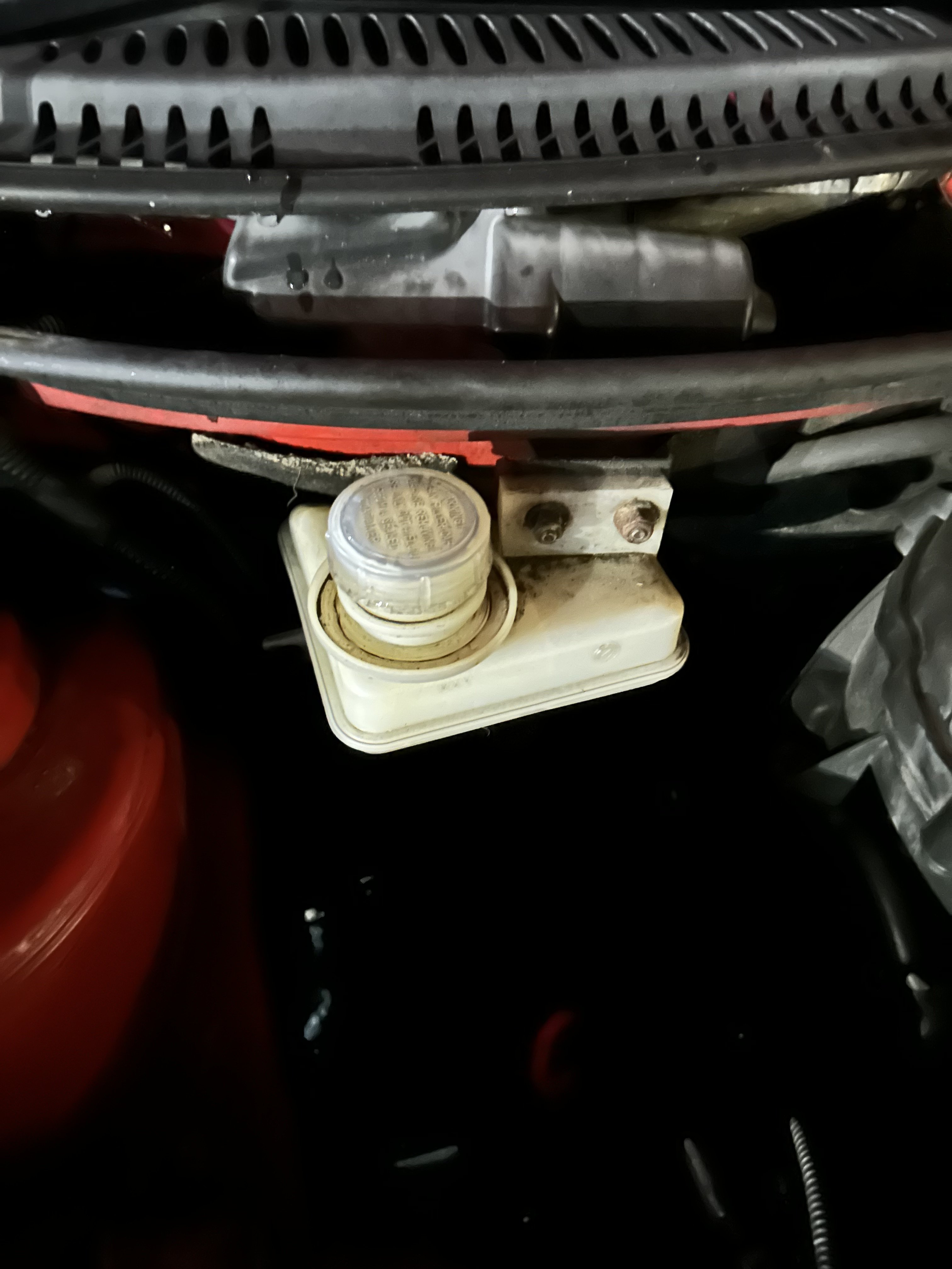

I’ll try to explain the best I can. So basically there’s a tiny tube before the actual reservoir. At the bottom of the tube there’s some sort of filter which I assume is for keeping dirt out. But when I fill the tube up and wait it doesn’t seem to go down at all? Does it take a while to filter down or is something blocking it?
Thanks in advance
Woou, its clear what you are describing now. But such system is uncommon for fiat to my knowledge. I am adding 2 pictures, taken few min ago on fiat punto mk2, 188A5000. The system you described is usually found on Ford fiesta for example... Which car exactly do you have? Anyway, this aside, you have to somehow get your fluid from the upper smaller Reservoir to go trough the tube down into the smaller,.. it happens that it doesnt go, because appearently you have such small tube that while the fluid is trying to go down the air cant go up. The worst slowest case is to try put few drops and shake it a little until they get into lower main Reservoir. If its going so hard i would expect a bleeder screw on main Reservoir - you unscrew that one, so the inner air could escspe from it, and pour your fluid in the top one and now should go down to main one, and put the bleeding screw back... But i have to say, i never seen this trouble before. Out of curiousity, can you take a picture of your two fluid tanks?

I would agree a picture from the original poster would be helpful. Having had mk1, mk2, and mk2b Puntos, all the brake masters are essentially the same. If he has the same as in the pictures supplied by mcf1mnfs, then all he has to do is remove the filter before filling - otherwise the fluid will take an eternity to flow through.
Here’s some images guys. So inside the tube you can see the filter but it doesn’t seem to filter through
You can put your finger in and pull the filter out. Then top it up. WITH THE CORRECT FLUID.
On another note, can you see the electrical connector underneath the tank? If so, unplug it and check if the light goes off. If it does go out then you know it’s because the brake fluid is low
All sorted! Didn’t actually know you could remove the filter I just assumed it was part of the tube. 🙄 anyways I removed the filter and topped up the reservoir and the light has now vanished! Thank god for that so thank you all for your help and input!
