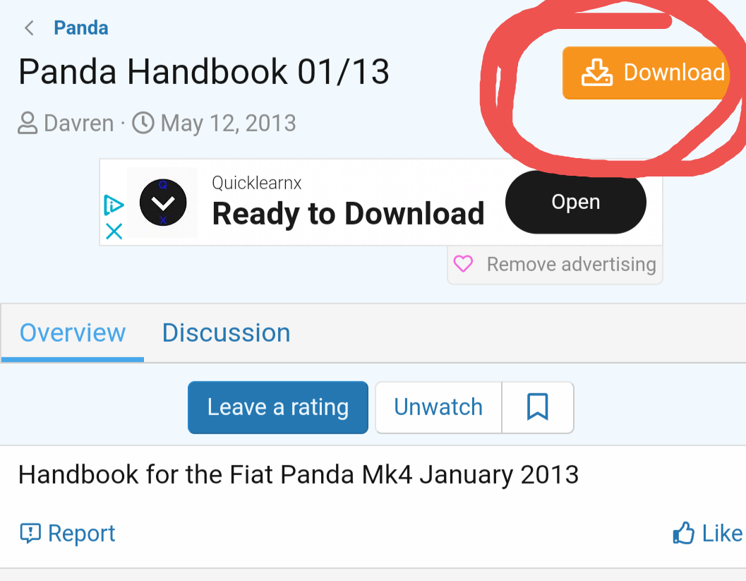

We have a download section with the handbook
The download button is top right
