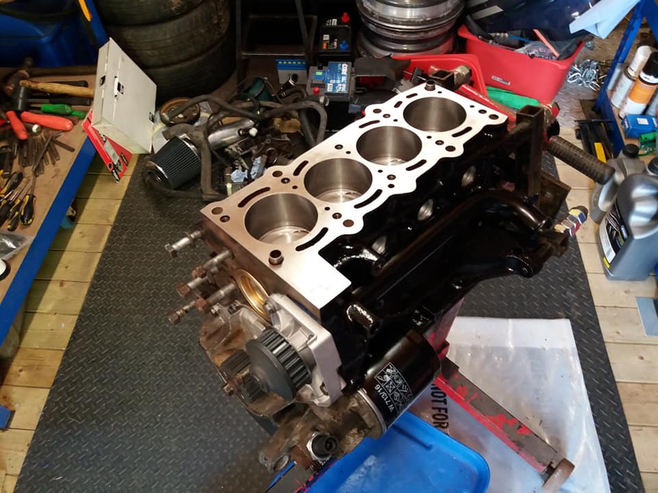

i am not 100% sure if it definitely originating from the headgasket at the moment until i take some bits off to investigate.
its definitely oil and it is very minimal, its not running down the block, literally a slight sheen along the joint. things like leaks rarely get better so wanted to ask the question.
i cannot find any other leaks from further up at the moment. there arent that many places it can come from that arent easily accessible.
the main area that it seems to be around is the centre front which is where the oil pressure feed channel is up to the head.
the engine was spotless when fitting and the block was painted. ive never had any issues with leaks before on other engines. as i had seen the issue before on the old engine i wondered if it was a common thing?

Looks sauceh! :D
I would trust your own work... if you had that block, clean as it is, and you fitted a new, good quality gasket, and then torqued it down like the book says with the correct number of torques in there, then it *must* be sealing okay. On the other hand... that may be called "denial".. :D
I would just wipe it off and see if, when and where it comes back from. I was for a long time chasing a "rocker cover leak" only to eventually track it down to the camshaft seal.. so the oil can turn up from any random place and then just thin out and spread very thinly over the surface, miles away from where it's actually sweating from.
The good news is that some leaks just disappear (if there's just some residual oil working its way out of some nook or cranny) or they seal themselves, once crud sticks to the leak.. or they can just keep seeping mist for years and you can never track it down, it never gets worse and it never goes away. Joy! :D
