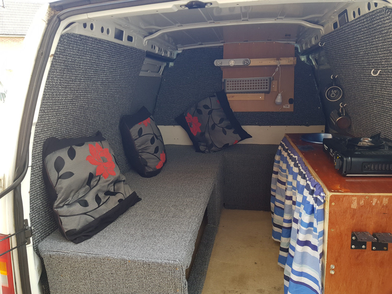

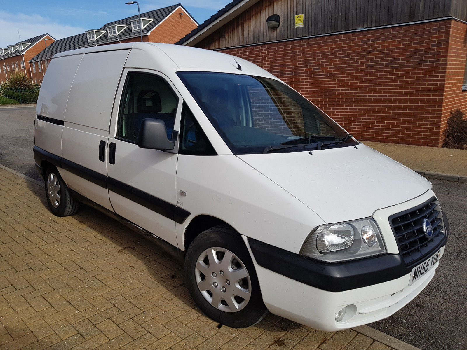

Hi thanks for reply. I Barnsley S. Yorks. A couple pics to show what's been done. This is how I bought it. Also got the usual "Speedo not Working" problem. I am also going to remove the front bulk head for more room
