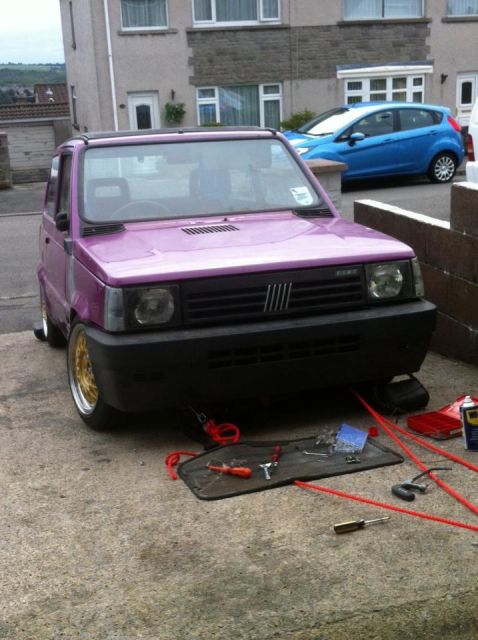

There was a guy on here a while back who made a REALLY low Panda, I just can't remember his name or anything else that would allow me to dig out the posts!
Oh! I might know the guy you're on about. Is it Chris, the guy with the Colour edition who lowered his? Attached a picture of it...
If it is (and even if it's not), here's a link, flick through the pages and you'll see him talking about the suspension somewhere (y) https://www.fiatforum.com/members-motors/345096-chriss-1994-panda-colour-resto-mod-9.html
