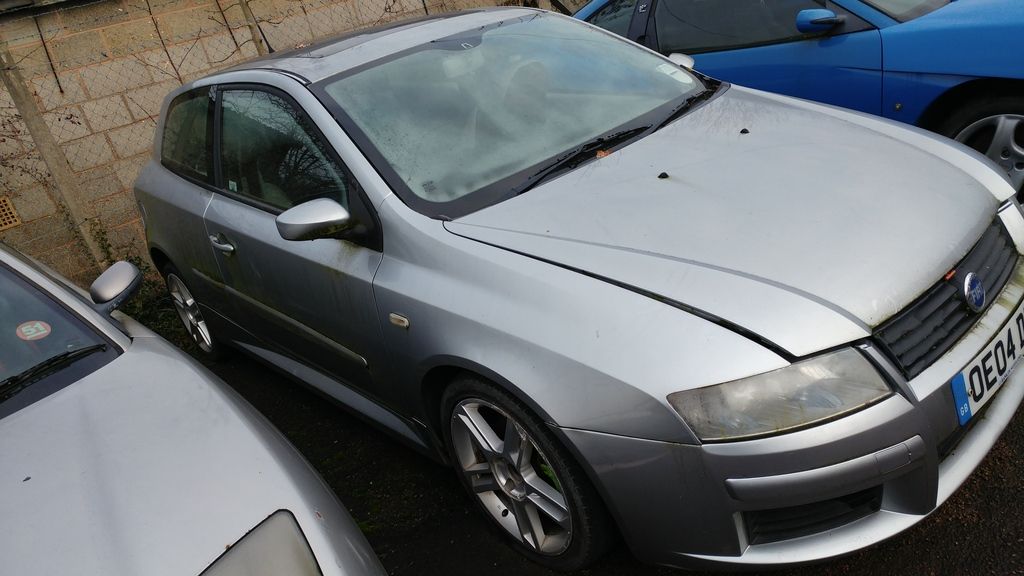

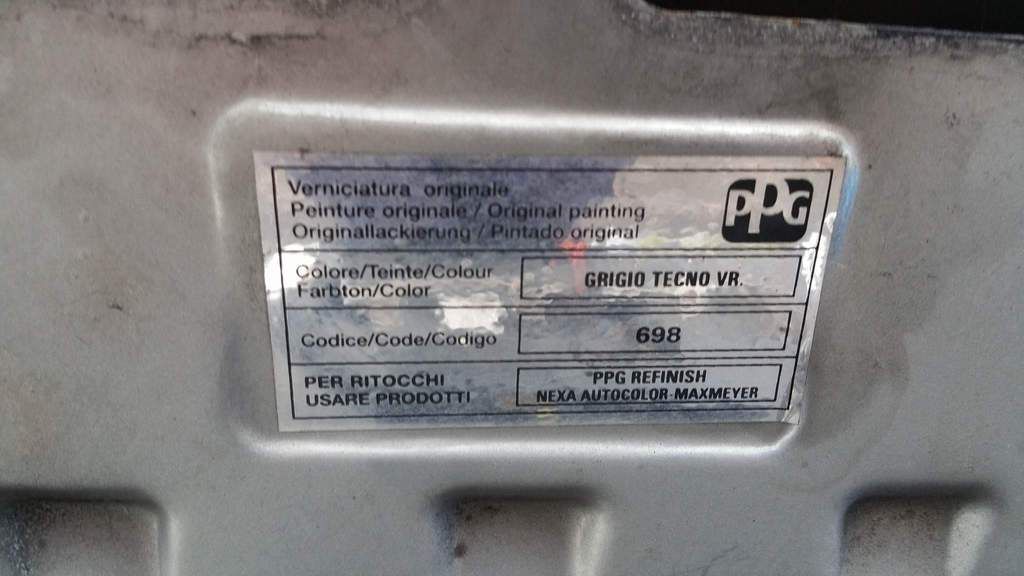

Coupedummy. Can you get some pics of the stilo's that your friend is breaking? I'm seriously in need of some bits too, curious as to what colour the abarth is (colour code) mines Grigio steel 697 (I think)...
A couple of quick pics but if interested drop me a pm and will give contact details.
I've dibs the blades.lol
Now that is a fine looking stilo - pitty about the colour code tho, double checked mine and its 647 grigio steel :(

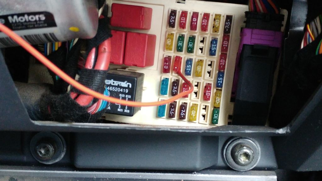

I am thinking of adding another lighter socket just above the fuse board to the right of the steering wheel. Has anyone connected directly to the fuseboard. I havent checked for spare ways but location seems ideal.
You can buy a piggy back fuse holder, you would simply remove the fuse for cigar lighter, put in the holder into the fuse socket and then your fused into the holder, the holder will have an extra feed coming off it, all you need to do is hook up your second cigar socket and ground it.
Make sure fuses are correctly rated for the amount of juice you need from the feeds.
Hi dt,
That's great thank you. Just what I am after to be honest. Will be perfect for an ignition live.
Saw this on a breaker..that's certainly one way to make a fire.

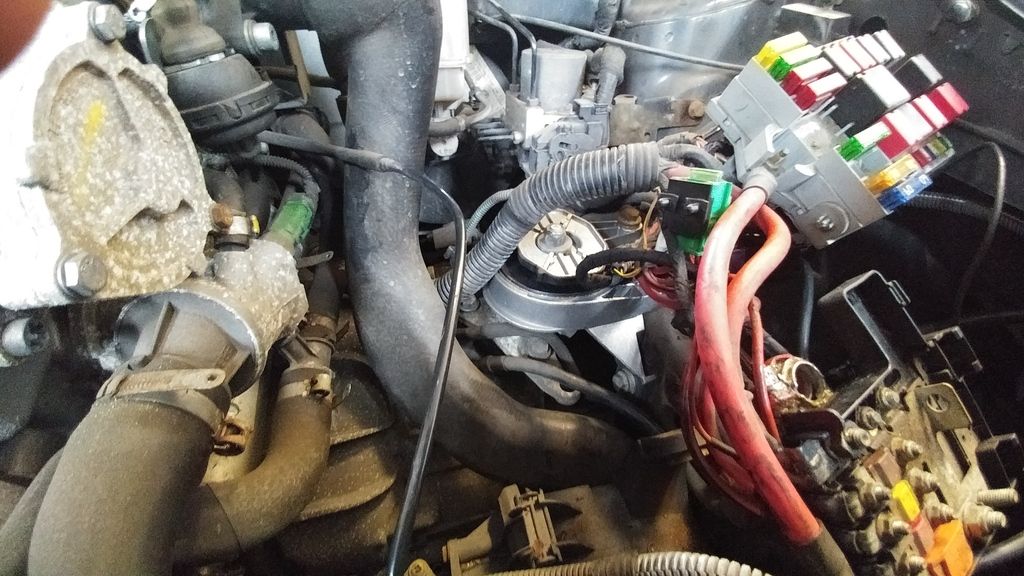

Cambelt and water pump fitted- all good
Drive belt installed- found incorrect belt fitted prior giving slight belt squeal on gear change and low revs. No ac belt was fitted. Now correct.

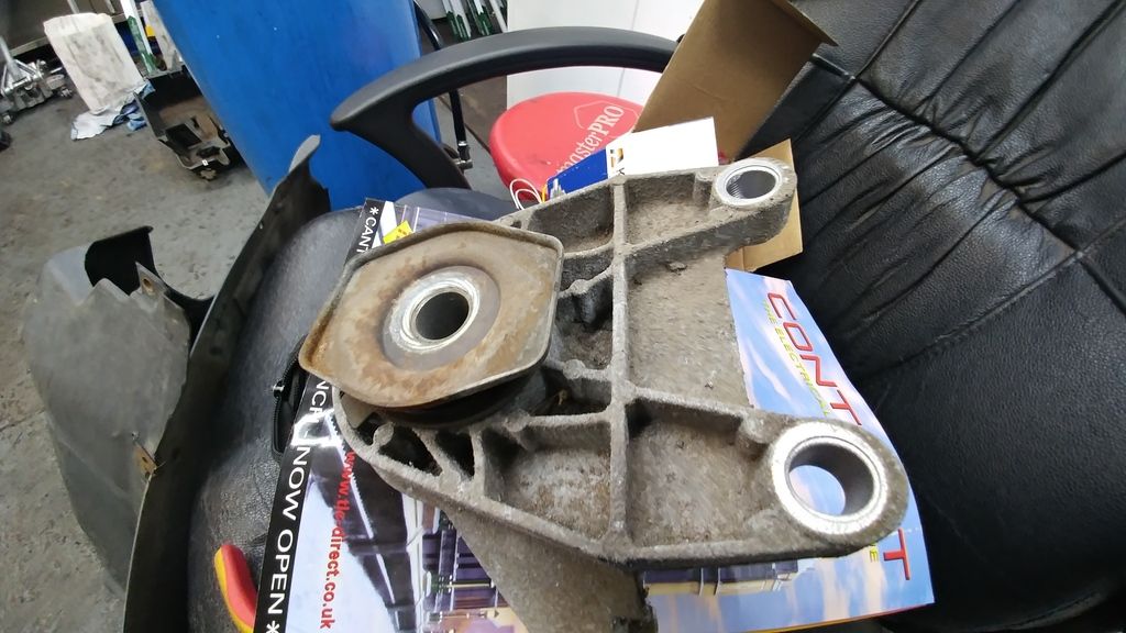

Gearbox mount fitted- slight improvement still vibration?
Found loose drop link causing knocking.- had new so replaced and all great now. No knocks.

Jees man, who did that bodge up! Defoe one way to cause a bad fire, there are much safer methods and more professional methods that would take a couple of mins to implement, you could also tap into the stereo positive or the ignition positive with scotch clips and a spare in line fuse... few mins work and will be safer that the above!! You could even snip the acc ignition wire and fit a bullet connector to it with one end double ended and then place your fuse in line on a bullet connector to the spare acc bullet female connector, I'll try find a pic, I used this method once before and all was fine and could be put back to normal in a min or so.
