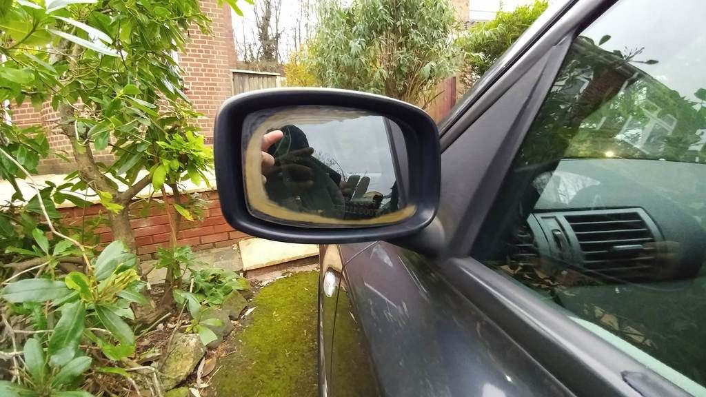

New wing mirror glass required both sides- ordered.

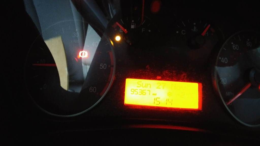

Temp gauge says red hot whether hot or cold...doesnt overheat or anything sinister so maybe sensor or wiring? Suggestions? Is the sensor located in the thermostat block?

I would say the temperature gauge is probably a fault with the instrument cluster.
When I got my Abarth the garage reported that the gauge did the same but the car was reading the temperature just fine - so the instrument panel was reporting it wrong. Eventually the instrument panel died in it's entirity and had to get it repaired.
A replacement will be easy enough to source via eBay i'd have thought anyway if that is cheaper than cost of repair. I didnt have a lot of choice but to repair as low mileage Abarth clusters just don't come up on eBay. I have a 'spare' JTD instrument cluster in the shed that my car ran on for a while whilst other was out for repair. I'm selling my Abarth wanting a JTD so i'd prefer to keep hold of it but if you get stuck let me know. If you have another JTD already it wouldn't be a difficult job to swap the clusters over to perform a quick test! If you're anywhere near Grimsby, North East Lincs I don't mind helping.
You'll know very easily if the car thinks it's red hot because the cooling fans will kick in straight away when you turn her on, even when stone cold. If the cooling fans don't kick in pretty quickly you can be fairly sure the car is reading the right temperature - the dash is just not displaying it.
If you unplug the temp sender - which is as your correctly say in the thermostat - the fans should kick in I think as like a fail safe. So you can test the fan functionality that way. Fiat / MultiECUScan also has an actuator test for fans.

Took the stilo out to screwfix and weirdly the outside temp was reading pretty accurate. I will clean all I see I reckon and find the connectors.
Car runs great, no temp issues at all. I do have access to a spare jtd cluster and Abarth one actually so may give them a try. The temp gauge actually changed temp on startup today which is weird. I will be concerned if the light is illuminated I think as that signal is given out by the Ecu I believe?

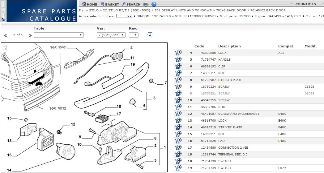

One further fault which occurred yesterday is the boot handle switch.
The boot would constantly pop open.
After alittle digging I found a split in the rubber and switch completely saturated.
Is the switch and rubber cover a separate replaceable item?
I now need to see how the glass part opens! Not a major concern if it doesn't mind.
The switch with rubber cover is available; item 19 in the diagram below. The one marked E579 is only for cars equipped with the "EasyGo" keyless entry system.

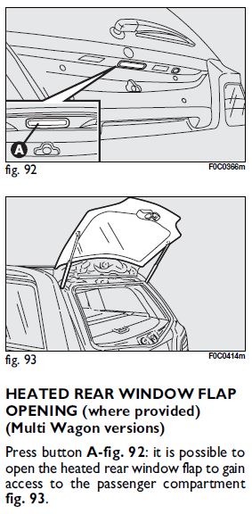

If the car has the separate opening tailgate window, there will be a rubber covered button under it, as shown in the diagram below.
You can also open the complete tailgate or the tailgate window with the boot lid button on the remote control. Press the button for more than 2 seconds to open the complete tailgate. Press the button twice within 2 seconds to open the tailgate window.
If either the tailgate or the window is already partially or completely open, the logic of the system will not allow you to open the other one. This is to prevent damage that could be caused by the window colliding with the roof spoiler if both were separately open at the same time.

Only had time for a quick mess today. Changed both wing mirror glass as the mirrored finished had burnt through as you can see above.

You can also see my temp gauge temp at cold! Another qwerk!
