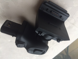

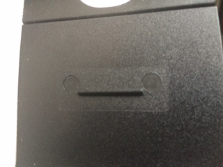

With plugs removed, there are 4 small Philips head screws to be unscrewed
image.jpeg,the two bottom screws are shown, the top ones are still behind their plugs

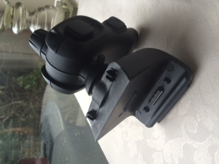

The sliding clamp then can be lifted off the springs by carefully sliding it upwards leaving the bracket looking like this (sorry is on its side, I can't see how to rotate the uploaded image)

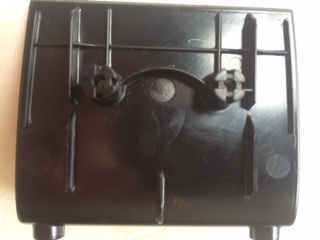

This is the rear of the bracket to which the front plate will be refastened with original screws and blanking plugs after I've fitted the magnet between the two screws on the front plate (sorry, now image is upside down) Will post more pics (hopefully right way up) when have received and fitted magnet. Hope this has been helpful.

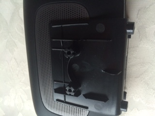

Fits in perfectly into semi circular plastic moulding in front plate without modification:
before:
Reassembled with a piece of scrap plastic to cover the gap at the top. Removing this enables the bracket to be restored to its original form.
