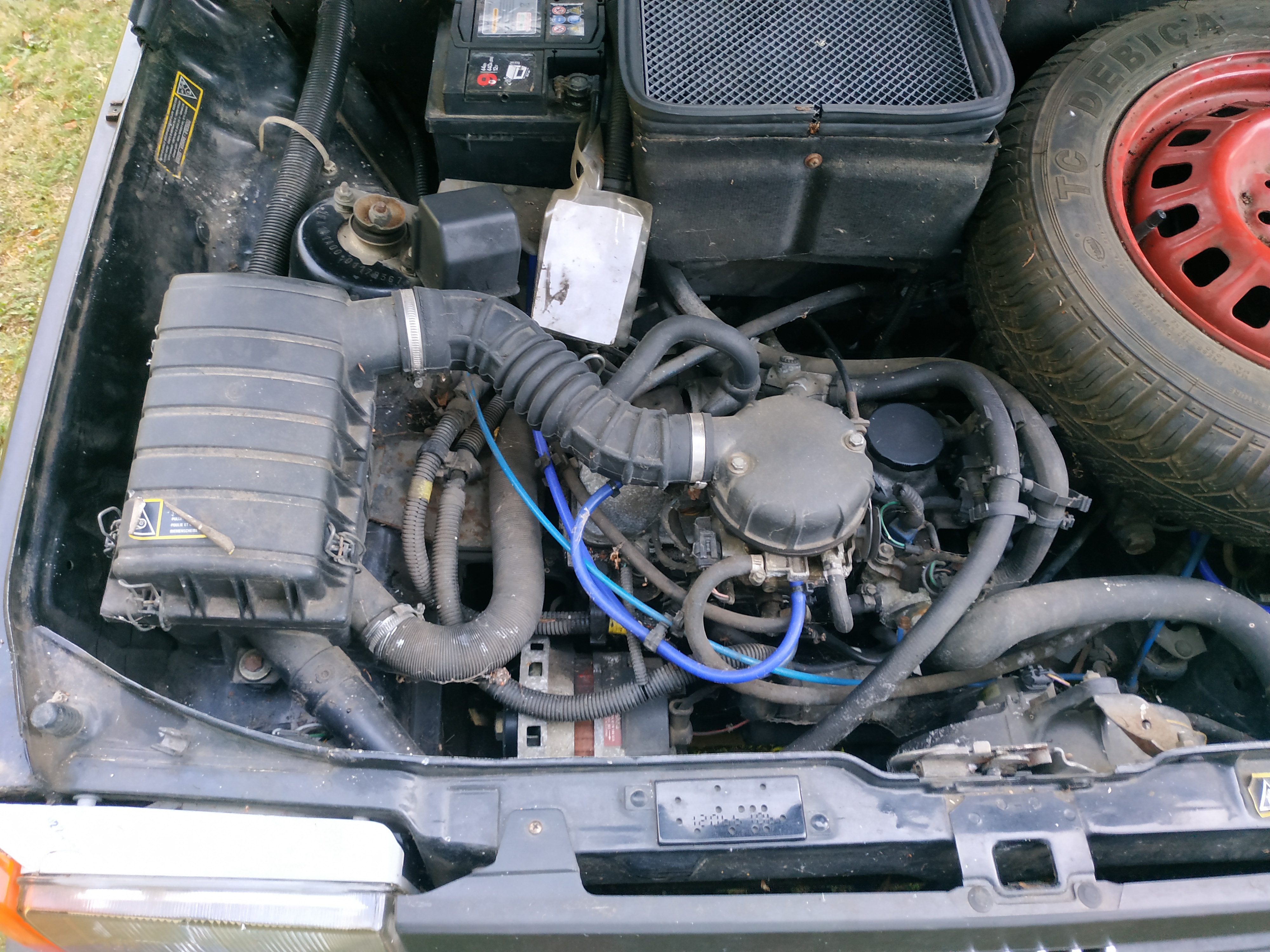

hey there, i am guessing your engine is the 899cc or 903cc OHV engine? at 1991 it may have the funny electronic carburettor. do you still have a choke but no distributor? (best way to tell) or if you can see the ECU, is it a Magneti Marelli brand name? it will have some numbers after the end like 8F or 5F if i remember right.
in any case look for vacuum leaks. split pipes in the engine bay will cause the MOT emissions test to fail.
feel free to post photos! we love to see pandas and under bonnet pictures.. well i do.
ive had both 903cc with electronic carburettor and 899cc with single point injection. if you post a photo up without the air filter removed i will be able to tell strait away and advise more.

Looks like a single point injection to me. I replaced any dodgy looking vaccuum pipes a while ago....some were completely shot and hanging off. Ball joints done with a bit of jiggery-pokery. Such a fun machine!

beautiful!! yes thats single point injection. usually its not a bad sensor that causes this, its the cat converter that has that much soot deposits that as exhaust gas flows through it, it never contacts the catalyst to convert the carbon monoxide into carbon dioxide. so one thing you can do to rejuvenate the cat converter is while the engine is running at a fast speed inject a fine mist of water into the engine air intake. not too much but just on the verge of causing the engine to bog down. the water hitting the cat effectively steam cleans it taking all of the built up soot deposits away from the catalyst. just be sure to put something under the exhaust at the back of the car to catch the water as it will be very black and stain whatever surface it falls on. you only have to do it for about 5 mins and thats it.
its what i had to do to get my 903cc with electronic carb through the MOT. after that it never had the issue again. i have done it on other cars with great successes too. worth trying ;)
the alternative is replacing the cat converter which is totally unnecessary as it can be cleaned as above.
if you have the engine management light on (the red injector light) that could be the lambda o2 sensor on the exhaust faulty. if not it is still fine.
i would have though that on yours being a 1991 it would only be a single wire o2 sensor? at max a 3 wire.
