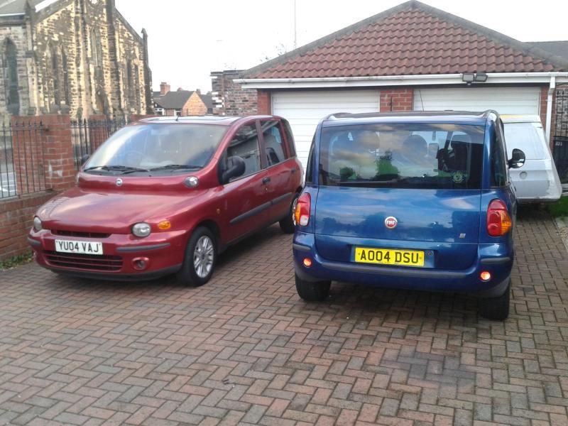

After the saga of the Multipla JTD that just didn't want to be fixed I finally got the family back on the road by buying another, identical Multipla (except it's red)
It's got it's share of dints but is generally in good shape with lots of receipts and history. It drives great and the engine starts, unlike the old one.
Anyway, the central locking unlocks on the key button but doesn't lock and has to be done manually. The alarm still works normally.
Any ideas on what the problem can be? I have a complete Multipla I can raid for parts!

I too went from a Blue one to the Red one :p
Mine doesn't have a, how shall I put it, 'unfortunate' registration though . . . :eek:
Yeah, I've checked the keys and replaced the battery. It unlocks fine and the alarm can be turned on and off, it just won't lock again by pressing the button in the key.
I mentioned the reg to the missus as we drive up to collect it, she wasn't very pleased but by then it was too late. If you squint it kinda says YOU A VAJ or something.
