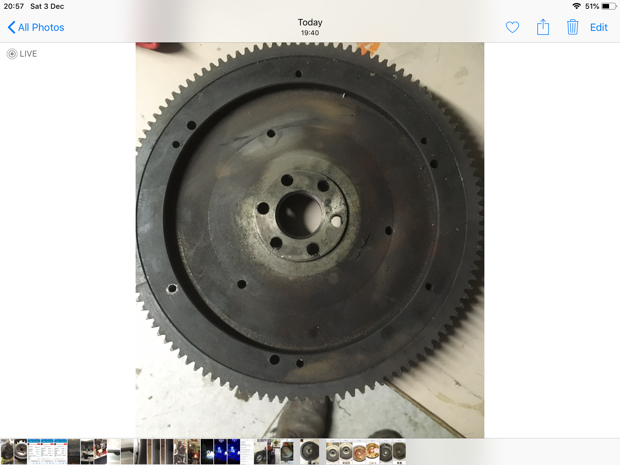

Hello I’m a new to forum retired now and doing a engine rebuild on a 903 which started off with just needing a clutch and sump leak anyways lots more needs replacement to be right I am struggling to obtain a fly wheel as mine is badly cracked can any one help thanks Chris all the fiat guys I knew have got too old for this lark

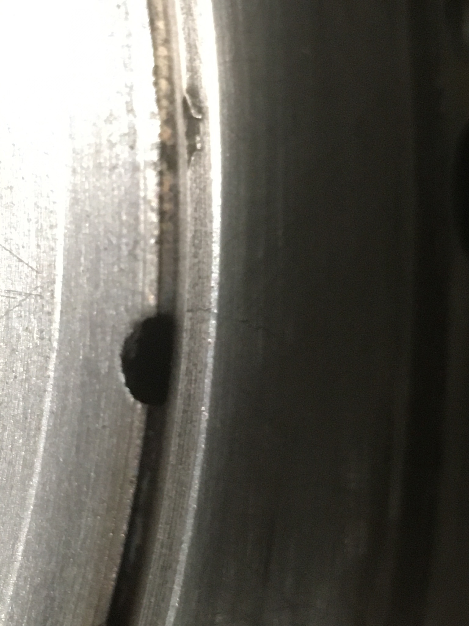

what makes yopu think its cracked ?
Beter quality photos would be required to estatblish that.
Looks like cast iron imperfection ...
Have added yes it’s right through on friction surface not just a heat crack ,the clutch is completely blued and scored by excessive slipping, if was a few thou it could have been skimmed, hopefully one will turn up

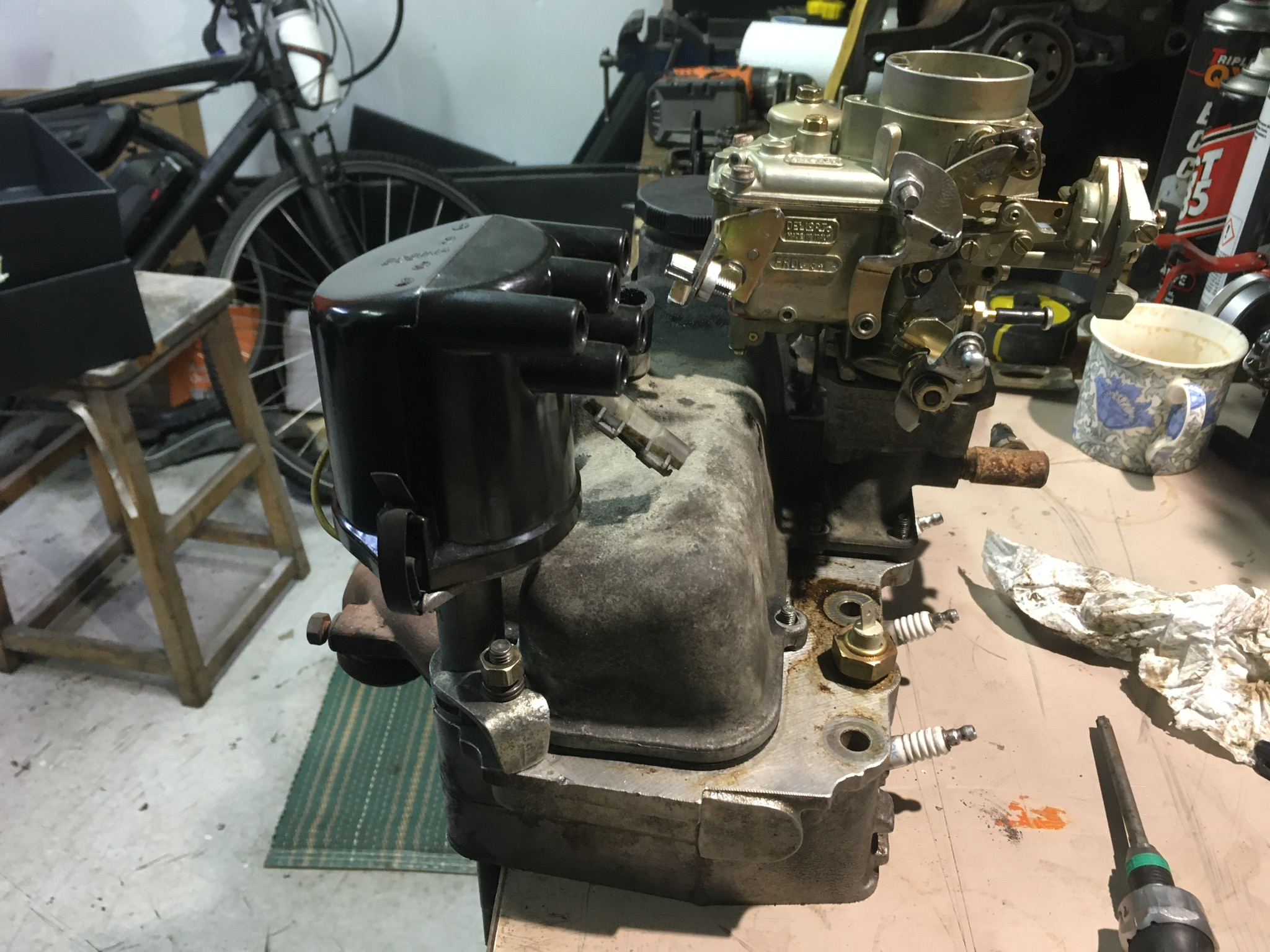

Thanks that’s very useful info I have opportunity to buy sx engine complete obviously I have the old stool dizzy and carb so maybe put my head on as it’s all done new valves skim and ready just the spark issue
Thanks for all your help never considered the 899 as stuck in the old scene but it’s coming along nicely with my 850 sport head and dizzy to rid all the electronics
