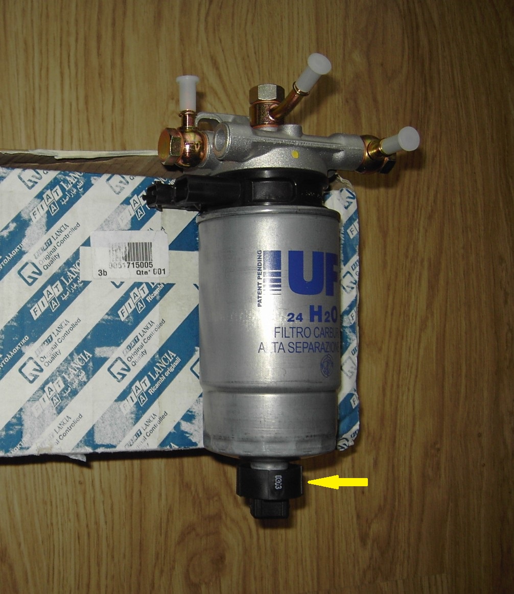

Like this one;

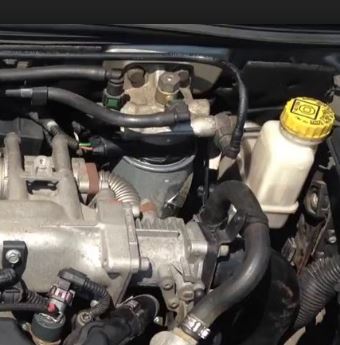

Did you unscrew the plastic knob on the bottom of the filter? Or is the drain screw (as distinct from the drain itself) on the top/somewhere else?
My filter doesn't look 100% like the picture. It only has the plastic knob on the bottom.. (there are otherwise 3 pipes connected to the top housing that can't be related to the drain and a big metal union nut).
Ralf S.
Yours has the water sensor (if fitted) or drain cap on the bottom of the filter. Picture below shows the water sensor; the drain cap is usually white.

That's the beast. :)
I have a service coming up in the next couple of months, so I'll change my filter (it'll have 46k on it by then.. :D ) and then I'll be able to figure out exactly how it works with it off the car. It'll be interesting to see how much water actually comes out.
