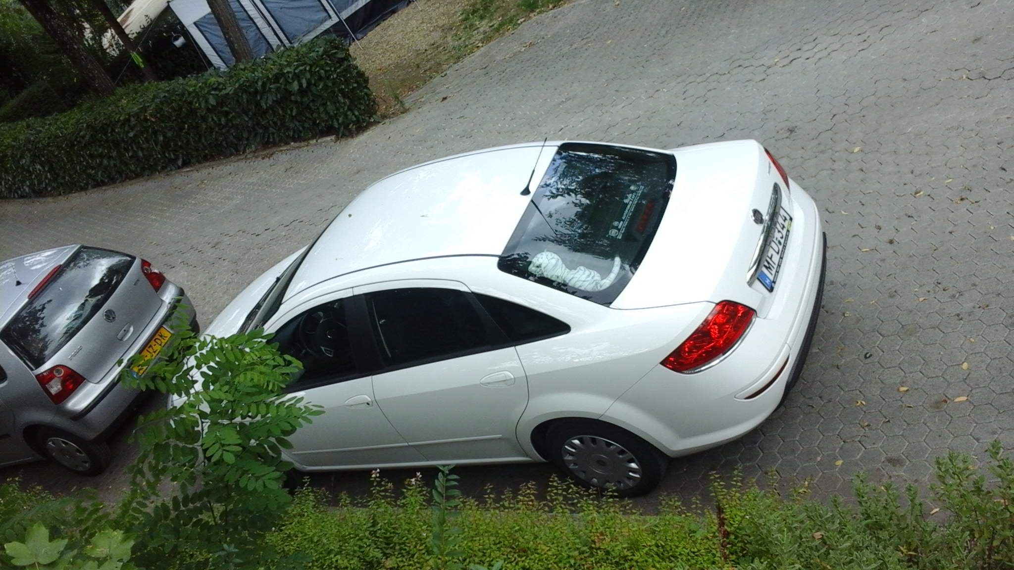

I'm from Belgrade
I've got Tipo for 3 months (08.07.2016).
Nice looking little car, could be tempted if we ever need a small five door hatch in the future. (I'm sure I saw one with a boot too but I could be wrong)
like it..!!
