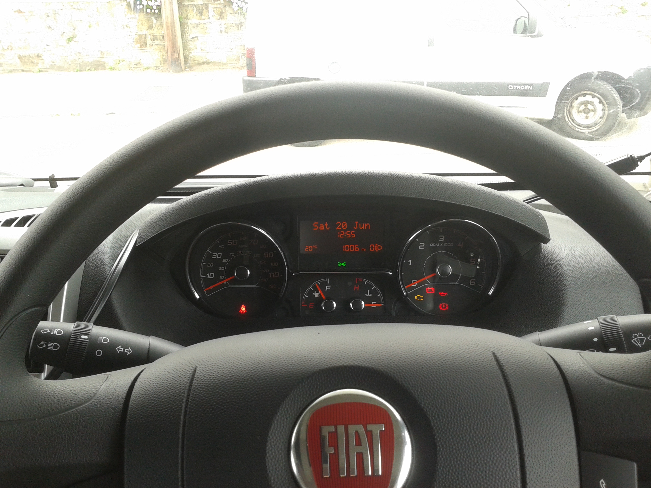

I am still having difficulty actually seeing the instruments in day light (particularly the speedometer) as the new model's cowls seems to create almost total shade! It is impossible to make out the KPH as those letters are smaller.

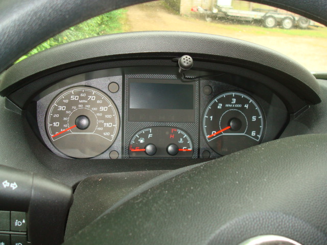

The combination of concentrating on driving and shading of the speedometer makes any chance of reading the smaller numbers impossible! Re: images the left one is the new "improved" one and the right one is the older clear one!!!
I am wondering if it would be possible to remove the perspex window in front of the instruments (complete with the cowls) and replace it with an old style 2006 onwards clear perspex one with no cowls??
Any ideas please for a permanent solution that does not involve using a sat nav would be great.

I have the same fault with my 4 day old Motorhome and I will be contacting fiat as it is obviously not a one off situation so will post their reply later.
looks like they are pointing away from your vision as if the cowls should have been mounted in the opposite side if you see what I mean.

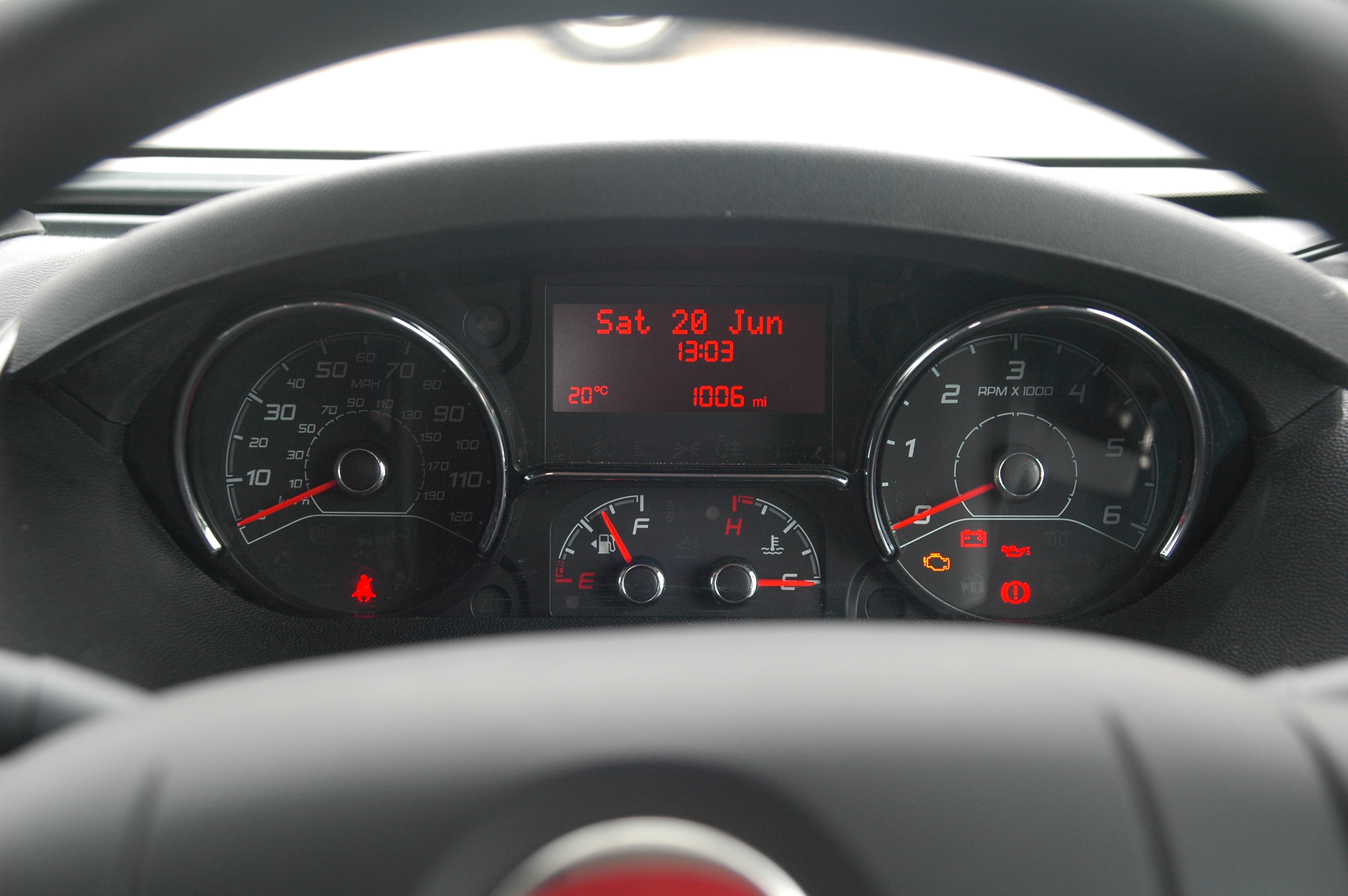

If you contact VOSA they ask for photographs of the part concerned.
I noticed on one of your blogs that you show an excellent photo of the instrument cluster which shows the shadowing effect quite well. This would give them some indication of the problem. I have tried to take a photo of my dash, but it comes out showing the speedo as being clear as a bell so I can't submit one.
I already have! Have you tried turning the flash off?
