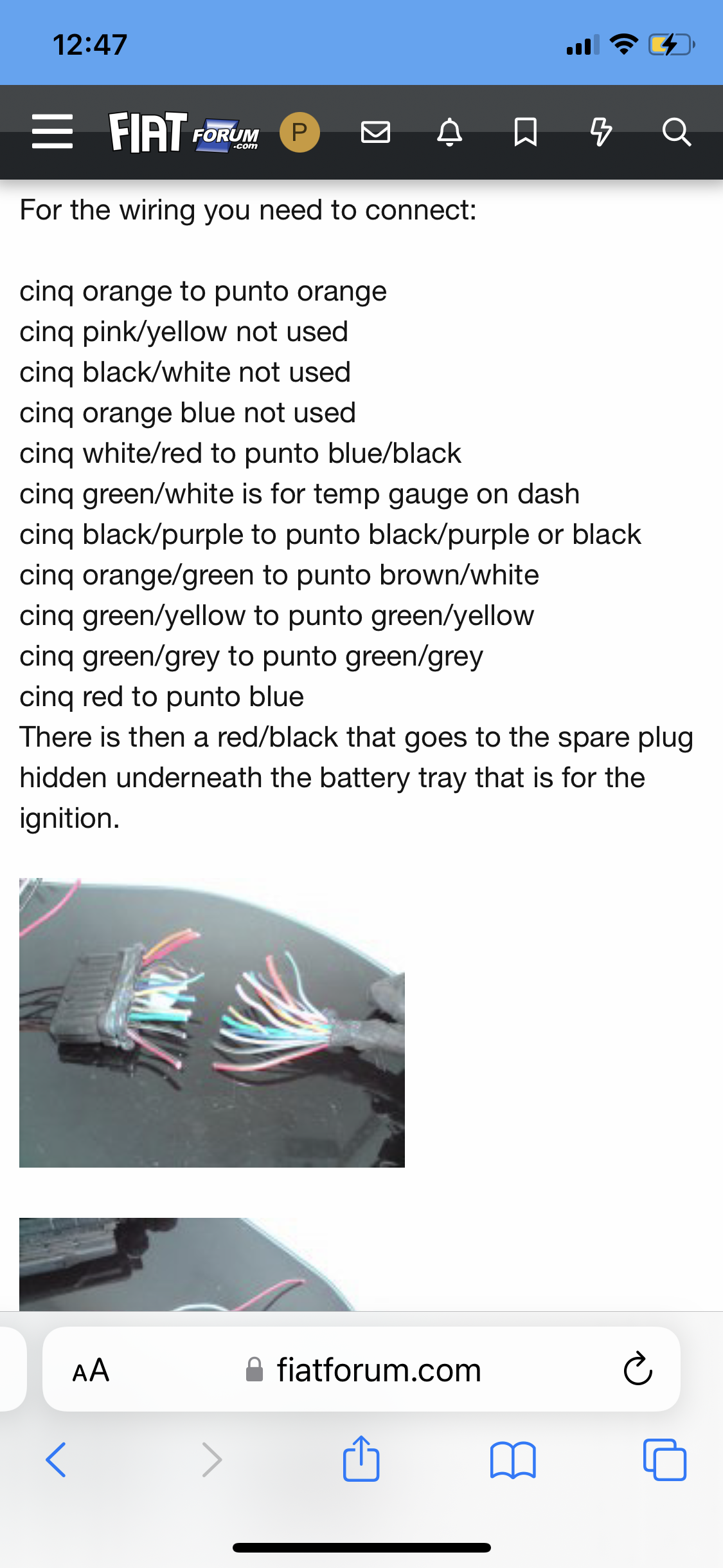

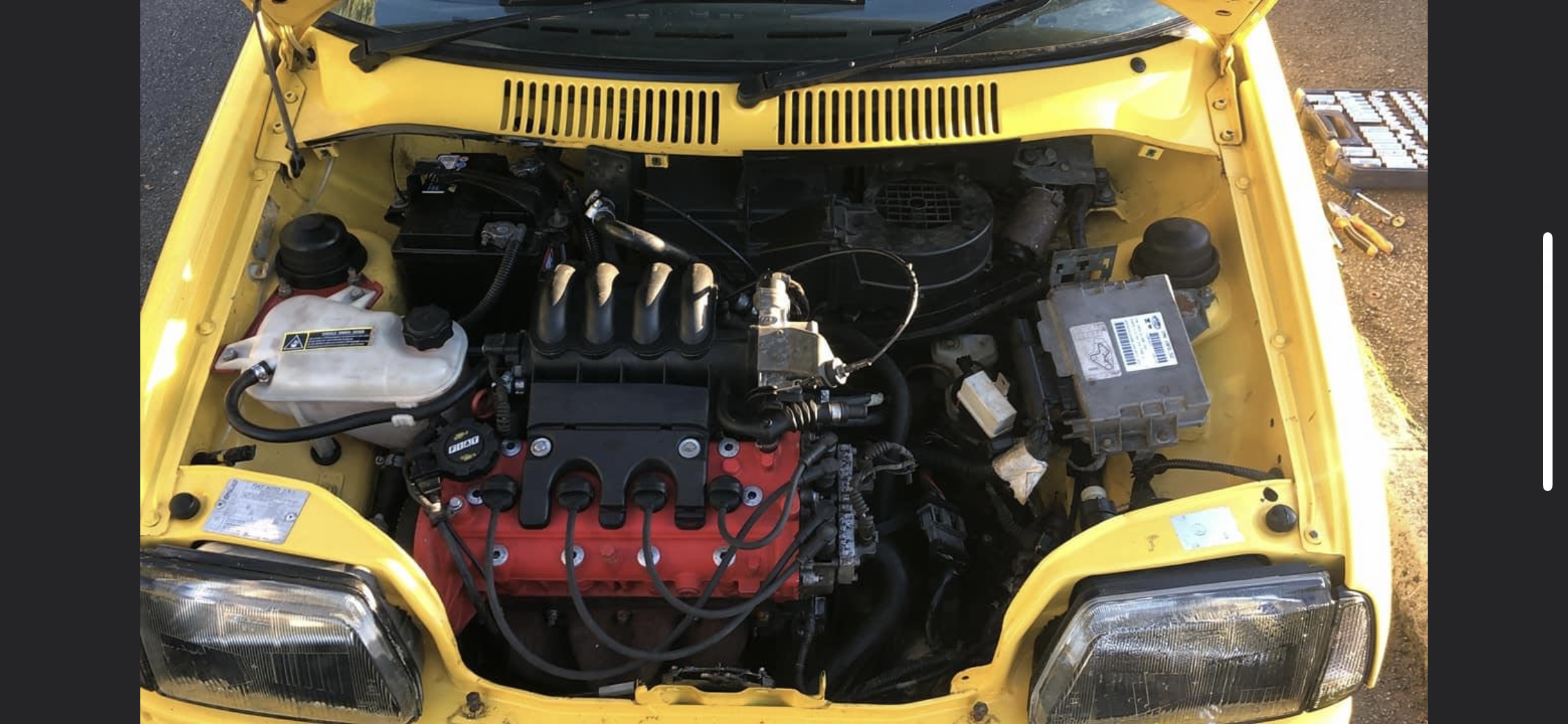

Really struggling with wiring mine up mate tbh I’ve not long done a 172 into r5 so ain’t too shoddy on spanner’s
I’ve wired this d4 connection up about 6 ways not once have I heard pump or seen spark 😩😩
Now I’ve had immob removed I’ve still got code light
Had it 3 weeks now and just going backwards if honest I’m happy to pay for someone who’s done these I could tell someone over the phone or email how to do an f4r but there’s so many conflicting diagrams for these most wires match for gauges/dials the rest mine don’t match anything
I’ve got cinq wiring on chassis side kind of fully beep tested
The punto side all gauges id ok ,
White relay is live off battery
Immob been away to have immob removed but still saying code 🤦‍♂️🤷‍♂️ Cinq key and cinq box under dash still
My car don’t have any spare plugs under battery tray off cinq side 🤦‍♂️🤦‍♂️
Just about ready weigh it in and cut losses 😩😩😩

Motor is 1.2 16v from a mk1 punto
Engine harness and ecu also from mk1 punto
I have the punto key and reader box but also paid for ecu to have immob removed thinking it would make job easier but no such luck lol

I’ve wired the car up like this pic although my car don’t have a spare bullet connector under the battery tray only 2 that are both plugged in already so sent power to punto red/black at d4 live off battery
White Relay and tps seem to be getting power
Unsure what to do with both black/purple at the d4 plugs some say join some show punto side being earthed
Purple/black on cinq side seems to be pulsing earth when power is at white relay and solid continuity when power is off the relay 🤷‍♂️
I can beep test from fuel pump plug to cinq d4 plug
I’ve got all dash lights on ok injection light comes on and goes off
Battery light , oil pressure and code all appear I’m still running the cinq key reader box with ecu immob removed (notsure if can just unplug) now it’s immob deleted
