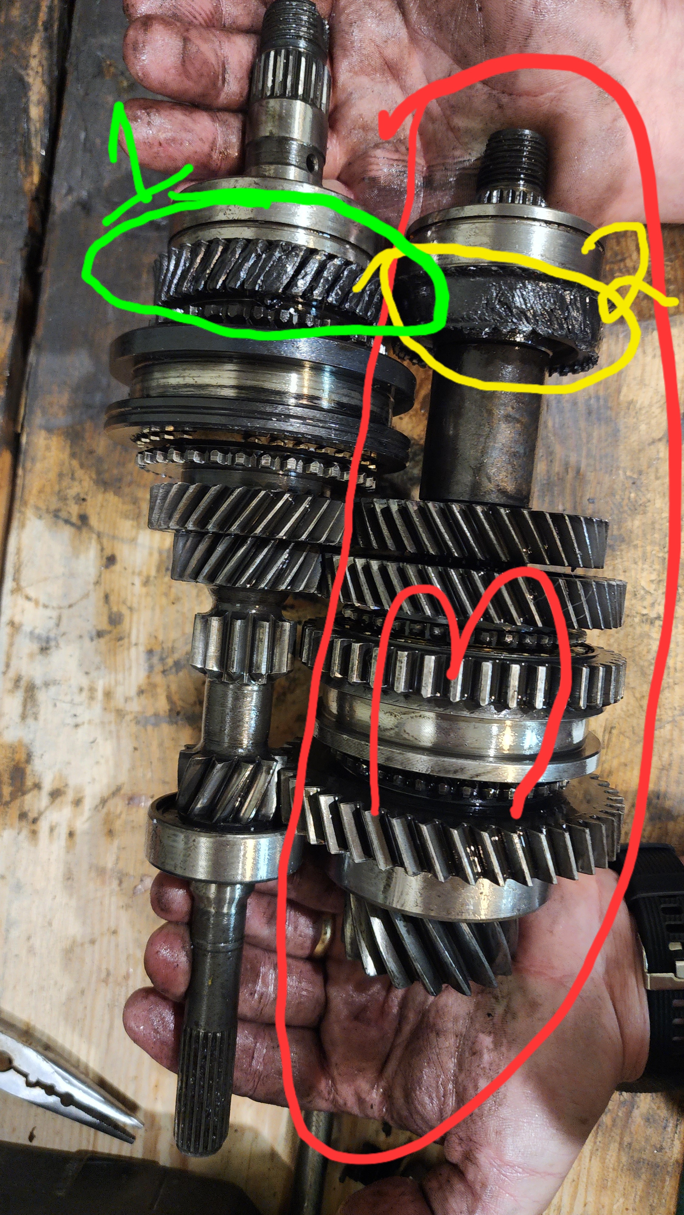

2013 Fiat 500c. 1.4L "D" is the 7th digit in the VIN. So I opened up the transmission and found a ground up 4th gear (#1 in the picture). I can find and order that, no problem. However on the secondary shaft (#3 in the pictures) I cannot figure out what #2 (in the pictures) is. It is in dire need of replacing. But I can't find any diagrams/ schematics that lists that shaft and its components at all. Can anyone point me in the right direction?
2013 Fiat 500c. 1.4L "D" is the 7th digit in the VIN. So I opened up the transmission and found a ground up 4th gear (#1 in the picture). I can find and order that, no problem. However on the secondary shaft (#3 in the pictures) I cannot figure out what #2 (in the pictures) is. It is in dire need of replacing. But I can't find any diagrams/ schematics that lists that shaft and its components at all. Can anyone point me in the right direction?View attachment 426166

Hi
I dont have a straight answer..
The Mexico built 500 uses parts that Europe didnt..
You have a 1.4 turbo multiair..our 500 didnt get that much power ( it was lighter by @200kg)
However..it is probably still from the parts catalog
Any idea what series gearbox this is ?
C513 is a common example...
So code may be similar :)
We are a UK based forum so only see traffic around these from Canada and the US...
BUT if we recognise the g.box series.. may have links from the @15 Euro models we do see (y)
