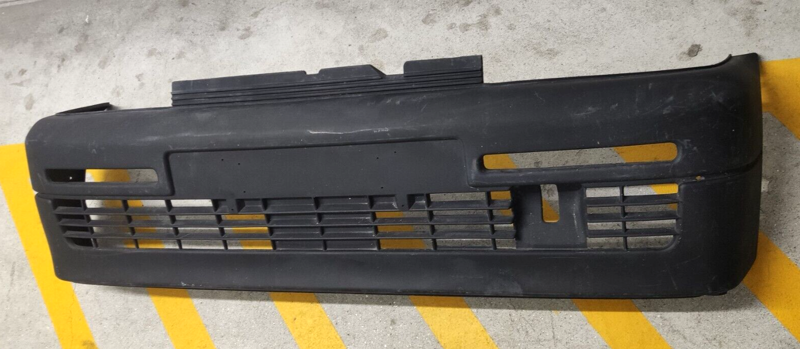

So basically 2023 has a year where I found some pieces not so easy to find, as:
An NOS bumper for Sporting version with air conditioned:
