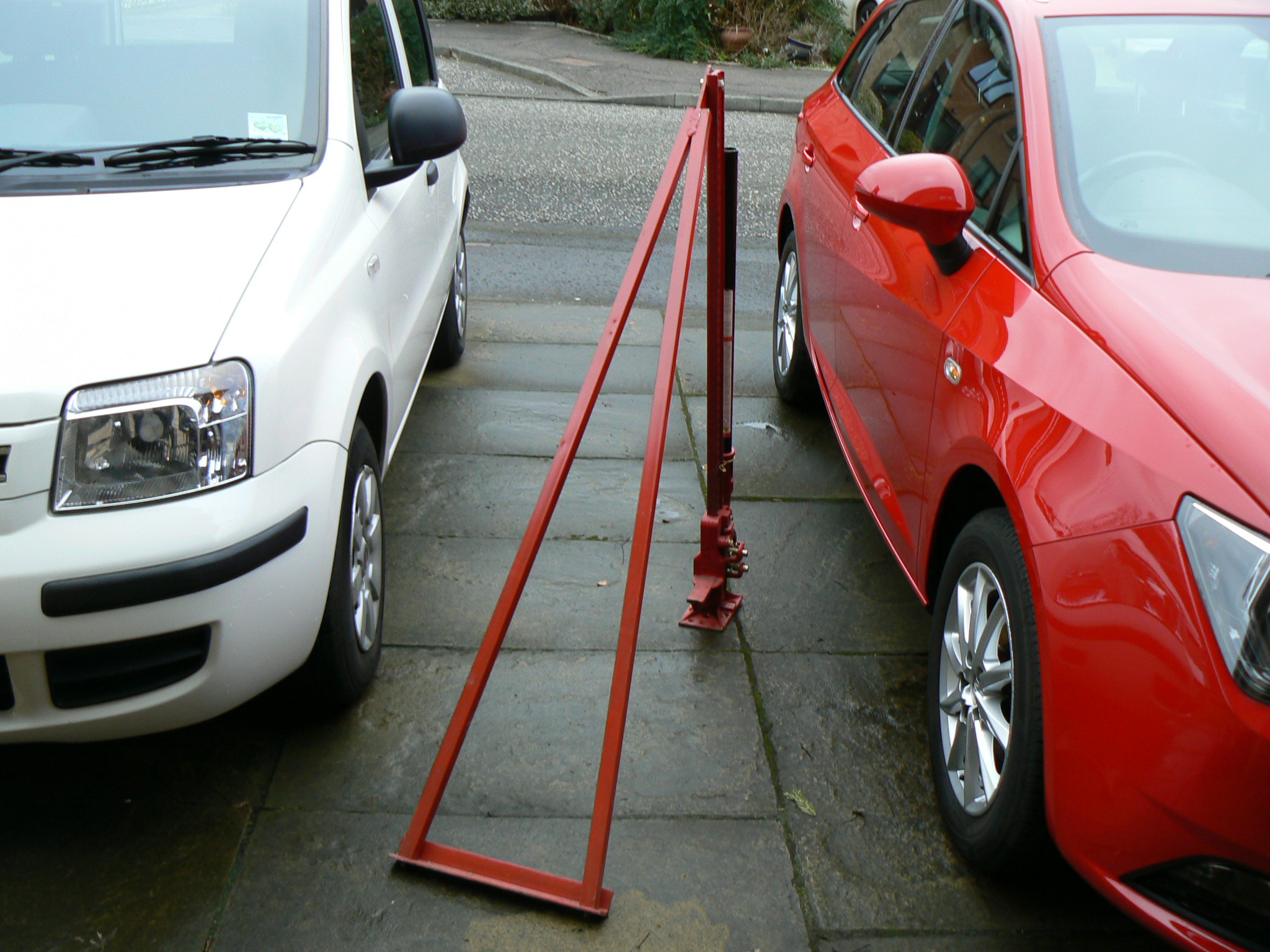

An "A" frame for my Hi Lift jack.
Makes it easier pulling fence posts and uprooting shrubs which it does in just minutes
